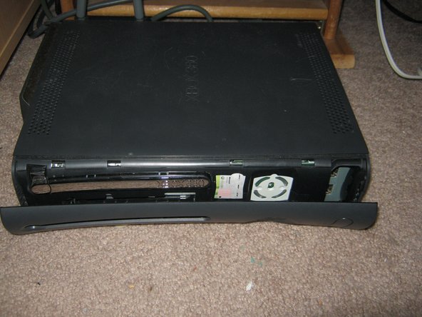

    • Remove the faceplate from the system. Grab a part of the faceplate, and it should come off.
  2. OBSOLETE - How to Remove a stuck game from an Xbox 360, Find the emergency eject hole: crwdns2935265:02crwdnd2935265:01crwdnd2935265:01crwdne2935265:0
    • With the faceplate off of the 360, find a small hole on the front of the 360 without the faceplate and stick a paperclip in the hole. This will be found under the X relative to the faceplate on the system.
    • The system in the guide does not have this hole. In this example, opening the console is likely the only way to get your game out if the optical drive does not respond.

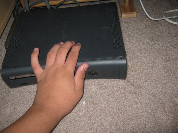

  3. OBSOLETE - How to Remove a stuck game from an Xbox 360, Replace the faceplate: crwdns2935265:03crwdnd2935265:01crwdnd2935265:03crwdne2935265:0 OBSOLETE - How to Remove a stuck game from an Xbox 360, Replace the faceplate: crwdns2935265:03crwdnd2935265:02crwdnd2935265:03crwdne2935265:0 OBSOLETE - How to Remove a stuck game from an Xbox 360, Replace the faceplate: crwdns2935265:03crwdnd2935265:03crwdnd2935265:03crwdne2935265:0
    • Reinstall the faceplate on the system. To do this, put even pressure on all parts of the faceplate until it is completely flush with the console.
    • If you are in doubt, it may not hurt to run your hand over the faceplate to make sure and do a visual inspection.
