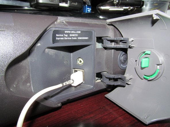

  1. OBSOLETE - Battery Bulge Inspection, Check for power on a iPod dock: crwdns2935265:01crwdnd2935265:01crwdnd2935265:02crwdne2935265:0 OBSOLETE - Battery Bulge Inspection, Check for power on a iPod dock: crwdns2935265:01crwdnd2935265:02crwdnd2935265:02crwdne2935265:0
    • Plug the iPhone into a compatible iPod dock or charger with 30-pin cable. If you do not find the phone turns on in a reasonable amount of time, you may want to supervise the phone. If the phone still has problems, further inspection is required.
    • If your phone feels "bubbled", the battery may explode. Stop the tests and replace the battery. Continuing beyond this point runs the risk of the phone exploding.

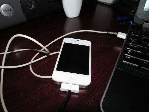

  3. OBSOLETE - Battery Bulge Inspection, Check with a computer: crwdns2935265:03crwdnd2935265:01crwdnd2935265:03crwdne2935265:0 OBSOLETE - Battery Bulge Inspection, Check with a computer: crwdns2935265:03crwdnd2935265:02crwdnd2935265:03crwdne2935265:0 OBSOLETE - Battery Bulge Inspection, Check with a computer: crwdns2935265:03crwdnd2935265:03crwdnd2935265:03crwdne2935265:0
    • Plug the phone into a computer and see how it responds. If the phone works on a computer but not a charger the battery is shot. At this point, it's a matter of checking if the phone has a bulged battery or not.

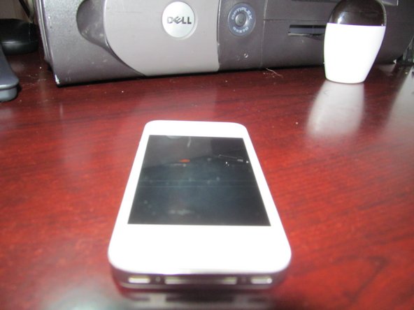

  4. OBSOLETE - Battery Bulge Inspection, The table test: crwdns2935265:04crwdnd2935265:01crwdnd2935265:02crwdne2935265:0 OBSOLETE - Battery Bulge Inspection, The table test: crwdns2935265:04crwdnd2935265:02crwdnd2935265:02crwdne2935265:0
    • Put the phone on a flat table. Check if the display has a bump. If the display has a bump, it's safe to assume you may need a new battery. The battery is on the right side of the phone, so focus on this side of the phone. You may not notice this if you do not know what to look for. You need a keen eye to notice this unless it is obvious.
    • If you still are not sure, spin the phone on a table to see how bulged it is. If the phone spins without stopping quickly, the battery is bulged. Light bulges may cause the phone to be unstable, but it is not as likely to spin or show as a bulge on the LCD.
    • Put the phone on a table and see if it spins. If it does, the battery is bulged.
    • It will not spin in every single case of a bulge, but larger bulges will spin.
