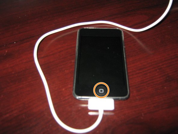

  3. OBSOLETE - *Pre iPhone 7/7th Gen Touch* How to access Recovery Mode, Reset the device: crwdns2935265:03crwdnd2935265:01crwdnd2935265:02crwdne2935265:0 OBSOLETE - *Pre iPhone 7/7th Gen Touch* How to access Recovery Mode, Reset the device: crwdns2935265:03crwdnd2935265:02crwdnd2935265:02crwdne2935265:0
    • Reset the device. Hold both the power and home buttons down at the same time. Do this until the device screen turns black.
    • This is the power button.
    • This is the home button.

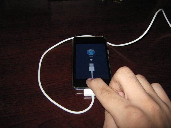

  4. OBSOLETE - *Pre iPhone 7/7th Gen Touch* How to access Recovery Mode, Put the device in recovery mode: crwdns2935265:04crwdnd2935265:01crwdnd2935265:02crwdne2935265:0 OBSOLETE - *Pre iPhone 7/7th Gen Touch* How to access Recovery Mode, Put the device in recovery mode: crwdns2935265:04crwdnd2935265:02crwdnd2935265:02crwdne2935265:0
    • This screen may vary based on the version of iOS and device model. Some show the iTunes icon, while others show a computer.
    • Once the Apple logo shows up on the screen, let go of the power button. Hold the home button until the recovery mode screen comes up.
