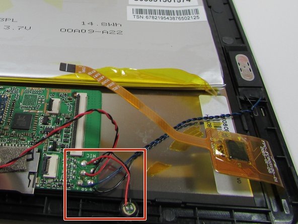

  5. NuVision TM800A510L Screen Replacement: crwdns2935265:05crwdnd2935265:01crwdnd2935265:02crwdne2935265:0 NuVision TM800A510L Screen Replacement: crwdns2935265:05crwdnd2935265:02crwdnd2935265:02crwdne2935265:0
    • If you have not done so already, de-solder the boards from the device.
    • De-soldering the wires right now makes sure none of the wires are damaged or broken when we move the components.
