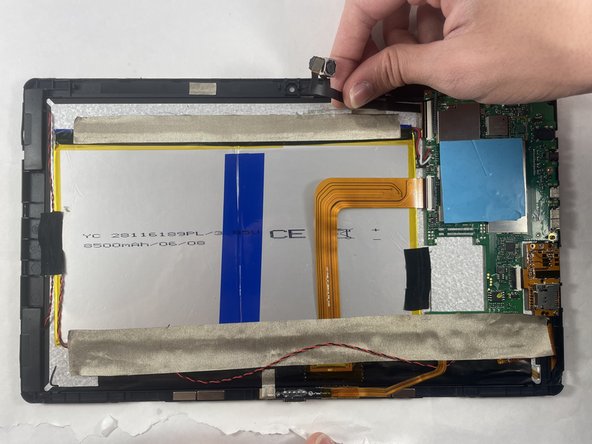

  2. NuVision Duo 11 Camera Replacement, Camera: crwdns2935265:02crwdnd2935265:01crwdnd2935265:02crwdne2935265:0 NuVision Duo 11 Camera Replacement, Camera: crwdns2935265:02crwdnd2935265:02crwdnd2935265:02crwdne2935265:0
    • Disconnect the ribbon cable from its retaining flap.

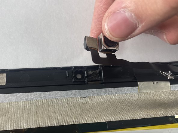

  3. NuVision Duo 11 Camera Replacement: crwdns2935265:03crwdnd2935265:01crwdnd2935265:03crwdne2935265:0 NuVision Duo 11 Camera Replacement: crwdns2935265:03crwdnd2935265:02crwdnd2935265:03crwdne2935265:0 NuVision Duo 11 Camera Replacement: crwdns2935265:03crwdnd2935265:03crwdnd2935265:03crwdne2935265:0
    • Lift the camera out of the tablet.
    • The camera may be glued into place, so use caution when removing it.
