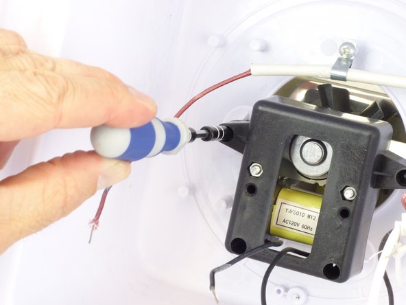

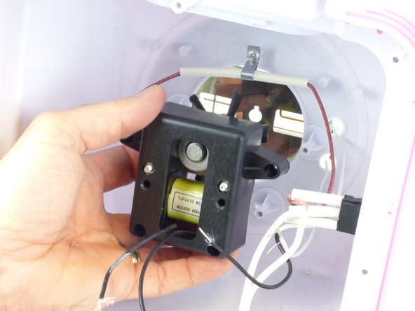

  5. Nostalgia Electrics PCM805 Motor Replacement, Motor: crwdns2935265:05crwdnd2935265:01crwdnd2935265:02crwdne2935265:0 Nostalgia Electrics PCM805 Motor Replacement, Motor: crwdns2935265:05crwdnd2935265:02crwdnd2935265:02crwdne2935265:0
    • Remove the four 12mm Phillips #02 screws to free the motor housing.
  6. Nostalgia Electrics PCM805 Motor Replacement: crwdns2935265:06crwdnd2935265:01crwdnd2935265:02crwdne2935265:0 Nostalgia Electrics PCM805 Motor Replacement: crwdns2935265:06crwdnd2935265:02crwdnd2935265:02crwdne2935265:0
    • Line up the prongs on the motor shaft with the holes in the heating element and pull the motor out.
