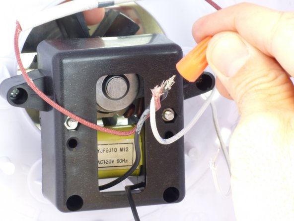

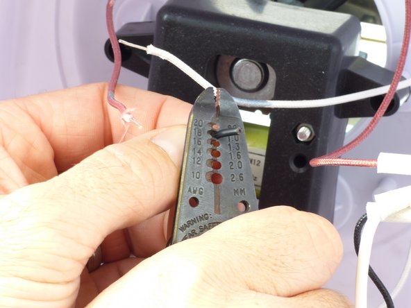

  3. How to rewire a Nostalgia Electrics PCM805, How to rewire a Nostalgia Electrics PCM805: crwdns2935265:03crwdnd2935265:01crwdnd2935265:02crwdne2935265:0 How to rewire a Nostalgia Electrics PCM805, How to rewire a Nostalgia Electrics PCM805: crwdns2935265:03crwdnd2935265:02crwdnd2935265:02crwdne2935265:0
    • Using the wire stripper, remove 1/2 inch of the wire insulation at the end of each wire to expose the bare wire for re-connection.

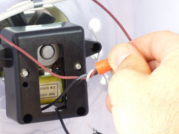

  4. How to rewire a Nostalgia Electrics PCM805: crwdns2935265:04crwdnd2935265:01crwdnd2935265:03crwdne2935265:0 How to rewire a Nostalgia Electrics PCM805: crwdns2935265:04crwdnd2935265:02crwdnd2935265:03crwdne2935265:0 How to rewire a Nostalgia Electrics PCM805: crwdns2935265:04crwdnd2935265:03crwdnd2935265:03crwdne2935265:0
    • Twist the exposed ends of the wires so that they stay together.
    • Push the wire cap onto the exposed ends while holding the wires and twist in a clock-wise direction until it is tight.
    • Repeat this process for both bundles of wires.
    • Do not attempt to power on the device without the wire caps on or mix wires between the bundles.
