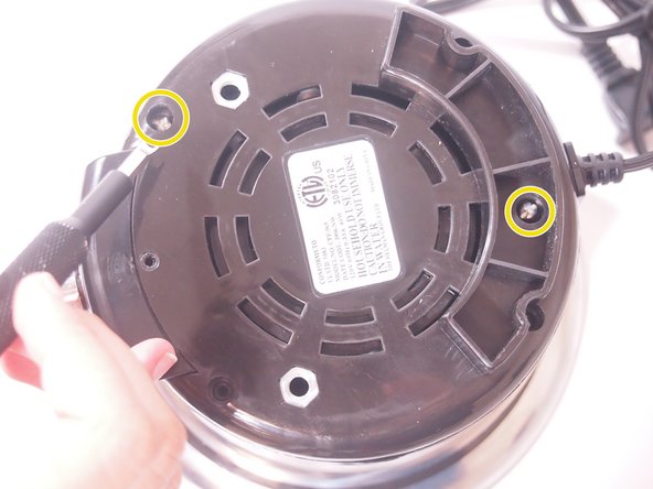

  3. Nostalgia Chocolate Fondue Fountain CFF965 Baseplate and Switch Replacement, Baseplate and Switch: crwdns2935265:03crwdnd2935265:01crwdnd2935265:01crwdne2935265:0
    • Flip over the device so that the bowl is now face down.
    • Use your hands to unscrew both 21.3mm screws.

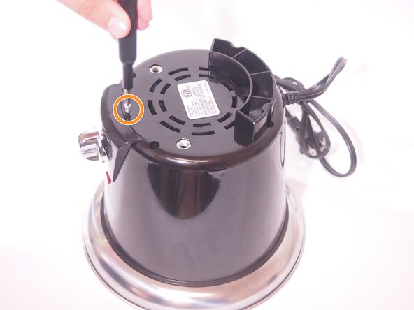

  4. Nostalgia Chocolate Fondue Fountain CFF965 Baseplate and Switch Replacement: crwdns2935265:04crwdnd2935265:01crwdnd2935265:03crwdne2935265:0 Nostalgia Chocolate Fondue Fountain CFF965 Baseplate and Switch Replacement: crwdns2935265:04crwdnd2935265:02crwdnd2935265:03crwdne2935265:0 Nostalgia Chocolate Fondue Fountain CFF965 Baseplate and Switch Replacement: crwdns2935265:04crwdnd2935265:03crwdnd2935265:03crwdne2935265:0
    • Unscrew all three 14.2 mm screws with a Phillips #2 screwdriver.
    • Unscrew the 9.1 mm screw near the switch with a Phillips #2 screwdriver.
    • Unscrew the two 14.2 mm spanner screws using a spanner screwdriver (size 6).

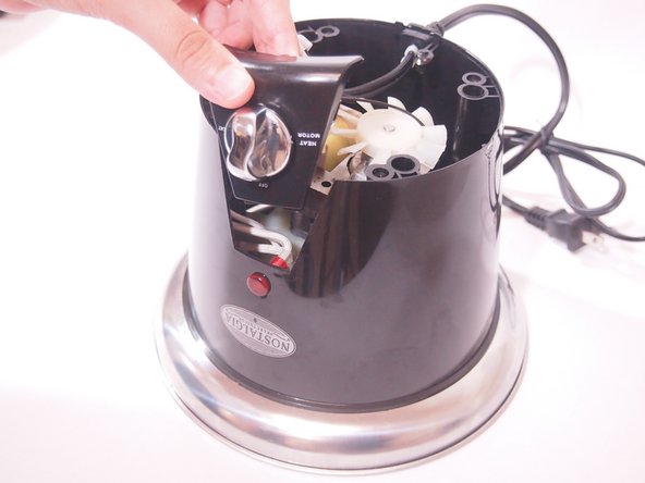

  5. Nostalgia Chocolate Fondue Fountain CFF965 Baseplate and Switch Replacement: crwdns2935265:05crwdnd2935265:01crwdnd2935265:02crwdne2935265:0 Nostalgia Chocolate Fondue Fountain CFF965 Baseplate and Switch Replacement: crwdns2935265:05crwdnd2935265:02crwdnd2935265:02crwdne2935265:0
    • Use your hands to pull up on the baseplate to remove it.
    • Pull the panel with the switch on it upwards.
