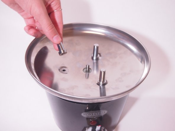

  3. Nostalgia Chocolate Fondue Fountain CFF965 Base Bowl Replacement, Baseplate and Switch: crwdns2935265:03crwdnd2935265:01crwdnd2935265:01crwdne2935265:0
    • Flip over the device so that the bowl is now face down.
    • Use your hands to unscrew both 21.3mm screws.
  4. Nostalgia Chocolate Fondue Fountain CFF965 Base Bowl Replacement: crwdns2935265:04crwdnd2935265:01crwdnd2935265:03crwdne2935265:0 Nostalgia Chocolate Fondue Fountain CFF965 Base Bowl Replacement: crwdns2935265:04crwdnd2935265:02crwdnd2935265:03crwdne2935265:0 Nostalgia Chocolate Fondue Fountain CFF965 Base Bowl Replacement: crwdns2935265:04crwdnd2935265:03crwdnd2935265:03crwdne2935265:0
    • Unscrew all three 14.2 mm screws with a Phillips #2 screwdriver.
    • Unscrew the 9.1 mm screw near the switch with a Phillips #2 screwdriver.
    • Unscrew the two 14.2 mm spanner screws using a spanner screwdriver (size 6).

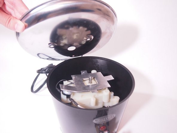

  5. Nostalgia Chocolate Fondue Fountain CFF965 Base Bowl Replacement: crwdns2935265:05crwdnd2935265:01crwdnd2935265:02crwdne2935265:0 Nostalgia Chocolate Fondue Fountain CFF965 Base Bowl Replacement: crwdns2935265:05crwdnd2935265:02crwdnd2935265:02crwdne2935265:0
    • Use your hands to pull up on the baseplate to remove it.
    • Pull the panel with the switch on it upwards.
  6. Nostalgia Chocolate Fondue Fountain CFF965 Base Bowl Replacement, Base Bowl: crwdns2935265:06crwdnd2935265:01crwdnd2935265:01crwdne2935265:0
    • Unscrew the two 22.1 mm machine screws that secure the motor with a Phillips #2 screwdriver.
    • Remove their adjoining 5.9 mm washers by hand.
  7. Nostalgia Chocolate Fondue Fountain CFF965 Base Bowl Replacement: crwdns2935265:07crwdnd2935265:01crwdnd2935265:03crwdne2935265:0 Nostalgia Chocolate Fondue Fountain CFF965 Base Bowl Replacement: crwdns2935265:07crwdnd2935265:02crwdnd2935265:03crwdne2935265:0 Nostalgia Chocolate Fondue Fountain CFF965 Base Bowl Replacement: crwdns2935265:07crwdnd2935265:03crwdnd2935265:03crwdne2935265:0
    • Unscrew the three 25.4 mm Phillips #2 sheet metal screws that connect the base bowl to the white plastic structure.
    • When unscrewing, make sure to hold the metal tower studs on the opposite side of the base bowl (see the second picture). This will make it easier to unscrew the screws.
    • Flip the base over and remove the base bowl by hand.
