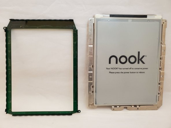

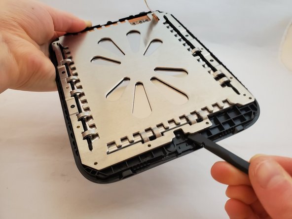

    1. Nook BNRV300 Display Replacement, Display: crwdns2935265:010crwdnd2935265:01crwdnd2935265:03crwdne2935265:0 Nook BNRV300 Display Replacement, Display: crwdns2935265:010crwdnd2935265:02crwdnd2935265:03crwdne2935265:0 Nook BNRV300 Display Replacement, Display: crwdns2935265:010crwdnd2935265:03crwdnd2935265:03crwdne2935265:0
      • Insert a nylon spudger between the display's metal backing and the front cover plastic.
      • Gently pry the display away from the front cover by moving the spudger up and down.
      • During reassembly, align the small black plastic peg at the bottom right of the plastic frame with the inner hole at the bottom right of the metal display backing.

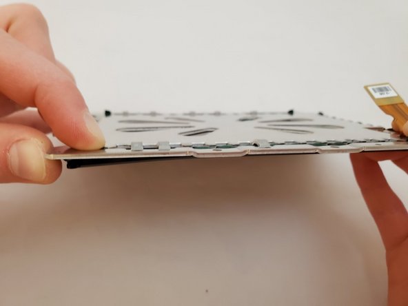

    2. Nook BNRV300 Display Replacement: crwdns2935265:011crwdnd2935265:01crwdnd2935265:02crwdne2935265:0 Nook BNRV300 Display Replacement: crwdns2935265:011crwdnd2935265:02crwdnd2935265:02crwdne2935265:0
      • Press down on the fastener tab with your finger.

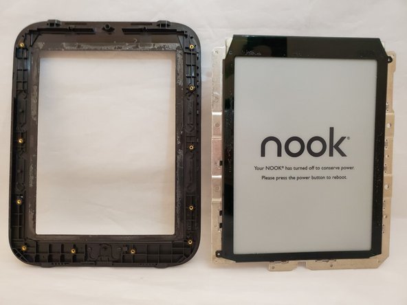

    3. Nook BNRV300 Display Replacement: crwdns2935265:012crwdnd2935265:01crwdnd2935265:02crwdne2935265:0 Nook BNRV300 Display Replacement: crwdns2935265:012crwdnd2935265:02crwdnd2935265:02crwdne2935265:0
      • The display cracks very easily. If this happens, there will be glass shards that could potentially cause injury. You may want to wear protection for hands and eyes while completing this step.
      • Insert a nylon spudger between the plastic frame on the display and the metal casing on the display.
      • Gently pry the display away from the plastic frame. Place the display on a hard, flat surface to support it when prying it off the metal backing. The screen may crack anyway.

Was all good till I got here:
The display was glued to the metal backing. Needs something to heat up the adhesive in order to remove it.
