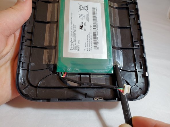

  7. Nook BNRV300 Battery Replacement, Battery: crwdns2935265:07crwdnd2935265:01crwdnd2935265:03crwdne2935265:0 Nook BNRV300 Battery Replacement, Battery: crwdns2935265:07crwdnd2935265:02crwdnd2935265:03crwdne2935265:0 Nook BNRV300 Battery Replacement, Battery: crwdns2935265:07crwdnd2935265:03crwdnd2935265:03crwdne2935265:0
    • The battery is located on the inside back cover of the Nook.
    • Do not use metal tools when prying up the battery. This may puncture the battery and cause harm to you and/or your device.
    • Insert a nylon spudger beneath the clear plastic adhesive holding the battery to the back cover.
    • Work around the battery, peeling up all of the adhesive.

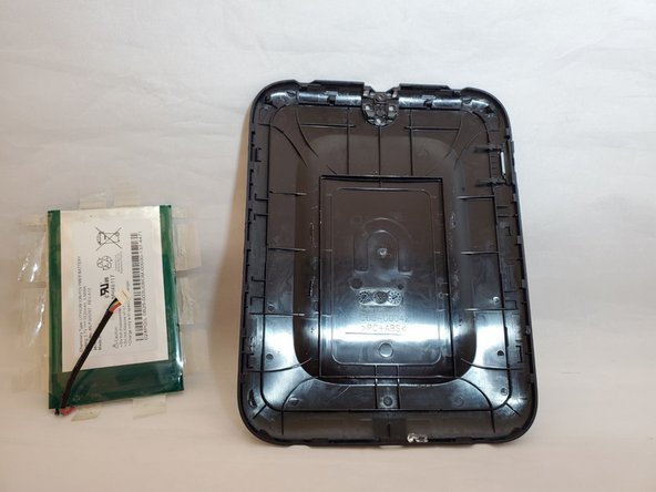

  8. Nook BNRV300 Battery Replacement: crwdns2935265:08crwdnd2935265:01crwdnd2935265:02crwdne2935265:0 Nook BNRV300 Battery Replacement: crwdns2935265:08crwdnd2935265:02crwdnd2935265:02crwdne2935265:0
    • Hold on to one of the adhesive tabs and pull up.
    • This will fully remove the battery from its compartment.
