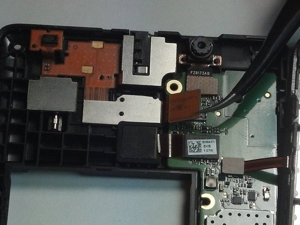

  6. Nokia XL Dual SIM Motherboard Replacement, Removing Connectors: crwdns2935265:06crwdnd2935265:01crwdnd2935265:02crwdne2935265:0 Nokia XL Dual SIM Motherboard Replacement, Removing Connectors: crwdns2935265:06crwdnd2935265:02crwdnd2935265:02crwdne2935265:0
    • With tweezers, gently unsnap the motherboard connectors for all components.
    • The location of all the connectors is indicated in the next step.
  7. Nokia XL Dual SIM Motherboard Replacement, Connector Locations: crwdns2935265:07crwdnd2935265:01crwdnd2935265:03crwdne2935265:0 Nokia XL Dual SIM Motherboard Replacement, Connector Locations: crwdns2935265:07crwdnd2935265:02crwdnd2935265:03crwdne2935265:0 Nokia XL Dual SIM Motherboard Replacement, Connector Locations: crwdns2935265:07crwdnd2935265:03crwdnd2935265:03crwdne2935265:0
    • The 3 motherboard connectors for the touchscreen, volume buttons, and power/screen lock button assembly are indicated on the picture.
    • The touchscreen assembly can now be removed and set aside.
    • The motherboard connector for the front camera is indicated on the picture.
    • The motherboard connector for the camera flash, vibrator, and headphone jack assembly is indicated in the picture.
