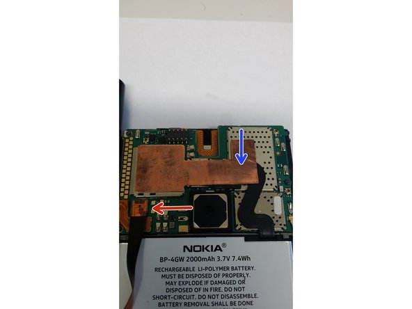

  4. Nokia Lumia 920 Screen Replacement, Connectors: crwdns2935265:04crwdnd2935265:01crwdnd2935265:03crwdne2935265:0 Nokia Lumia 920 Screen Replacement, Connectors: crwdns2935265:04crwdnd2935265:02crwdnd2935265:03crwdne2935265:0 Nokia Lumia 920 Screen Replacement, Connectors: crwdns2935265:04crwdnd2935265:03crwdnd2935265:03crwdne2935265:0
    • Don't remove the back cover completely yet because it's still attached with a ribbon cable which you can easily rip apart.
    • First remove the metal shield holding the cable in place, then disconnect the connector that attaches the back cover to the motherboard. Then remove the cable. This works best using a plastic tool or a spudger.
    • Remove the copper tape and disconnect the battery.

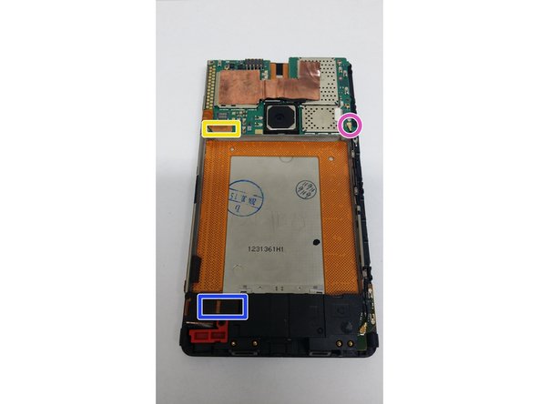

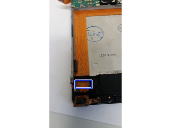

  6. Nokia Lumia 920 Screen Replacement: crwdns2935265:06crwdnd2935265:01crwdnd2935265:03crwdne2935265:0 Nokia Lumia 920 Screen Replacement: crwdns2935265:06crwdnd2935265:02crwdnd2935265:03crwdne2935265:0 Nokia Lumia 920 Screen Replacement: crwdns2935265:06crwdnd2935265:03crwdnd2935265:03crwdne2935265:0
    • Remove the metal plate at the bottom of the battery.
    • Disconnect the volume / power switch.
    • Carefully disconnect the RF cable from the motherboard.
    • And disconnect the digitizer cable (Touch / LCD connector).

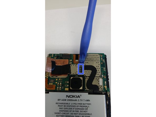

  7. Nokia Lumia 920 Screen Replacement, Touch connector: crwdns2935265:07crwdnd2935265:01crwdnd2935265:03crwdne2935265:0 Nokia Lumia 920 Screen Replacement, Touch connector: crwdns2935265:07crwdnd2935265:02crwdnd2935265:03crwdne2935265:0 Nokia Lumia 920 Screen Replacement, Touch connector: crwdns2935265:07crwdnd2935265:03crwdnd2935265:03crwdne2935265:0
    • Push up the touch array cable to disconnect it.
    • Don't use brute force to remove it, just wiggle it lose with a plastic tool. If this is difficult, use a heathen (a hair dryer should also work).
    • Disconnect the LCD connector using a plastic tool.

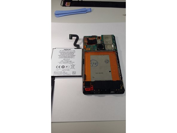

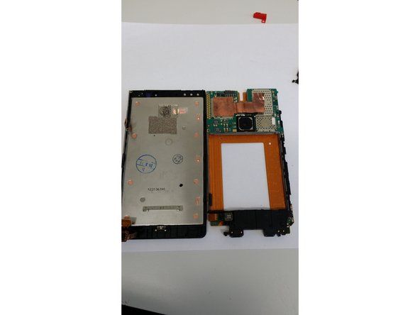

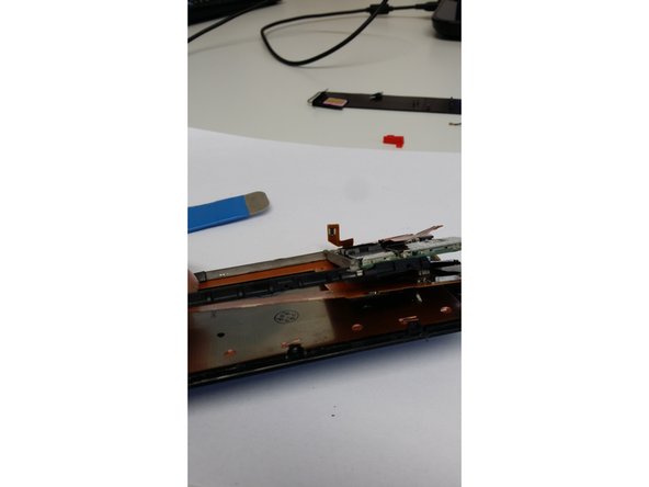

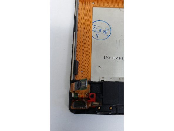

  8. Nokia Lumia 920 Screen Replacement, Remove the cover of the motherboard: crwdns2935265:08crwdnd2935265:01crwdnd2935265:03crwdne2935265:0 Nokia Lumia 920 Screen Replacement, Remove the cover of the motherboard: crwdns2935265:08crwdnd2935265:02crwdnd2935265:03crwdne2935265:0 Nokia Lumia 920 Screen Replacement, Remove the cover of the motherboard: crwdns2935265:08crwdnd2935265:03crwdnd2935265:03crwdne2935265:0
    • During this step, some components may fall out of their place, such as the speaker or SIM card cover, but you can easily put them back by slightly lifting up the logic board.
    • Insert your iSesamo between the cover of the motherboard and the cover of the LCD which is very brittle.
    • Unclick the cover of the motherboard (which should be very easy to do).
    • On picture 3 you can see that you also have to remove the camera AND the proximity sensor.
To reassemble the phone, follow the instructions in reverse order
