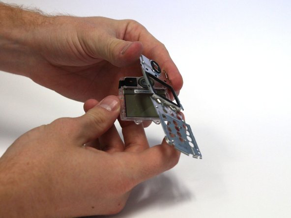

  3. Nokia 8290 Speaker Replacement: crwdns2935265:03crwdnd2935265:01crwdnd2935265:03crwdne2935265:0 Nokia 8290 Speaker Replacement: crwdns2935265:03crwdnd2935265:02crwdnd2935265:03crwdne2935265:0 Nokia 8290 Speaker Replacement: crwdns2935265:03crwdnd2935265:03crwdnd2935265:03crwdne2935265:0
    • Using your fingers, pull the small plastic tab away from the circuit board/faceplate sub-assembly.
    • Rotate the faceplate away from the circuit board.
    • Gently remove the faceplate from the circuit board, taking care to not break the small plastic tab on the other side of the sub-assembly.

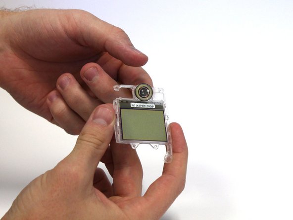

  4. Nokia 8290 Speaker Replacement, Adhesive White Film: crwdns2935265:04crwdnd2935265:01crwdnd2935265:03crwdne2935265:0 Nokia 8290 Speaker Replacement, Adhesive White Film: crwdns2935265:04crwdnd2935265:02crwdnd2935265:03crwdne2935265:0 Nokia 8290 Speaker Replacement, Adhesive White Film: crwdns2935265:04crwdnd2935265:03crwdnd2935265:03crwdne2935265:0
    • Hold the faceplate with the adhesive film facing upwards.
    • Use the spudger to pry the adhesive film away. This can be done by working the tool back and forth underneath the film.
    • It is easiest to begin in the upper left corner.

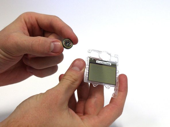

  5. Nokia 8290 Speaker Replacement: crwdns2935265:05crwdnd2935265:01crwdnd2935265:03crwdne2935265:0 Nokia 8290 Speaker Replacement: crwdns2935265:05crwdnd2935265:02crwdnd2935265:03crwdne2935265:0 Nokia 8290 Speaker Replacement: crwdns2935265:05crwdnd2935265:03crwdnd2935265:03crwdne2935265:0
    • Continue to loosen the film with the spudger.
    • Once the film has been mostly loosened, you can peel away the film.
    • Once the film has been removed, the microphone may fall out, if so, place it aside until all other repairs are finished.

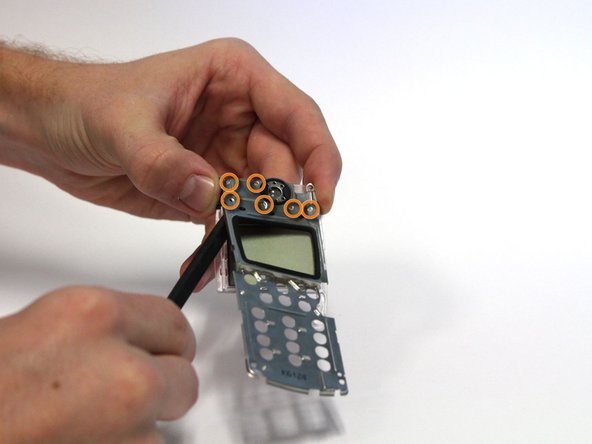

  6. Nokia 8290 Speaker Replacement, Speaker: crwdns2935265:06crwdnd2935265:01crwdnd2935265:03crwdne2935265:0 Nokia 8290 Speaker Replacement, Speaker: crwdns2935265:06crwdnd2935265:02crwdnd2935265:03crwdne2935265:0 Nokia 8290 Speaker Replacement, Speaker: crwdns2935265:06crwdnd2935265:03crwdnd2935265:03crwdne2935265:0
    • Using your fingers or a probe, loosen the four small tabs located on the side of the faceplate sub-assembly by gently bending up the metal cover. (Two are shown in the picture while the other two are on the other side of the screen.)
    • Using the spudger, loosen the metal cover by prying it away from the six small plastic tabs. This can be done by gently working the spudger underneath the cover and pressing up on the cover around the tabs.
    • Remove the metal cover.
  7. Nokia 8290 Speaker Replacement: crwdns2935265:07crwdnd2935265:01crwdnd2935265:03crwdne2935265:0 Nokia 8290 Speaker Replacement: crwdns2935265:07crwdnd2935265:02crwdnd2935265:03crwdne2935265:0 Nokia 8290 Speaker Replacement: crwdns2935265:07crwdnd2935265:03crwdnd2935265:03crwdne2935265:0
    • Hold the remaining component tray face up.
    • Push the speaker from behind to remove it from the tray.
