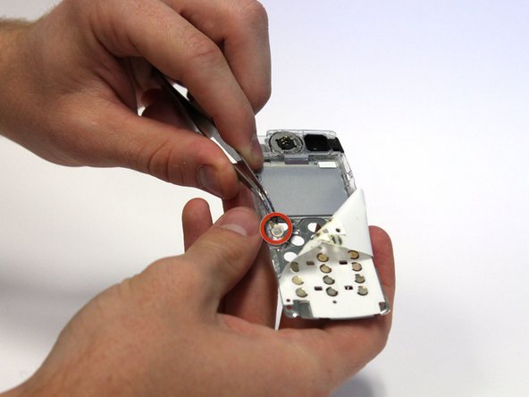

  4. Nokia 8290 Microphone Replacement, Microphone: crwdns2935265:04crwdnd2935265:01crwdnd2935265:03crwdne2935265:0 Nokia 8290 Microphone Replacement, Microphone: crwdns2935265:04crwdnd2935265:02crwdnd2935265:03crwdne2935265:0 Nokia 8290 Microphone Replacement, Microphone: crwdns2935265:04crwdnd2935265:03crwdnd2935265:03crwdne2935265:0
    • Use the spudger to peel back the top-left corner of the white adhesive film. This can be done by working the spudger back and forth underneath the film.

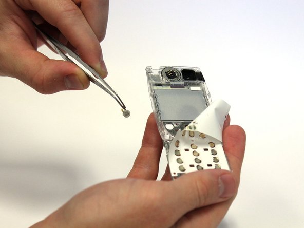

  5. Nokia 8290 Microphone Replacement: crwdns2935265:05crwdnd2935265:01crwdnd2935265:03crwdne2935265:0 Nokia 8290 Microphone Replacement: crwdns2935265:05crwdnd2935265:02crwdnd2935265:03crwdne2935265:0 Nokia 8290 Microphone Replacement: crwdns2935265:05crwdnd2935265:03crwdnd2935265:03crwdne2935265:0
    • Continue to peel the film back until you can see the microphone.
    • Use tweezers to remove the microphone.
