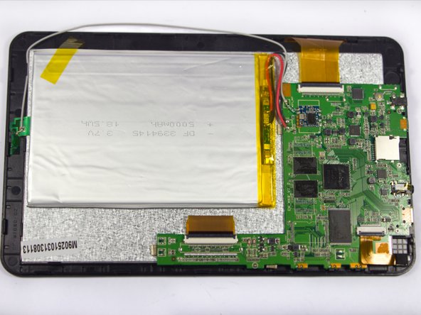

      • Remove the black electronic tape covering the circuit board.
    4. Nobis NB09 Battery Replacement: crwdns2935265:04crwdnd2935265:01crwdnd2935265:01crwdne2935265:0
      • Use the soldering iron to remove the black and red wires from the circuit board.
      • The black wire is the ground and the red wire is the battery positive terminal.
      • To reassemble, use the soldering iron to solder the leads at the end of the black (-) and red (+) wires from the new battery onto the proper terminals on the circuit board.

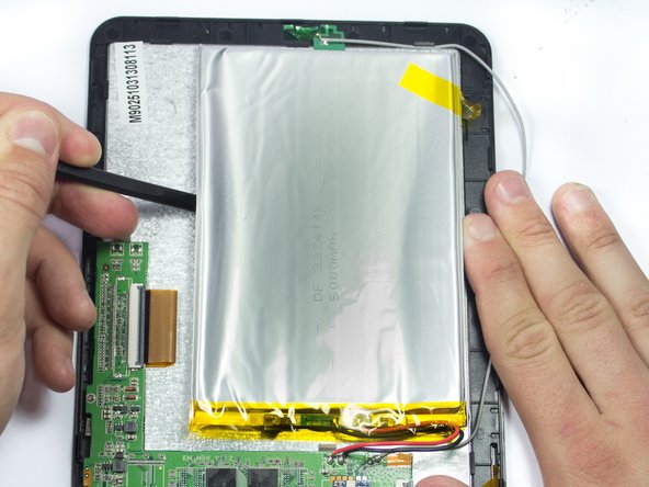

      • Gently loosen the adhesive under the battery to avoid damaging it.
      • Use caution; the battery is soft and will bend very easily.
      • Dispose of the old battery properly at an electronic waste center or verified battery recycling store.
      • When reassembling, apply adhesive to the back of the new battery.
