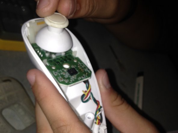

  17. Nintendo Wii Remote & Wii Nunchuk Accessory Disassembly/Reassembly, Now Wii Nunchuk Disassembly: crwdns2935265:017crwdnd2935265:01crwdnd2935265:02crwdne2935265:0 Nintendo Wii Remote & Wii Nunchuk Accessory Disassembly/Reassembly, Now Wii Nunchuk Disassembly: crwdns2935265:017crwdnd2935265:02crwdnd2935265:02crwdne2935265:0
    • There are two small Y1 tri-point screws that need to be loosened on the bottom of the remote.
  18. Nintendo Wii Remote & Wii Nunchuk Accessory Disassembly/Reassembly: crwdns2935265:018crwdnd2935265:01crwdnd2935265:02crwdne2935265:0 Nintendo Wii Remote & Wii Nunchuk Accessory Disassembly/Reassembly: crwdns2935265:018crwdnd2935265:02crwdnd2935265:02crwdne2935265:0
    iFixit Opening Picks (Set of 6)
    • Once the screws are removed, you can remove the top half of the chassis off.
    • You may use an opening tool to assist with this step, such as the iFixit opening pick as an example.
    • Next gently pull off the thumb stick.
  19. Nintendo Wii Remote & Wii Nunchuk Accessory Disassembly/Reassembly: crwdns2935265:019crwdnd2935265:01crwdnd2935265:02crwdne2935265:0 Nintendo Wii Remote & Wii Nunchuk Accessory Disassembly/Reassembly: crwdns2935265:019crwdnd2935265:02crwdnd2935265:02crwdne2935265:0
    • The cable that plugs into the Wii remote needs to be removed from the whole nunchuk by pulling upwards on the strain relief boot.
    • The cable and circuit board assembly can still function when plugged into a Wii remote without the nunchuck's controller housing.

  24. Nintendo Wii Remote & Wii Nunchuk Accessory Disassembly/Reassembly: crwdns2935265:024crwdnd2935265:01crwdnd2935265:02crwdne2935265:0 Nintendo Wii Remote & Wii Nunchuk Accessory Disassembly/Reassembly: crwdns2935265:024crwdnd2935265:02crwdnd2935265:02crwdne2935265:0
    • Then press the analog stick onto the Wii nunchuck's analog stick stem to reattach it.
