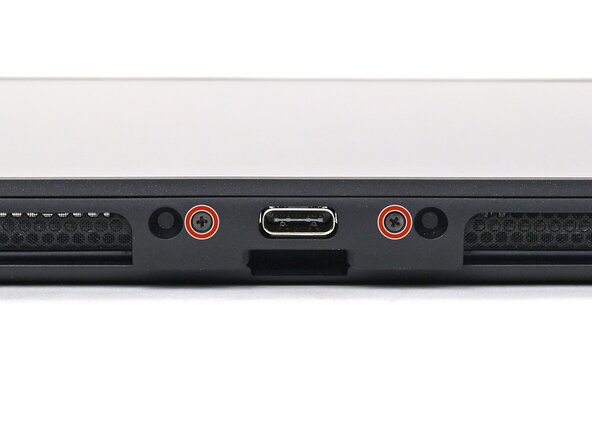

  2. Nintendo Switch 2 Back Cover Replacement, Remove the bottom screws: crwdns2935265:02crwdnd2935265:01crwdnd2935265:02crwdne2935265:0 Nintendo Switch 2 Back Cover Replacement, Remove the bottom screws: crwdns2935265:02crwdnd2935265:02crwdnd2935265:02crwdne2935265:0
    • Use a JIS 00 driver to remove the two 3.1 mm‑long screws on either side of the bottom USB-C port.
    • You can try a non-iFixit Phillips driver in a pinch, but you risk damaging or stripping the screw. Push down firmly on the driver and twist slowly.

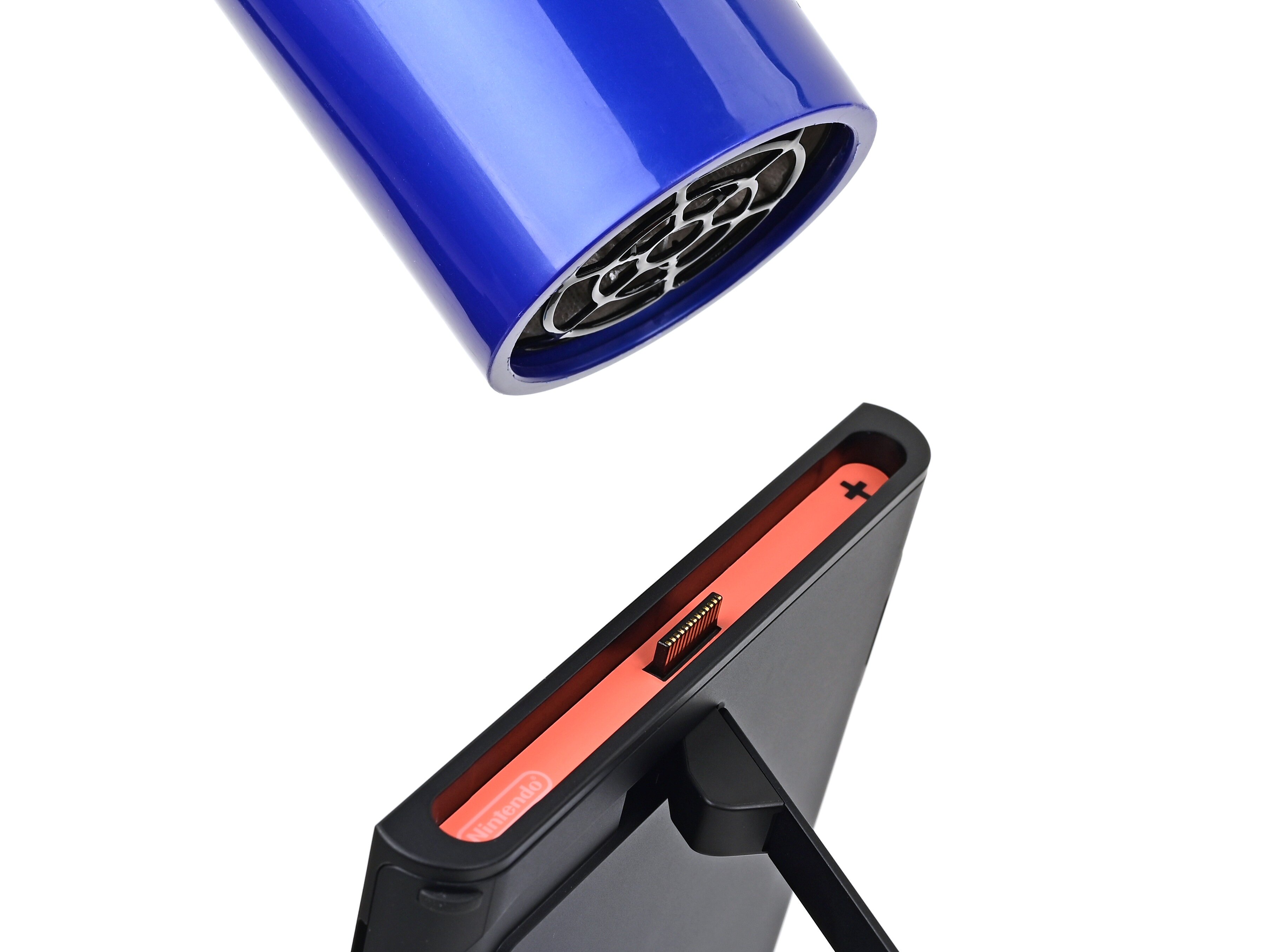

  4. Nintendo Switch 2 Back Cover Replacement, Heat the right side sticker: crwdns2935265:04crwdnd2935265:01crwdnd2935265:01crwdne2935265:0
    • The Switch 2 has stickers on either side that need to removed to access the screws securing the back cover. It's easy to damage the stickers during removal, but you can mitigate this by regularly reheating the stickers and working carefully.
    • Use a hair dryer or heat gun to heat the sticker on the right side of the console, labeled with a "+" symbol, until it's hot to the touch.
    • You can use the kickstand to prop the console up vertically for easier access.
    • If you're using a heat gun, set it to low to avoid melting the plastic edge of the console.

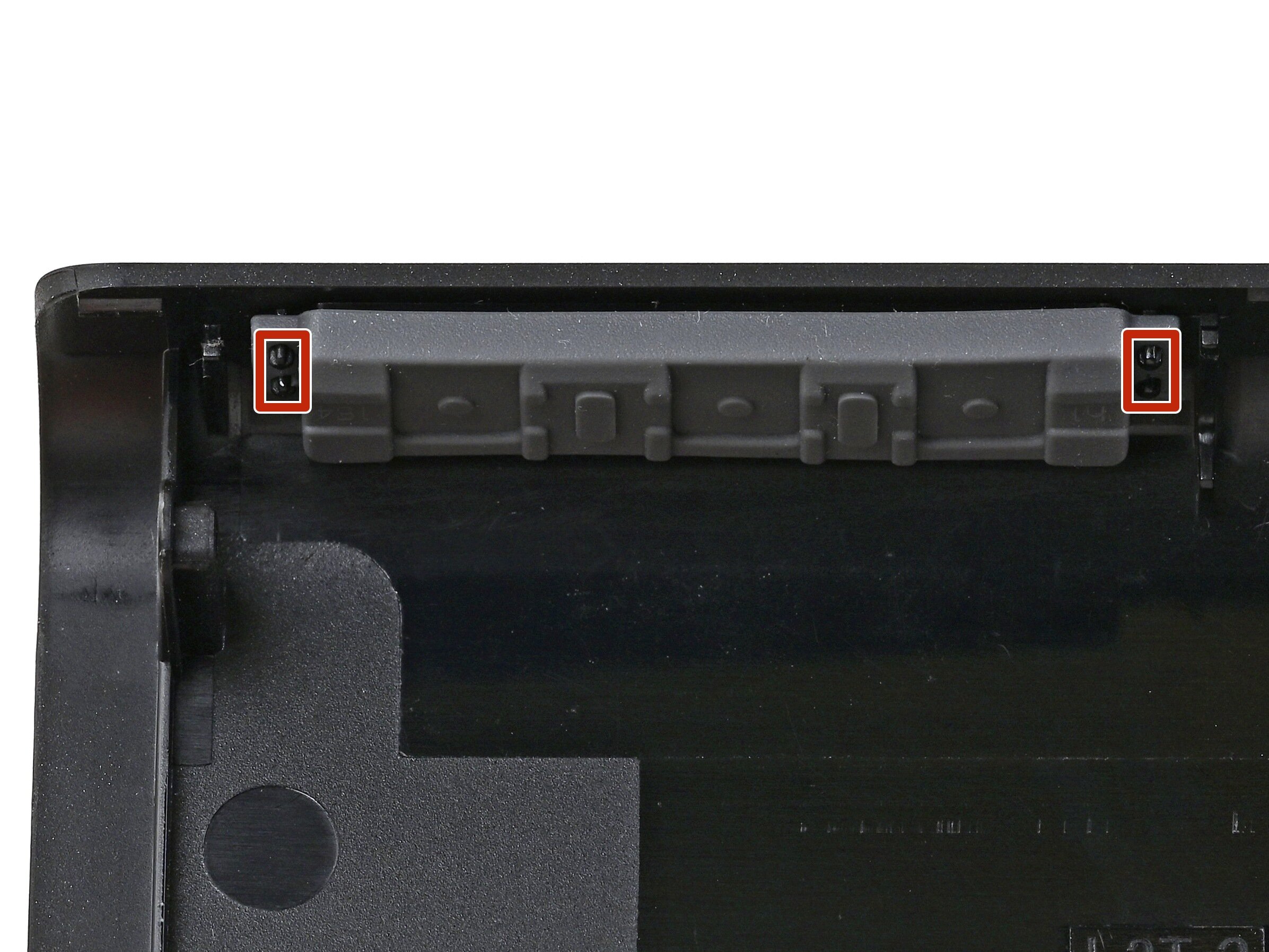

  20. Nintendo Switch 2 Back Cover Replacement, Prepare the back cover: crwdns2935265:020crwdnd2935265:01crwdnd2935265:03crwdne2935265:0 Nintendo Switch 2 Back Cover Replacement, Prepare the back cover: crwdns2935265:020crwdnd2935265:02crwdnd2935265:03crwdne2935265:0 Nintendo Switch 2 Back Cover Replacement, Prepare the back cover: crwdns2935265:020crwdnd2935265:03crwdnd2935265:03crwdne2935265:0
    • Fully pull out the game card tray.
    • Double-check the power and volume buttons to ensure they're seated correctly. If the rubber membrane beneath the buttons is out of place, ensure it's aligned with its pegs.
    • Check the microphone to ensure it's fully seated in its slot in the frame.
