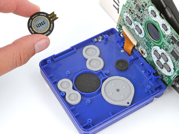

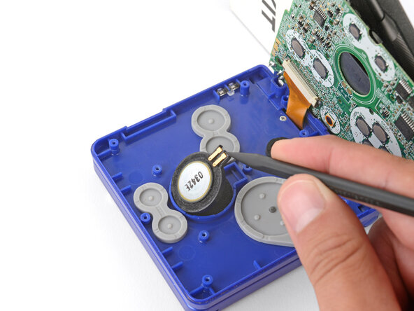

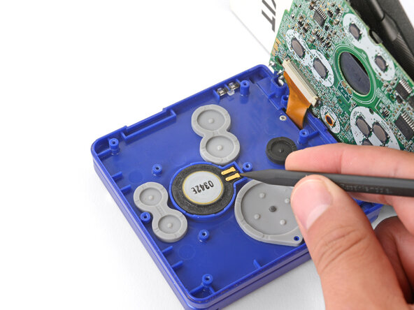

  10. Nintendo Game Boy Advance SP Speaker Replacement, Remove the speaker: crwdns2935265:010crwdnd2935265:01crwdnd2935265:03crwdne2935265:0 Nintendo Game Boy Advance SP Speaker Replacement, Remove the speaker: crwdns2935265:010crwdnd2935265:02crwdnd2935265:03crwdne2935265:0 Nintendo Game Boy Advance SP Speaker Replacement, Remove the speaker: crwdns2935265:010crwdnd2935265:03crwdnd2935265:03crwdne2935265:0
    • Use the point of a spudger or a clean fingernail to lift the speaker until you can grip it with your fingers.
    • Grip the speaker with your fingers and remove it.
