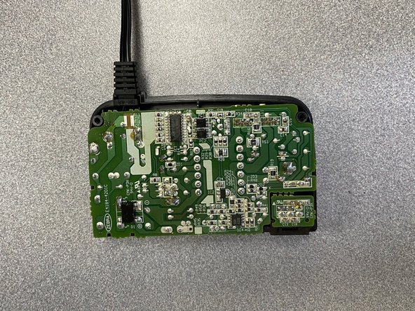

  3. Nintendo 64 Power Supply Power Cable Replacement: crwdns2935265:03crwdnd2935265:01crwdnd2935265:01crwdne2935265:0
    • Remove the circuit board from the other half of the plastic case by pulling it straight out
    • There may be some adhesive holding it on to the plastic

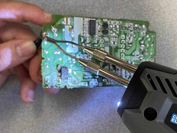

  4. Nintendo 64 Power Supply Power Cable Replacement: crwdns2935265:04crwdnd2935265:01crwdnd2935265:02crwdne2935265:0 Nintendo 64 Power Supply Power Cable Replacement: crwdns2935265:04crwdnd2935265:02crwdnd2935265:02crwdne2935265:0
    • Remove the original power leads by melting the solder using a soldering gun.
    • You will need to pull the wire from the backside but use caution to not touch any metallic parts as they will be hot.
    • If you do not know how to solder, read this Soldering Skills guide on ifixit.

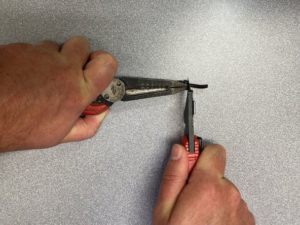

  5. Nintendo 64 Power Supply Power Cable Replacement: crwdns2935265:05crwdnd2935265:01crwdnd2935265:03crwdne2935265:0 Nintendo 64 Power Supply Power Cable Replacement: crwdns2935265:05crwdnd2935265:02crwdnd2935265:03crwdne2935265:0 Nintendo 64 Power Supply Power Cable Replacement: crwdns2935265:05crwdnd2935265:03crwdnd2935265:03crwdne2935265:0

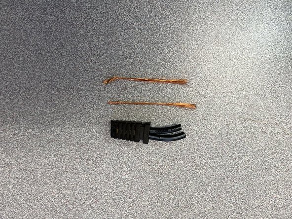

    • Clear the boot by pulling the copper wires out with pliers.
    • This will leave the wire sheathing which can then be cut flush with sharp knife.
    • Tip: Sand cut the end with fine grit sandpaper if desired.

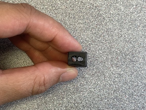

  6. Nintendo 64 Power Supply Power Cable Replacement: crwdns2935265:06crwdnd2935265:01crwdnd2935265:02crwdne2935265:0 Nintendo 64 Power Supply Power Cable Replacement: crwdns2935265:06crwdnd2935265:02crwdnd2935265:02crwdne2935265:0
    • Use the drill to drill out the wire sheathing.
    • Drill each hole twice.
    • First, use a 5/64th drill bit. Then, use a larger 1/8th drill bit to finish.
    • The holes should be clean and free of debris once complete.

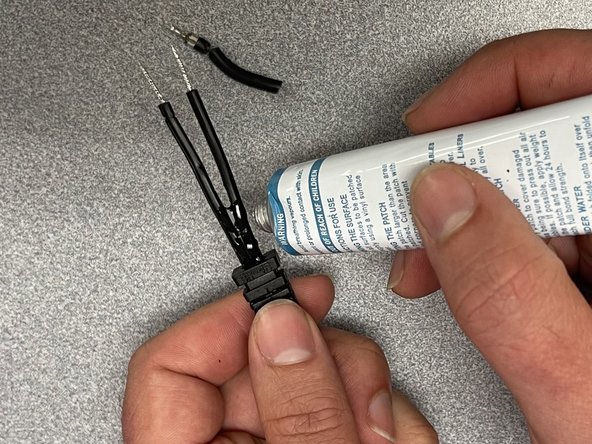

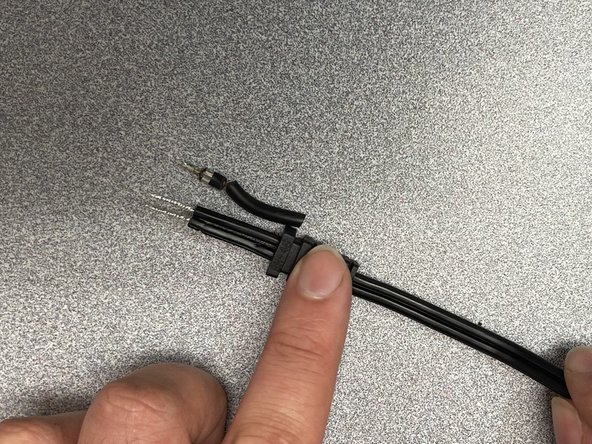

    • Feed the new cable through the boot .
    • Glue it in place by applying glue to the wire (close to the desired location of the boot) and sliding the boot into place.
    • Be sure the exposed wire length is close to the original.

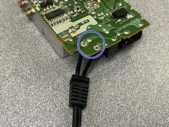

    • Align the wires with their original positions on the circuit board.
    • Looking at the component side of the board, the hot side is marked with an L for load and the neutral is marked with an N.
    • The neutral wire goes here, the hole closer to the center of the circuit board.
    • The hot wire goes here, closer to the outside.

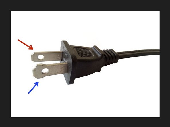

    • The neutral wire can be identified by the wider prong on the plug end of the cord.
  9. Nintendo 64 Power Supply Power Cable Replacement: crwdns2935265:09crwdnd2935265:01crwdnd2935265:02crwdne2935265:0 Nintendo 64 Power Supply Power Cable Replacement: crwdns2935265:09crwdnd2935265:02crwdnd2935265:02crwdne2935265:0
    • Solder the new wires onto the circuit board.
  10. Nintendo 64 Power Supply Power Cable Replacement: crwdns2935265:010crwdnd2935265:01crwdnd2935265:02crwdne2935265:0 Nintendo 64 Power Supply Power Cable Replacement: crwdns2935265:010crwdnd2935265:02crwdnd2935265:02crwdne2935265:0

Stap 5 and Stap 6 can be replaced using boiled water and soak de boot for a few minutes. Now you can pull out the old wires from the boot.
