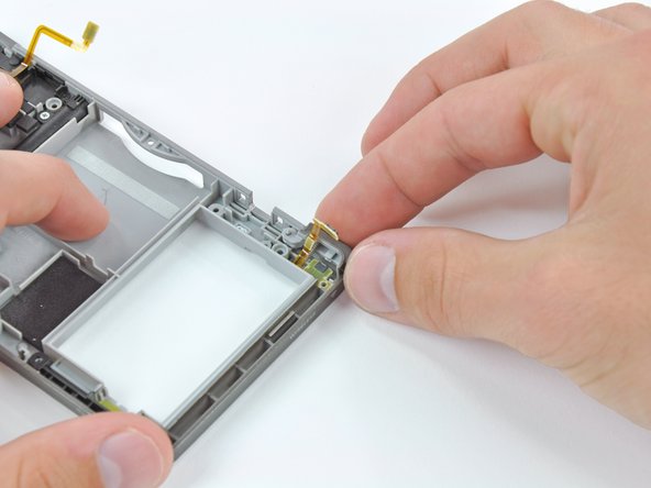

  5. Nintendo 3DS Right Shoulder Button Replacement: crwdns2935265:05crwdnd2935265:01crwdnd2935265:03crwdne2935265:0 Nintendo 3DS Right Shoulder Button Replacement: crwdns2935265:05crwdnd2935265:02crwdnd2935265:03crwdne2935265:0 Nintendo 3DS Right Shoulder Button Replacement: crwdns2935265:05crwdnd2935265:03crwdnd2935265:03crwdne2935265:0
    • Lift the bottom edge of the lower case off the rest of the 3DS.
    • There are still two ribbon cables connecting the mother board to the case, so be sure not to pull the lower case all the way off.
    • Use a plastic opening tool to pry the shoulder button ribbon cables off their sockets on the motherboard.
    • Remove the lower case from the device.
  6. Nintendo 3DS Right Shoulder Button Replacement, Right Shoulder Button: crwdns2935265:06crwdnd2935265:01crwdnd2935265:03crwdne2935265:0 Nintendo 3DS Right Shoulder Button Replacement, Right Shoulder Button: crwdns2935265:06crwdnd2935265:02crwdnd2935265:03crwdne2935265:0 Nintendo 3DS Right Shoulder Button Replacement, Right Shoulder Button: crwdns2935265:06crwdnd2935265:03crwdnd2935265:03crwdne2935265:0
    • Remove the three 3.6 mm Phillips screws securing the metal battery shield to the lower case.
    • Lift the battery shield up and out of the lower case.
  7. Nintendo 3DS Right Shoulder Button Replacement: crwdns2935265:07crwdnd2935265:01crwdnd2935265:01crwdne2935265:0
    • Remove the 3.6 mm Phillips screw from the right shoulder button cover.
  8. Nintendo 3DS Right Shoulder Button Replacement: crwdns2935265:08crwdnd2935265:01crwdnd2935265:03crwdne2935265:0 Nintendo 3DS Right Shoulder Button Replacement: crwdns2935265:08crwdnd2935265:02crwdnd2935265:03crwdne2935265:0 Nintendo 3DS Right Shoulder Button Replacement: crwdns2935265:08crwdnd2935265:03crwdnd2935265:03crwdne2935265:0
    • Insert a plastic opening tool under the left side of the right shoulder button cover.
    • Pry the black plastic cover up from the lower case.
    • Grab the cover and lift it off of the lower case.
    • If the shoulder button contact and ribbon cable come off with the cover, be sure to reinstall them in the correct orientation.
  9. Nintendo 3DS Right Shoulder Button Replacement: crwdns2935265:09crwdnd2935265:01crwdnd2935265:03crwdne2935265:0 Nintendo 3DS Right Shoulder Button Replacement: crwdns2935265:09crwdnd2935265:02crwdnd2935265:03crwdne2935265:0 Nintendo 3DS Right Shoulder Button Replacement: crwdns2935265:09crwdnd2935265:03crwdnd2935265:03crwdne2935265:0
    • Lift the right shoulder button out of the lower case.
    • The shoulder button is held in place by a metal pin, and houses a small spring. Take care not to lose track of either of these pieces when removing the shoulder button.
