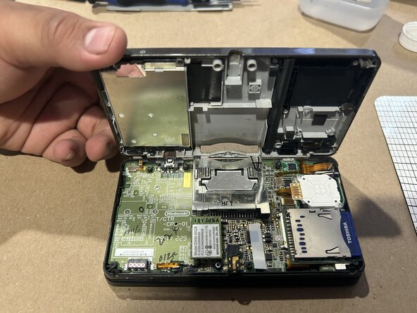

    • Use a JIS #00 screwdriver to remove all 10 screws to access the third layer and the motherboard of the 3DS.
    • Don't forget the one near the game card slot, it is silver, not black.
    • Exercise caution when opening the device. There are delicate ribbon cables at the top of the device that you risk ripping, so open slowly and gently.
    • Make sure to keep the screws, as you will need them for reassembly. Don't lose them!

    • To remove the cartridge reader look for 4 solder joints, 2 on each side of the reader (see image).
    • Apply heat to them with a soldering iron to melt the solder and take out the reader.
    • Use a spudger to lift the reader out of the board as you apply heat.
    • You can apply some solder flux or even some new solder wire to form an alloy between the old and new metals, this would ease the task.
    • The soldering iron can cause severe burns if not used properly. Proceed with caution and have an adult in the room with you if underage.
