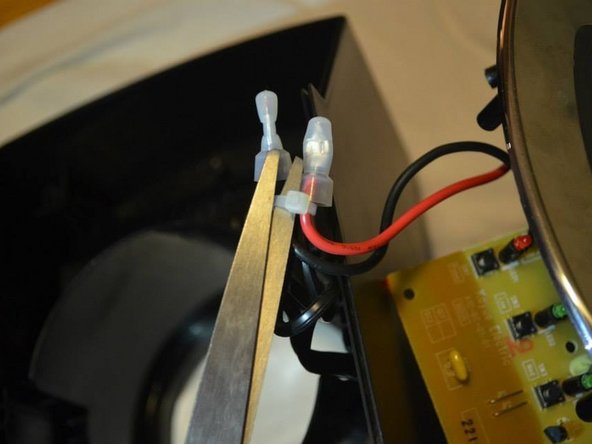

  7. Ninja NJ600 Power Cord Replacement: crwdns2935265:07crwdnd2935265:01crwdnd2935265:02crwdne2935265:0 Ninja NJ600 Power Cord Replacement: crwdns2935265:07crwdnd2935265:02crwdnd2935265:02crwdne2935265:0
    • If there were no issues with the soldering connection in Step 6, check the wiring in the picture shown.
    • Remove the zip ties with a pair of scissors. Then remove the plastic that covers the wires.
    • If the wires underneath the plastic covers are loose or disconnected, try to desolder and solder the wires. Use the iFixit soldering guide to assist in this step.
    • Soldering iron is very hot, use caution when handling
