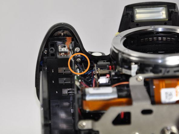

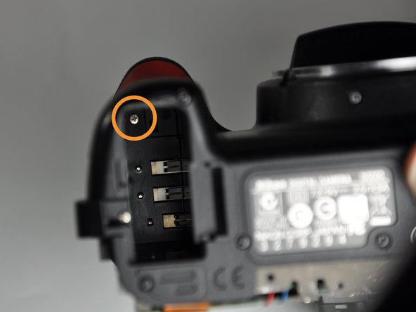

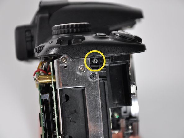

      • Next is the top panel. It is held on by four Phillips #00 screws:
      • Two 3x3.5mm black screws, one by each of the strap mounts.
      • One silver 3x5mm screw on the underside of the panel, about where the "Info" button is. It is the lower of the two in this area, and farther back in the camera.
      • One 3x3mm black screw in the side, under the plus/minus button.

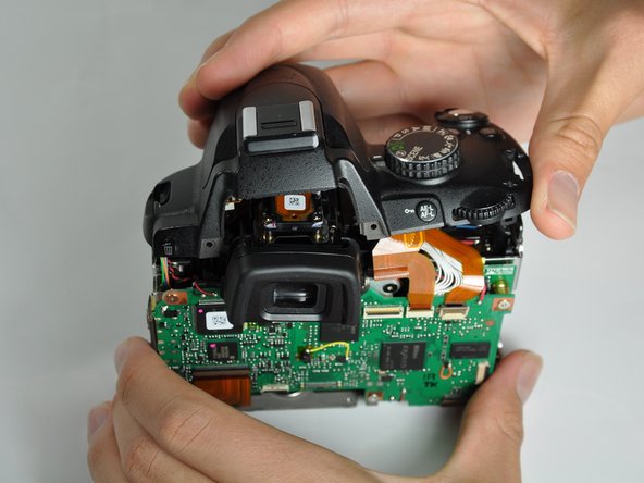

      • Disconnect the third ribbon cable from the right at the top of the back logic board.
      • Lift the top panel up.
      • There are still a number of cables connected to this panel. It cannot be removed completely at this point.
      • Remove the viewfinder hood by pulling outward.

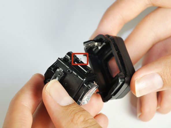

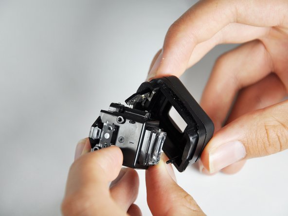

      • Remove the viewfinder window.
      • During reinstallation, there is a small tab on the side of the window assembly that needs to be reconnected (window removed for clarity).
      • After reinstalling the window assembly, catch the tab in the metal hook on the viewfinder hood (see third image). Then seat the two plastic pins on the bottom of the hood.
