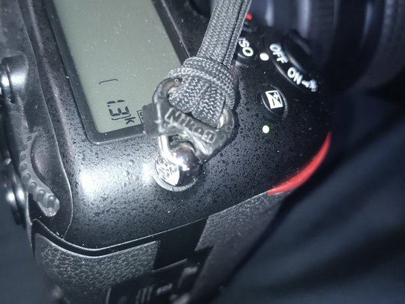

  19. Nikon D500 Top Assembly Replacement, Remove the neck strap rings: crwdns2935265:021crwdnd2935265:01crwdnd2935265:01crwdne2935265:0
    • (This step can be done before removing the top assembly from the camera, if desired)
    • Remove the existing strap from the camera
    • Remove the black plastic retainer clips by pushing them towards the camera
    • Using a metal pry tool, open the split ring and rotate it through the mount point to release it from the camera
    • Repeat the steps for the other side.
  20. Nikon D500 Top Assembly Replacement, Reattach the strap: crwdns2935265:022crwdnd2935265:01crwdnd2935265:02crwdne2935265:0 Nikon D500 Top Assembly Replacement, Reattach the strap: crwdns2935265:022crwdnd2935265:02crwdnd2935265:02crwdne2935265:0
    • (This step can be done before removing the existing top assembly, but is easier after installing it)
    • Using the metal spudger to hold the split ring open slide it into the mount on the new top assembly.
    • Keeping the side which has the 2 ends of the split ring either to the front or back, and the flat side away from the camera one of the other side, slide the black retainer clip onto the split ring, with the solid side away from the camera while the clip is the way a strap would hold it.
    • Repeat the step for the other side.
    • Reattach the neck strap to the connectors
