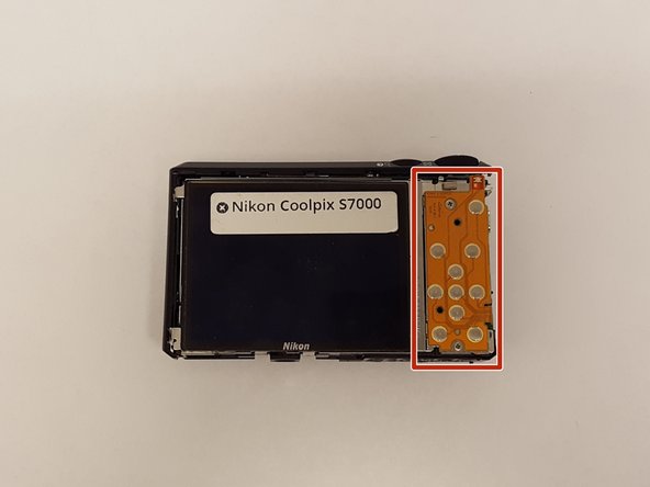

    • Remove outer camera frames by carefully pulling the frame apart from the body of the camera.
  3. Nikon Coolpix S7000 Sticky Button Replacement: crwdns2935265:04crwdnd2935265:01crwdnd2935265:03crwdne2935265:0 Nikon Coolpix S7000 Sticky Button Replacement: crwdns2935265:04crwdnd2935265:02crwdnd2935265:03crwdne2935265:0 Nikon Coolpix S7000 Sticky Button Replacement: crwdns2935265:04crwdnd2935265:03crwdnd2935265:03crwdne2935265:0
    • At this point push out any buttons that were jammed, and, clean the inside portion where the button sits inside the frames with isopropyl alcohol and a cotton swab as moisture may have found its way inside the camera causing stickiness.
    • Swab this portion.
  4. Nikon Coolpix S7000 Sticky Button Replacement: crwdns2935265:05crwdnd2935265:01crwdnd2935265:01crwdne2935265:0
    • If the navigation button is stuck, twist it around while the frame is removed to see if you can locate any obstructions.
    • If the shutter button is stuck, press up against it from the inside with your finger or the screwdriver to dislodge it.
