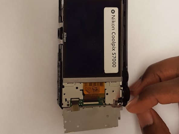

  7. Nikon Coolpix S7000 Navigation Button Replacement: crwdns2935265:07crwdnd2935265:01crwdnd2935265:01crwdne2935265:0
    • Carefully flip the LCD display in the same direction as the keypad.
    • Take care not to damage the ribbon connecting the display to the camera.
  8. Nikon Coolpix S7000 Navigation Button Replacement: crwdns2935265:08crwdnd2935265:01crwdnd2935265:02crwdne2935265:0 Nikon Coolpix S7000 Navigation Button Replacement: crwdns2935265:08crwdnd2935265:02crwdnd2935265:02crwdne2935265:0
    • Locate the 30 mm, Phillips head screw in the upper-left corner of the midplate and remove it.
    • There are two 30 mm, Phillips head screws on the bottom side of the midframe. Locate and unscrew them.
    • There are two more 30 mm, Phillips head screws hidden on the right side of the midframe. Locate them and carefully remove them.
    • The ribbons are in close proximity to the hidden screws. Be careful not to nudge them in any way.
    • Once all the screws have been removed, gently lift the midframe to reveal the circuit.
  9. Nikon Coolpix S7000 Navigation Button Replacement: crwdns2935265:09crwdnd2935265:01crwdnd2935265:03crwdne2935265:0 Nikon Coolpix S7000 Navigation Button Replacement: crwdns2935265:09crwdnd2935265:02crwdnd2935265:03crwdne2935265:0 Nikon Coolpix S7000 Navigation Button Replacement: crwdns2935265:09crwdnd2935265:03crwdnd2935265:03crwdne2935265:0
    • If you haven't already, with your fingernails, gently flip the tabs connecting to the button pad's ribbon.
    • Do not use metal objects for this. Fingernails will suffice. Slide the fingernail under the tab to lift it. You may need to lift it all the way in order to lift the tab.
  10. Nikon Coolpix S7000 Navigation Button Replacement: crwdns2935265:010crwdnd2935265:01crwdnd2935265:01crwdne2935265:0
    • Lift the ZIF connector to release the ribbon cable.
    • Do not force out the ribbon, or else it will break.
    • The ribbon may bend a little due to its flexibility, but under no circumstances should you crease it.
