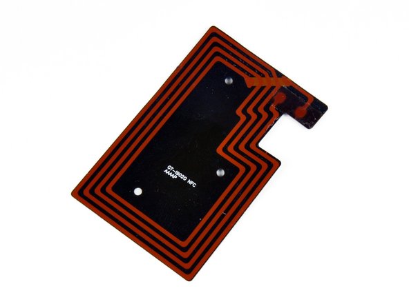

    • The entire back cover comes right off without a fuss, giving us a first glimpse of the battery.
    • We used a plastic opening tool to peel the NFC antenna module off the back cover. According to Google: "Nexus S can read information from 'smart' tags, or everyday objects that have NFC chips in them. These can be anything from stickers and movie posters to t-shirts."
    • Looks like something straight out of Tron: Legacy.

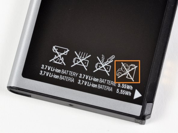

    • The battery is extremely easy to remove and comes out next.
    • The 3.7 V, 5.55 Watt-hours Lithium ion cell provides up to 6.7 hours of talk time on a 3G network, and up to 14 hours on a 2G network.
    • The battery inside the Nexus S is rated at 1500 mAh. That's slightly higher than the 1400 mAh rating of the Nexus One's battery.
    • Don't feed this battery to a baby.

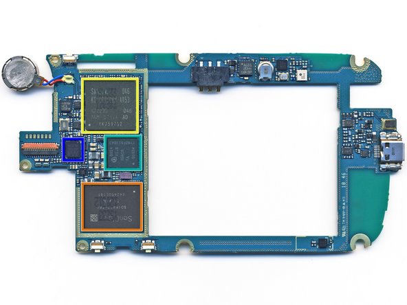

    • Taking out the motherboard requires removing three Phillips screws and disconnecting a few cables here and there.
    • The design of the motherboard is peculiar to us. It is designed such that its inner perimeter encloses the battery. We've seen oddly-shaped PCBs before, but rarely do they have giant holes in the middle of them.

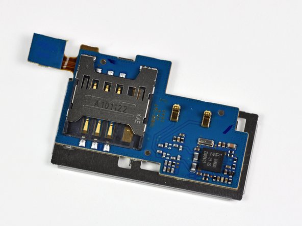

  7. Nexus S Teardown: crwdns2935265:07crwdnd2935265:01crwdnd2935265:02crwdne2935265:0 Nexus S Teardown: crwdns2935265:07crwdnd2935265:02crwdnd2935265:02crwdne2935265:0
    • A handy plastic opening tool helps separate the SIM card reader from the rest of the motherboard.
    • The Nexus S is unlocked right out of the box and can be used with a Quad-band (850, 900, 1800, 1900) GSM carrier and is Tri-band HSPA (900, 2100, 1700) compatible.
    • For you AT&T customers out there, just a quick reminder that the Nexus S does not support the 850 MHz and 1900 MHz HSPA frequency bands required for 3G mobile data.

  10. Nexus S Teardown: crwdns2935265:010crwdnd2935265:01crwdnd2935265:02crwdne2935265:0 Nexus S Teardown: crwdns2935265:010crwdnd2935265:02crwdnd2935265:02crwdne2935265:0
    • Big players on the motherboard include:
    • Skyworks SKY77529 Tx Front-End Module for Dual-Band GSM / GPRS / EDGE
    • SanDisk SDIN4C2 16GB MLC NAND flash.
    • Samsung KB100D00WM-A453 memory package and S5PC110A01 1GHz Cortex A8 Hummingbird Processor.
    • Infineon 8824 XG616 X-Gold baseband processor
    • Wolfson Microelectronics WM8994 ultra-low power audio codec.

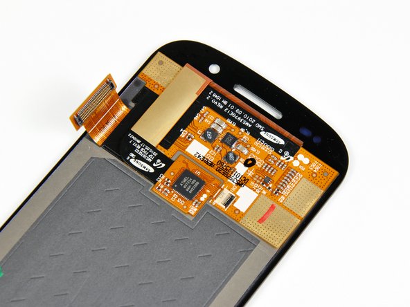

  13. Nexus S Teardown: crwdns2935265:013crwdnd2935265:01crwdnd2935265:02crwdne2935265:0 Nexus S Teardown: crwdns2935265:013crwdnd2935265:02crwdnd2935265:02crwdne2935265:0
    • Here you can see a side view of the Super AMOLED display and front glass panel.
    • The Super AMOLED is attached to the front glass. The digitizer is a PET layer between the glass and the display.
    • You can definitely see that only the front glass panel is curved. The rest of the components are flat as a board, just as any other phone on the market.
    • Google describes it as a "...curved glass screen...", however that may be misconstrued to mean a curved Super AMOLED display, which is a bit misleading.
    • There's also a small PCB on the back of the display with an Atmel MXT224 touchscreen controller on it.
