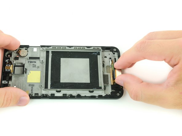

    1. Nexus 5X LCD Screen & Digitizer Replacement, LCD Screen & Digitizer: crwdns2935265:019crwdnd2935265:01crwdnd2935265:03crwdne2935265:0 Nexus 5X LCD Screen & Digitizer Replacement, LCD Screen & Digitizer: crwdns2935265:019crwdnd2935265:02crwdnd2935265:03crwdne2935265:0 Nexus 5X LCD Screen & Digitizer Replacement, LCD Screen & Digitizer: crwdns2935265:019crwdnd2935265:03crwdnd2935265:03crwdne2935265:0
      • Use an iOpener or a heat gun over the digitizer ribbon cable to soften the adhesive that secures it to the plastic housing.
      • The Nexus 5X pictured here does not have a layer of shielding tape over the digitizer panel. If this tape is present on your device, simply peel it away from the plastic frame to free the digitizer panel.
      • You'll need to transfer or replace this strip of shielding tape when you install your new screen.
      • Gently wedge the flat end of a spudger into the gap between the battery housing and the digitizer ribbon cable, or use your fingers to gently pull the digitizer ribbon cable free.

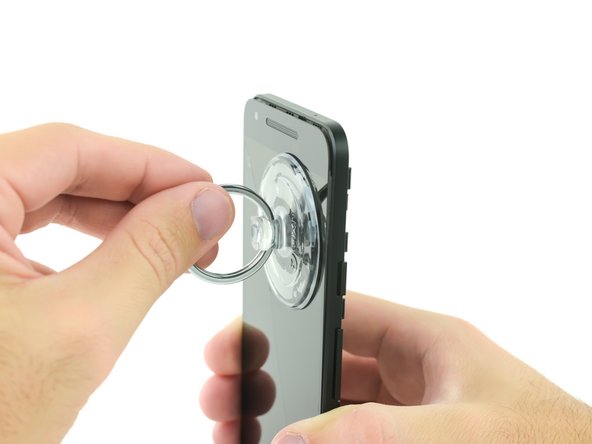

    3. Nexus 5X LCD Screen & Digitizer Replacement: crwdns2935265:021crwdnd2935265:01crwdnd2935265:02crwdne2935265:0 Nexus 5X LCD Screen & Digitizer Replacement: crwdns2935265:021crwdnd2935265:02crwdnd2935265:02crwdne2935265:0
      • Use a suction cup and firmly pull the screen away from the frame to create a small gap.
      • This should not require excessive force. Apply additional heat as needed to soften the screen adhesive.

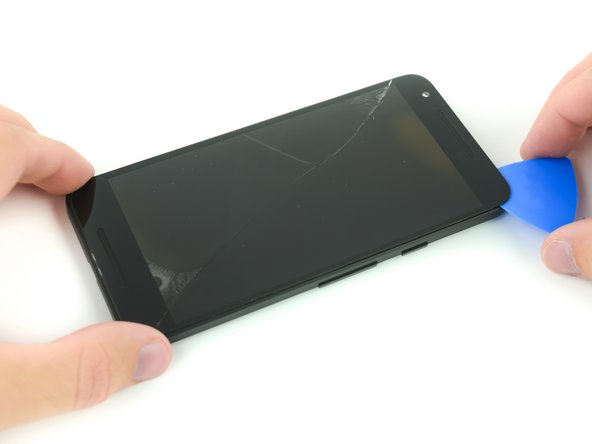

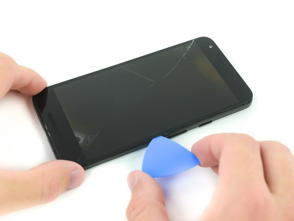

    4. Nexus 5X LCD Screen & Digitizer Replacement: crwdns2935265:022crwdnd2935265:01crwdnd2935265:03crwdne2935265:0 Nexus 5X LCD Screen & Digitizer Replacement: crwdns2935265:022crwdnd2935265:02crwdnd2935265:03crwdne2935265:0 Nexus 5X LCD Screen & Digitizer Replacement: crwdns2935265:022crwdnd2935265:03crwdnd2935265:03crwdne2935265:0
      iFixit Opening Picks (Set of 6)
      $4.95
      • Insert a plastic opening pick into the gap between the screen and the plastic housing.
      • Slide the plastic opening pick along the border of the screen to free the screen from any remaining adhesive.

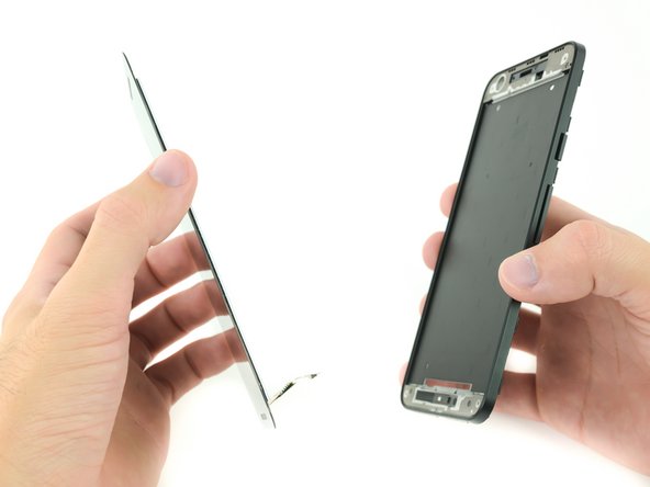

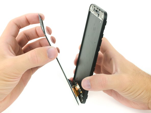

    5. Nexus 5X LCD Screen & Digitizer Replacement: crwdns2935265:023crwdnd2935265:01crwdnd2935265:03crwdne2935265:0 Nexus 5X LCD Screen & Digitizer Replacement: crwdns2935265:023crwdnd2935265:02crwdnd2935265:03crwdne2935265:0 Nexus 5X LCD Screen & Digitizer Replacement: crwdns2935265:023crwdnd2935265:03crwdnd2935265:03crwdne2935265:0
      • Remove the LCD screen & digitizer assembly.
      • Gently feed the digitizer ribbon cable through the frame.
      • Transfer your earpiece and speaker mesh to your new screen.
