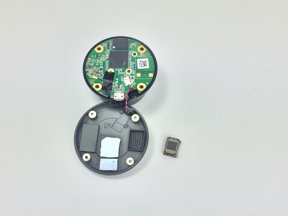

    • Remove the four 6 mm screws from the back panel with the J000 Phillips head screwdriver.
    • We suggest designated areas to keep track of all screws.

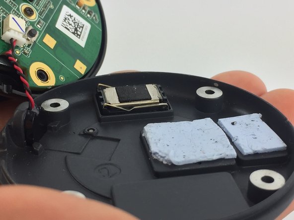

  2. Nest Cam Speaker Replacement: crwdns2935265:02crwdnd2935265:01crwdnd2935265:01crwdne2935265:0
    • Open the back panel completely to expose the speaker indicated by the red circle.
  3. Nest Cam Speaker Replacement: crwdns2935265:03crwdnd2935265:01crwdnd2935265:03crwdne2935265:0 Nest Cam Speaker Replacement: crwdns2935265:03crwdnd2935265:02crwdnd2935265:03crwdne2935265:0 Nest Cam Speaker Replacement: crwdns2935265:03crwdnd2935265:03crwdnd2935265:03crwdne2935265:0
    • Remove old speaker gently with a spudger.
    • When placing the new speaker in make sure the prongs are facing the right direction and will connect with the two connector points on the motherboard.

I’m curious as well if anyone has found where to obtain replacement/repair parts. Should be simple enough if we can determine the part number of the speaker.. suppose I’ll tear one down real quick to see.
Christopher Monge - crwdns2934203:0crwdne2934203:0
Looking at the speaker without thermal coverings looks like it just has some sound information. “8 ohm 0.5 w”. Next line, “1742 (space) 1”. Third line, “+ S -”.
Looks like electrical info of the speaker. I’ll keep looking!
