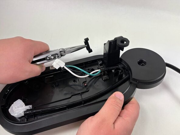

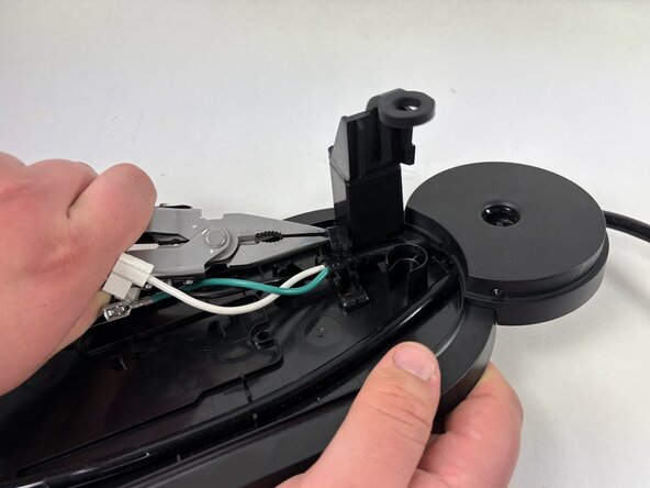

  5. Nespresso Vertuo Next Power Cord Replacement, Power Cord: crwdns2935265:05crwdnd2935265:01crwdnd2935265:03crwdne2935265:0 Nespresso Vertuo Next Power Cord Replacement, Power Cord: crwdns2935265:05crwdnd2935265:02crwdnd2935265:03crwdne2935265:0 Nespresso Vertuo Next Power Cord Replacement, Power Cord: crwdns2935265:05crwdnd2935265:03crwdnd2935265:03crwdne2935265:0
    • Use needle nose plies to remove the panel.
    • Turn base plate over and remove the plastic piece that held the power cord's wires.

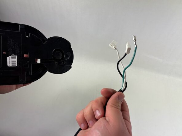

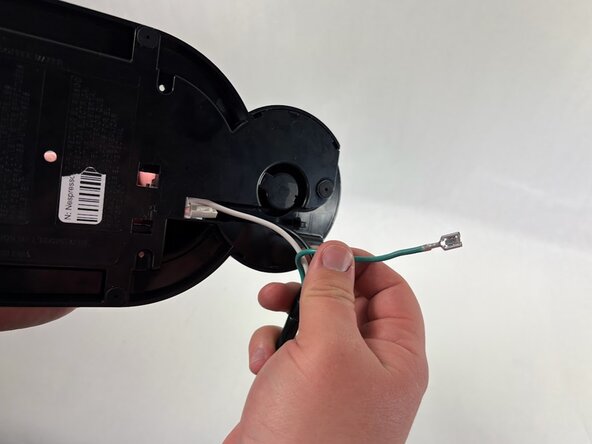

  6. Nespresso Vertuo Next Power Cord Replacement: crwdns2935265:06crwdnd2935265:01crwdnd2935265:03crwdne2935265:0 Nespresso Vertuo Next Power Cord Replacement: crwdns2935265:06crwdnd2935265:02crwdnd2935265:03crwdne2935265:0 Nespresso Vertuo Next Power Cord Replacement: crwdns2935265:06crwdnd2935265:03crwdnd2935265:03crwdne2935265:0
    • Pull wires and power cord out through the bottom of the base plate.
    • Pull one wire out at a time to avoid any damage.
