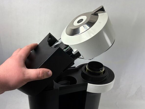

  1. Nespresso Vertuo Next Power Button Replacement, Power Button: crwdns2935265:01crwdnd2935265:01crwdnd2935265:02crwdne2935265:0 Nespresso Vertuo Next Power Button Replacement, Power Button: crwdns2935265:01crwdnd2935265:02crwdnd2935265:02crwdne2935265:0
    • Side an opening tool in between where the top cover meets the white head piece and apply force to push the cover off.
    • Remove the cover from the device.

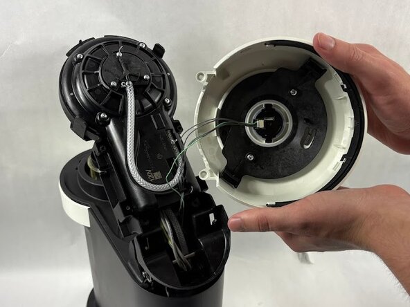

  2. Nespresso Vertuo Next Power Button Replacement: crwdns2935265:02crwdnd2935265:01crwdnd2935265:02crwdne2935265:0 Nespresso Vertuo Next Power Button Replacement: crwdns2935265:02crwdnd2935265:02crwdnd2935265:02crwdne2935265:0
    • Use a T19 Torx screwdriver to remove the white top cover of the machine.
    • While pulling away the top cover, ensure that you don't pull out any wires or other parts.

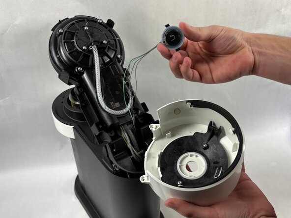

  3. Nespresso Vertuo Next Power Button Replacement: crwdns2935265:03crwdnd2935265:01crwdnd2935265:02crwdne2935265:0 Nespresso Vertuo Next Power Button Replacement: crwdns2935265:03crwdnd2935265:02crwdnd2935265:02crwdne2935265:0
    • Pop out the power button by pressing your thumb on the button and pressing down.

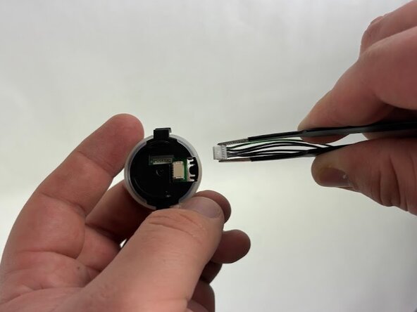

  4. Nespresso Vertuo Next Power Button Replacement: crwdns2935265:04crwdnd2935265:01crwdnd2935265:02crwdne2935265:0 Nespresso Vertuo Next Power Button Replacement: crwdns2935265:04crwdnd2935265:02crwdnd2935265:02crwdne2935265:0
    • Use tweezers to unplug the wires from the power button.
    • Apply slight force and carefully pull the wire out as to not damage any pins.
