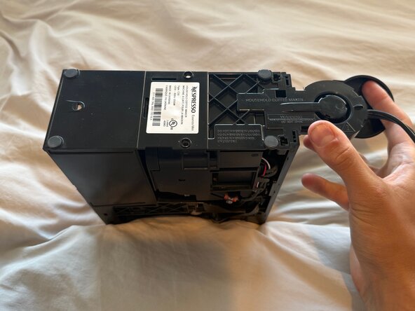

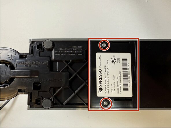

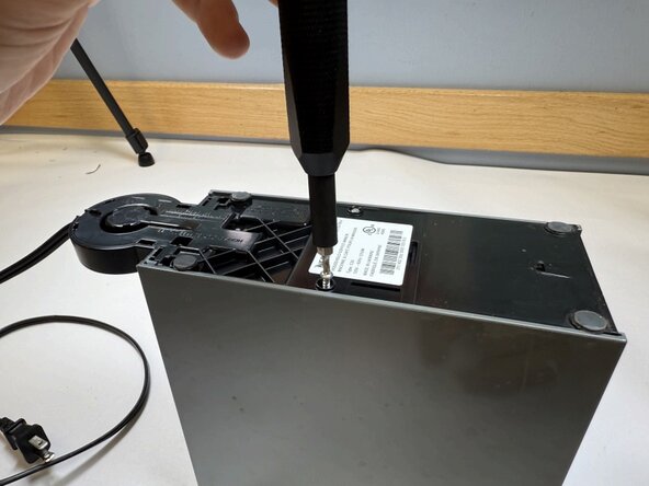

    • Locate panel on the bottom of the machine
    • Unscrew both screws with a T10 star head screwdriver
  3. Nespresso Essenza Mini Coffee Machine Button Board Replacement: crwdns2935265:03crwdnd2935265:01crwdnd2935265:03crwdne2935265:0 Nespresso Essenza Mini Coffee Machine Button Board Replacement: crwdns2935265:03crwdnd2935265:02crwdnd2935265:03crwdne2935265:0 Nespresso Essenza Mini Coffee Machine Button Board Replacement: crwdns2935265:03crwdnd2935265:03crwdnd2935265:03crwdne2935265:0
    • Remove the cover to expose the internals of the machine.

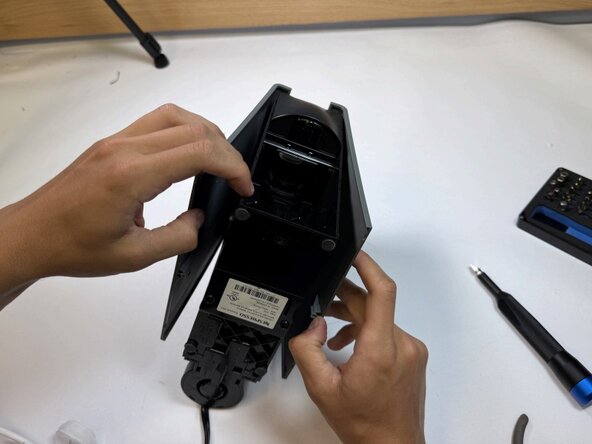

  4. Nespresso Essenza Mini Coffee Machine Button Board Replacement: crwdns2935265:04crwdnd2935265:01crwdnd2935265:03crwdne2935265:0 Nespresso Essenza Mini Coffee Machine Button Board Replacement: crwdns2935265:04crwdnd2935265:02crwdnd2935265:03crwdne2935265:0 Nespresso Essenza Mini Coffee Machine Button Board Replacement: crwdns2935265:04crwdnd2935265:03crwdnd2935265:03crwdne2935265:0
    • Push opening tool into the release tabs located on the bottom of the machine
    • Remove the cover

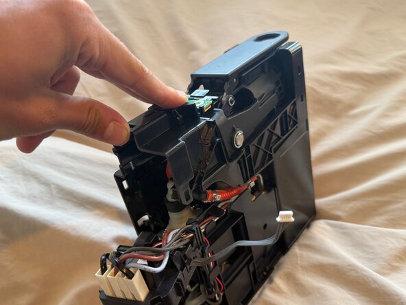

  5. Nespresso Essenza Mini Coffee Machine Button Board Replacement: crwdns2935265:05crwdnd2935265:01crwdnd2935265:02crwdne2935265:0 Nespresso Essenza Mini Coffee Machine Button Board Replacement: crwdns2935265:05crwdnd2935265:02crwdnd2935265:02crwdne2935265:0

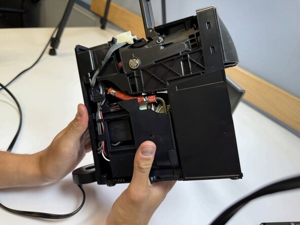

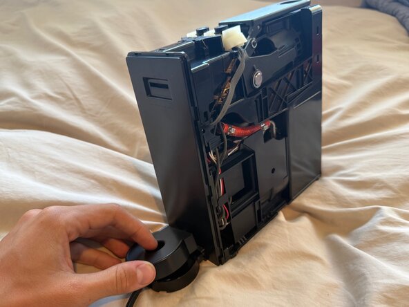

    • Push opening tool into release tabs located on the sides and top of the machine
    • Remove the cover to expose the pump and inner electrical parts
  6. Nespresso Essenza Mini Coffee Machine Button Board Replacement: crwdns2935265:06crwdnd2935265:01crwdnd2935265:02crwdne2935265:0 Nespresso Essenza Mini Coffee Machine Button Board Replacement: crwdns2935265:06crwdnd2935265:02crwdnd2935265:02crwdne2935265:0

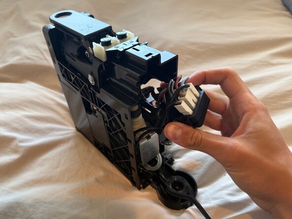

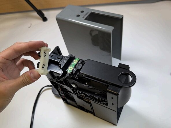

    • Locate main electrical board
    • Pull electrical board out of the way gently

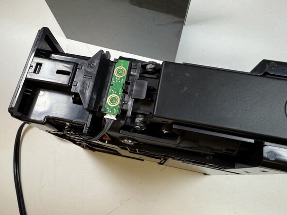

  7. Nespresso Essenza Mini Coffee Machine Button Board Replacement: crwdns2935265:07crwdnd2935265:01crwdnd2935265:03crwdne2935265:0 Nespresso Essenza Mini Coffee Machine Button Board Replacement: crwdns2935265:07crwdnd2935265:02crwdnd2935265:03crwdne2935265:0 Nespresso Essenza Mini Coffee Machine Button Board Replacement: crwdns2935265:07crwdnd2935265:03crwdnd2935265:03crwdne2935265:0

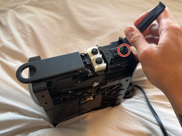

    • Locate buttons
    • Remove button cover to expose button board

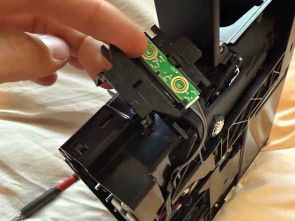

  8. Nespresso Essenza Mini Coffee Machine Button Board Replacement: crwdns2935265:08crwdnd2935265:01crwdnd2935265:02crwdne2935265:0 Nespresso Essenza Mini Coffee Machine Button Board Replacement: crwdns2935265:08crwdnd2935265:02crwdnd2935265:02crwdne2935265:0
    • Use opening tool to push the two locking tabs inside the machine, releasing the button board
    • Remove the button board from the machine
  9. Nespresso Essenza Mini Coffee Machine Button Board Replacement: crwdns2935265:09crwdnd2935265:01crwdnd2935265:02crwdne2935265:0 Nespresso Essenza Mini Coffee Machine Button Board Replacement: crwdns2935265:09crwdnd2935265:02crwdnd2935265:02crwdne2935265:0
    • Get new button board and fit it in place of the old one

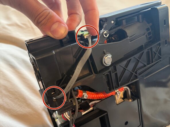

  10. Nespresso Essenza Mini Coffee Machine Button Board Replacement: crwdns2935265:010crwdnd2935265:01crwdnd2935265:02crwdne2935265:0 Nespresso Essenza Mini Coffee Machine Button Board Replacement: crwdns2935265:010crwdnd2935265:02crwdnd2935265:02crwdne2935265:0
    • Connect the wire from the energy box to the new button board
