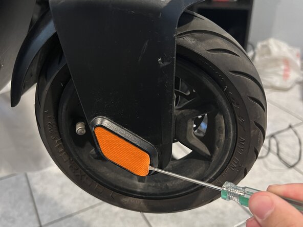

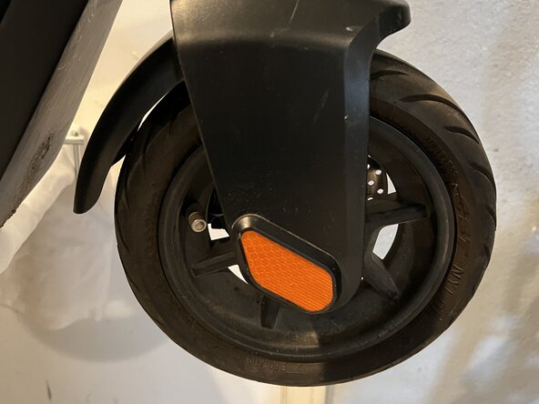

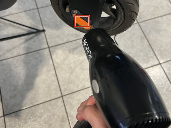

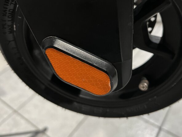

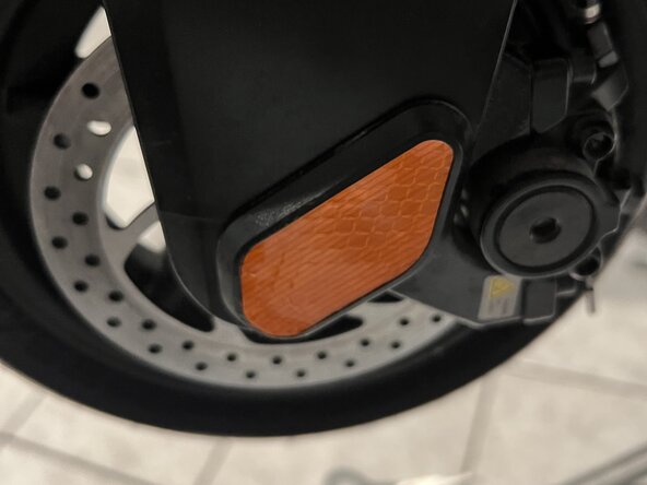

    • Set the scooter down on its side or use the kickstand to keep it from falling while you work.
    • Locate the right sticker on the front tire and then start blowing hot air using a hair dryer to conserve the glue.

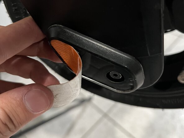

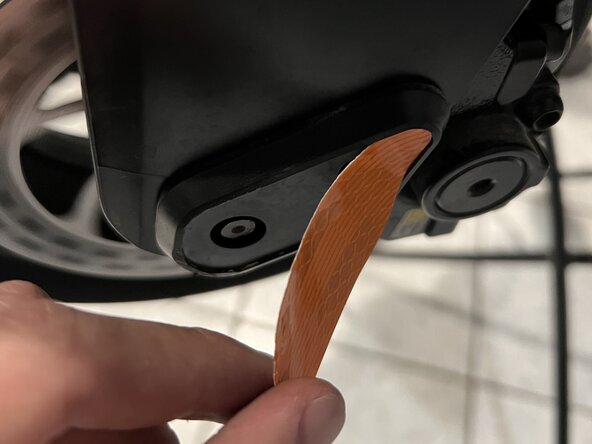

  2. NIU KQi3 Pro Electric Scooter Front Tire Replacement: crwdns2935265:02crwdnd2935265:01crwdnd2935265:02crwdne2935265:0 NIU KQi3 Pro Electric Scooter Front Tire Replacement: crwdns2935265:02crwdnd2935265:02crwdnd2935265:02crwdne2935265:0
    • Use an opening tool to remove the light reflector sticker from the outside and inside of the axle.
    • Repeat for the inside of the axle.

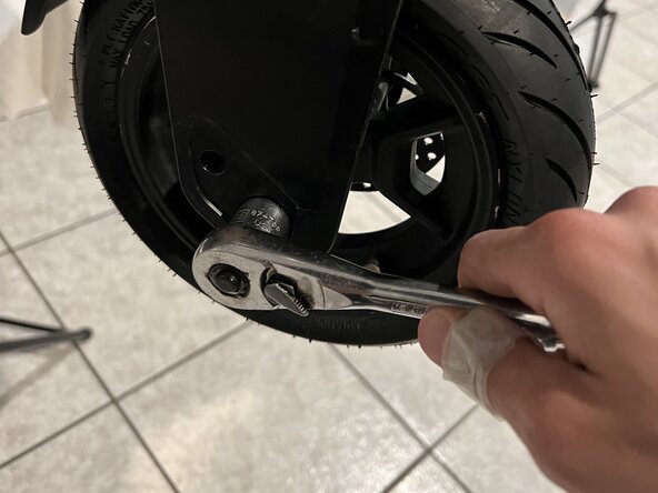

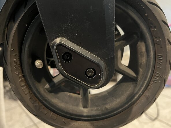

  3. NIU KQi3 Pro Electric Scooter Front Tire Replacement: crwdns2935265:03crwdnd2935265:01crwdnd2935265:02crwdne2935265:0 NIU KQi3 Pro Electric Scooter Front Tire Replacement: crwdns2935265:03crwdnd2935265:02crwdnd2935265:02crwdne2935265:0
    • Use a 3 mm hex key to remove the screws from both sides of the axle.

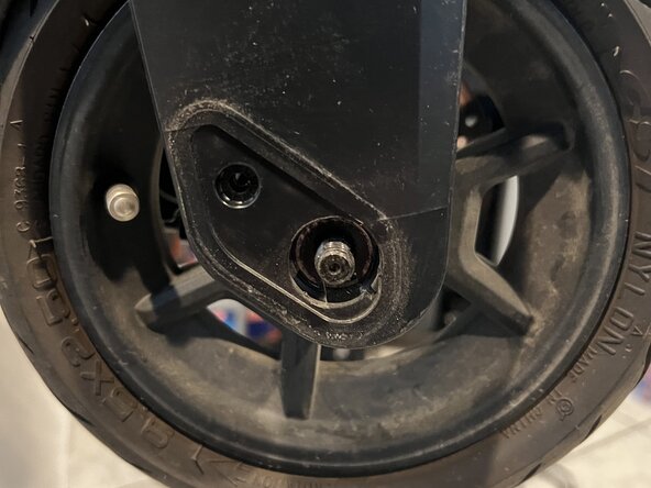

  4. NIU KQi3 Pro Electric Scooter Front Tire Replacement: crwdns2935265:04crwdnd2935265:01crwdnd2935265:02crwdne2935265:0 NIU KQi3 Pro Electric Scooter Front Tire Replacement: crwdns2935265:04crwdnd2935265:02crwdnd2935265:02crwdne2935265:0

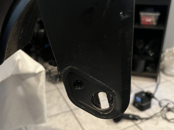

    • Remove the casing.
    • Use a 15 mm socket wrench to remove the bolt from underneath the casing.
    • Repeat on the opposite side of the axle.

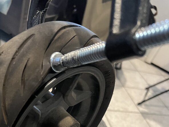

  5. NIU KQi3 Pro Electric Scooter Front Tire Replacement: crwdns2935265:05crwdnd2935265:01crwdnd2935265:02crwdne2935265:0 NIU KQi3 Pro Electric Scooter Front Tire Replacement: crwdns2935265:05crwdnd2935265:02crwdnd2935265:02crwdne2935265:0
    • Remove the wheel from the scooter.

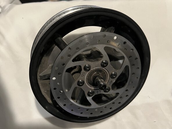

  6. NIU KQi3 Pro Electric Scooter Front Tire Replacement: crwdns2935265:06crwdnd2935265:01crwdnd2935265:02crwdne2935265:0 NIU KQi3 Pro Electric Scooter Front Tire Replacement: crwdns2935265:06crwdnd2935265:02crwdnd2935265:02crwdne2935265:0

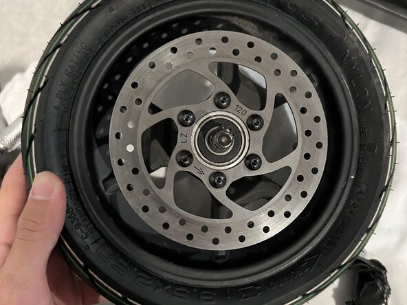

    • Heres a photo of both sides of the wheel you removed.

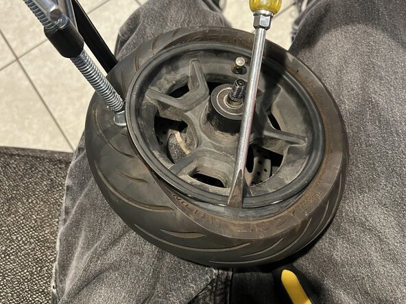

  7. NIU KQi3 Pro Electric Scooter Front Tire Replacement: crwdns2935265:07crwdnd2935265:01crwdnd2935265:03crwdne2935265:0 NIU KQi3 Pro Electric Scooter Front Tire Replacement: crwdns2935265:07crwdnd2935265:02crwdnd2935265:03crwdne2935265:0 NIU KQi3 Pro Electric Scooter Front Tire Replacement: crwdns2935265:07crwdnd2935265:03crwdnd2935265:03crwdne2935265:0
    • Now, you’ll need your clamp to squeeze around the tire in order to take it off rims bead.
    • After, You’ll need two strong flat head screwdrivers to start removing the tire off the rim while the clamp is still on, as shown in the third photo.

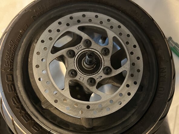

  8. NIU KQi3 Pro Electric Scooter Front Tire Replacement: crwdns2935265:08crwdnd2935265:01crwdnd2935265:02crwdne2935265:0 NIU KQi3 Pro Electric Scooter Front Tire Replacement: crwdns2935265:08crwdnd2935265:02crwdnd2935265:02crwdne2935265:0
    • Hears a photo of both sides of the rim after removing the tire.

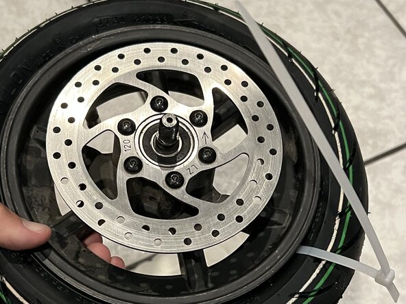

  9. NIU KQi3 Pro Electric Scooter Front Tire Replacement: crwdns2935265:09crwdnd2935265:01crwdnd2935265:02crwdne2935265:0 NIU KQi3 Pro Electric Scooter Front Tire Replacement: crwdns2935265:09crwdnd2935265:02crwdnd2935265:02crwdne2935265:0

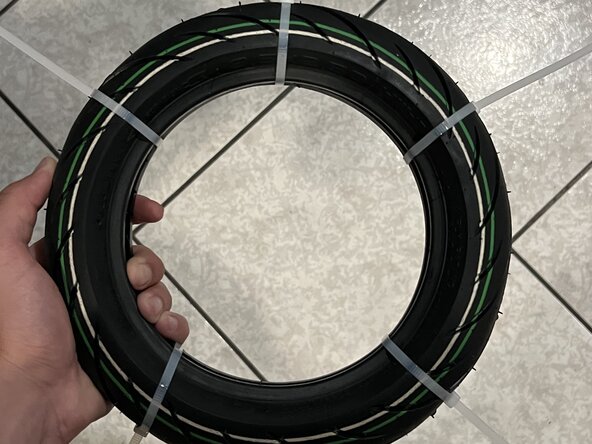

    • Get your replacement tire which is a 9.5x2.50 vacuum tire.
    • You will now squeeze the tire all around while adding zip ties so it can stay in place like I did in the second photo.

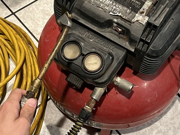

  11. NIU KQi3 Pro Electric Scooter Front Tire Replacement: crwdns2935265:011crwdnd2935265:01crwdnd2935265:02crwdne2935265:0 NIU KQi3 Pro Electric Scooter Front Tire Replacement: crwdns2935265:011crwdnd2935265:02crwdnd2935265:02crwdne2935265:0
    • I used a 150 psi compressor because you’ll need a lot of pressure to pop the tire back on to the rims bead.
  12. NIU KQi3 Pro Electric Scooter Front Tire Replacement: crwdns2935265:012crwdnd2935265:01crwdnd2935265:02crwdne2935265:0 NIU KQi3 Pro Electric Scooter Front Tire Replacement: crwdns2935265:012crwdnd2935265:02crwdnd2935265:02crwdne2935265:0
    • After turning on the compressor let it build pressure for a couple minutes to insure it has enough pressure built up to inflate the tire completely and on to the bead.

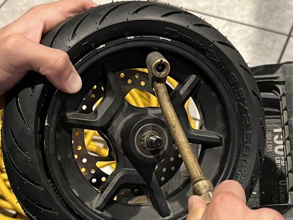

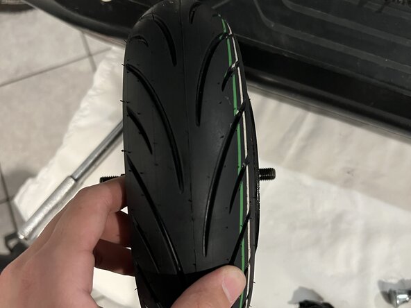

  13. NIU KQi3 Pro Electric Scooter Front Tire Replacement: crwdns2935265:013crwdnd2935265:01crwdnd2935265:03crwdne2935265:0 NIU KQi3 Pro Electric Scooter Front Tire Replacement: crwdns2935265:013crwdnd2935265:02crwdnd2935265:03crwdne2935265:0 NIU KQi3 Pro Electric Scooter Front Tire Replacement: crwdns2935265:013crwdnd2935265:03crwdnd2935265:03crwdne2935265:0
    • Here is the replacement tire completely inflated

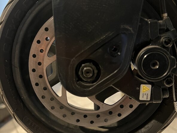

  14. NIU KQi3 Pro Electric Scooter Front Tire Replacement: crwdns2935265:014crwdnd2935265:01crwdnd2935265:02crwdne2935265:0 NIU KQi3 Pro Electric Scooter Front Tire Replacement: crwdns2935265:014crwdnd2935265:02crwdnd2935265:02crwdne2935265:0
    • Put the wheel back on the scooter using a fifteen-millimeter socket wrench and tighten the bolt on both sides.
