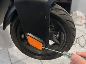

Use an opening tool to remove the light reflector sticker from the outside and inside of the axle.
Repeat for the inside of the axle.
