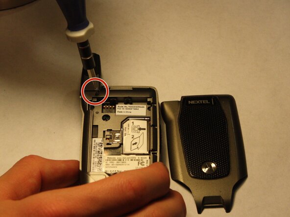

    • Locate the screw on the top left portion of the phone; just below the antenna. Using a T4 Torx screwdriver remove the screw.

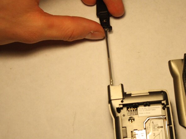

    • Slide antenna out of the phone.
    • Ensure that the protective plastic sleeve is not lost in removal.
