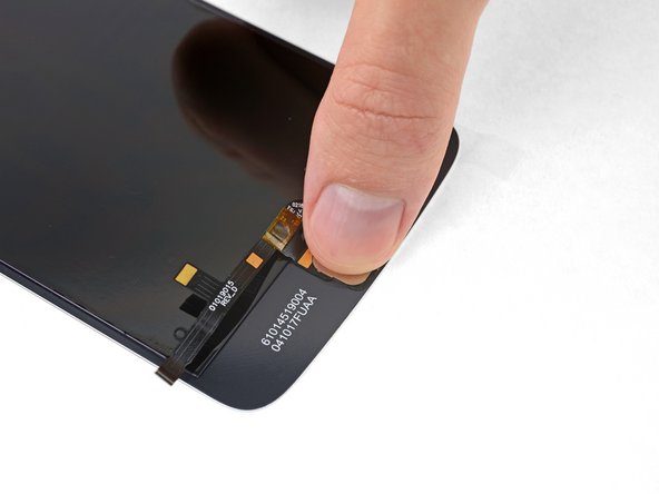

      • Apply heat for 2-3 minutes to the bezel area below the display on your old display assembly, in order to soften the adhesive securing the fingerprint sensor.
    2. Motorola Moto Z Play Screen Replacement: crwdns2935265:021crwdnd2935265:01crwdnd2935265:02crwdne2935265:0 Motorola Moto Z Play Screen Replacement: crwdns2935265:021crwdnd2935265:02crwdnd2935265:02crwdne2935265:0
      • Using your finger, press firmly on the outward-facing side of the fingerprint sensor until it separates from the display assembly.

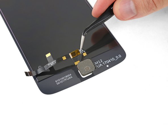

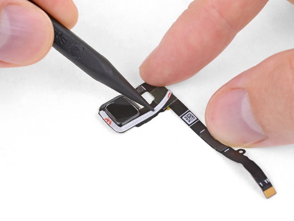

    3. Motorola Moto Z Play Screen Replacement: crwdns2935265:022crwdnd2935265:01crwdnd2935265:02crwdne2935265:0 Motorola Moto Z Play Screen Replacement: crwdns2935265:022crwdnd2935265:02crwdnd2935265:02crwdne2935265:0
      • Slide an opening pick underneath the fingerprint sensor's flex cable, and carefully cut through the adhesive securing it in place.
      • Be careful not to damage the flex cable. If necessary, apply more heat to further soften the adhesive.
    4. Motorola Moto Z Play Screen Replacement: crwdns2935265:023crwdnd2935265:01crwdnd2935265:01crwdne2935265:0
      • Remove the fingerprint sensor from the old display and set it aside.

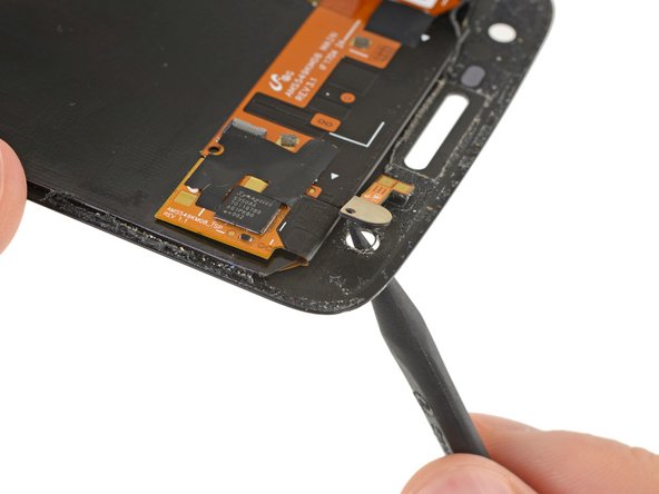

      • Apply heat for 2-3 minutes to the top bezel area above the display on your old display assembly, in order to soften the adhesive securing the front camera flash.
    6. Motorola Moto Z Play Screen Replacement: crwdns2935265:025crwdnd2935265:01crwdnd2935265:02crwdne2935265:0 Motorola Moto Z Play Screen Replacement: crwdns2935265:025crwdnd2935265:02crwdnd2935265:02crwdne2935265:0

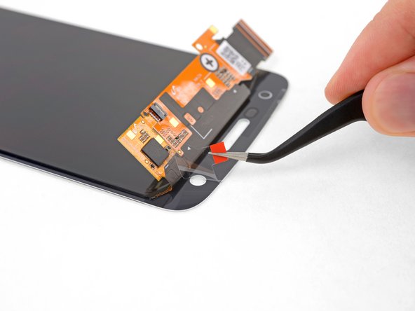

      • Use the point of a spudger to push the outward-facing side of the camera flash until it separates from the display assembly.
    7. Motorola Moto Z Play Screen Replacement: crwdns2935265:026crwdnd2935265:01crwdnd2935265:02crwdne2935265:0 Motorola Moto Z Play Screen Replacement: crwdns2935265:026crwdnd2935265:02crwdnd2935265:02crwdne2935265:0
      • Slide an opening pick underneath the flash flex cable, and carefully cut through the adhesive securing it in place.
      • Remove the front camera flash and set it aside.

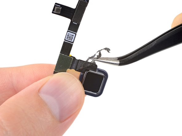

      • Carefully peel away and remove any remaining old adhesive from the fingerprint sensor.

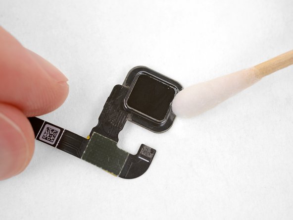

      • For best results, clean the adhered areas with isopropyl alcohol to help prep the surface for the new adhesive.
    9. Motorola Moto Z Play Screen Replacement: crwdns2935265:028crwdnd2935265:01crwdnd2935265:01crwdne2935265:0

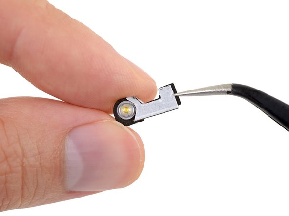

      • Remove any remaining adhesive from the flash assembly as well. If desired, clean it thoroughly with isopropyl alcohol.

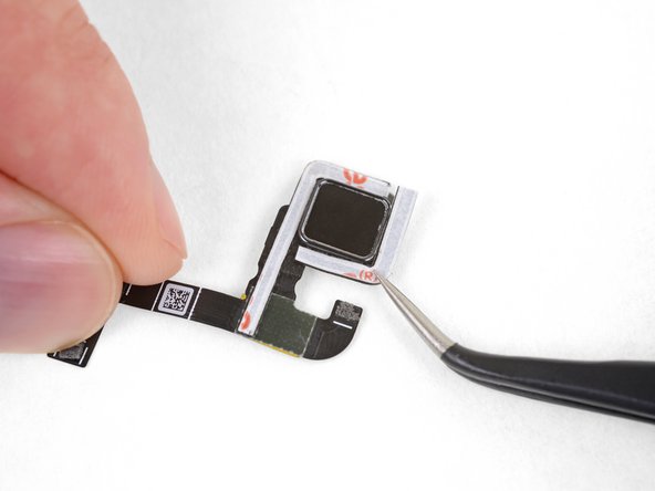

    10. Motorola Moto Z Play Screen Replacement: crwdns2935265:029crwdnd2935265:01crwdnd2935265:03crwdne2935265:0 Motorola Moto Z Play Screen Replacement: crwdns2935265:029crwdnd2935265:02crwdnd2935265:03crwdne2935265:0 Motorola Moto Z Play Screen Replacement: crwdns2935265:029crwdnd2935265:03crwdnd2935265:03crwdne2935265:0
      • Cut two pieces of L-shaped double-sided adhesive tape, and stick them firmly to the perimeter of the fingerprint sensor as shown.

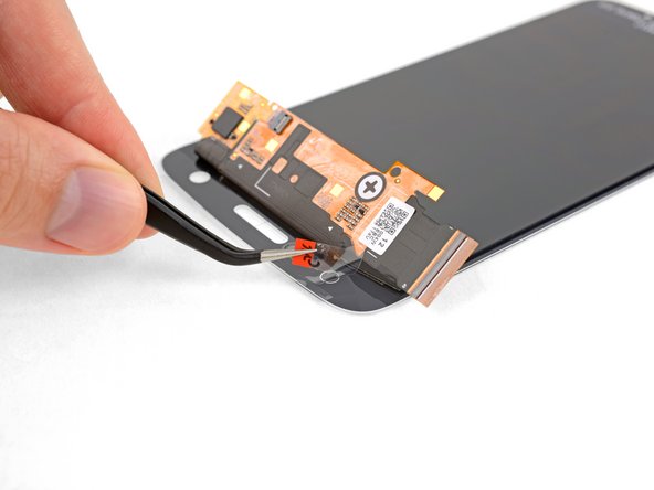

    11. Motorola Moto Z Play Screen Replacement: crwdns2935265:030crwdnd2935265:01crwdnd2935265:02crwdne2935265:0 Motorola Moto Z Play Screen Replacement: crwdns2935265:030crwdnd2935265:02crwdnd2935265:02crwdne2935265:0
      • Use the flash assembly and a fine-point pen or marker to trace out an appropriately-sized piece of double-sided adhesive tape.
      • Cut the tape to about the right size and shape and apply it to the front-facing side of the flash assembly.
