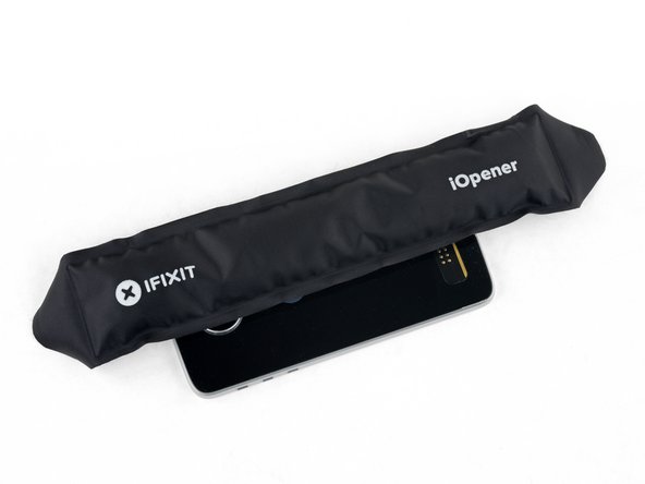

  2. Motorola Moto Z Play Battery Replacement: crwdns2935265:02crwdnd2935265:01crwdnd2935265:01crwdne2935265:0
    • Prepare an iOpener and heat the front of the phone along its left edge for about two minutes, or until it's slightly too hot to touch. This will help soften the adhesive securing the display.
    • You may need to reheat and reapply the iOpener several times to get the phone warm enough. Follow the iOpener instructions to avoid overheating.
    • A hair dryer, heat gun, or hot plate may also be used, but be careful not to overheat the phone—the display and internal battery are both susceptible to heat damage.

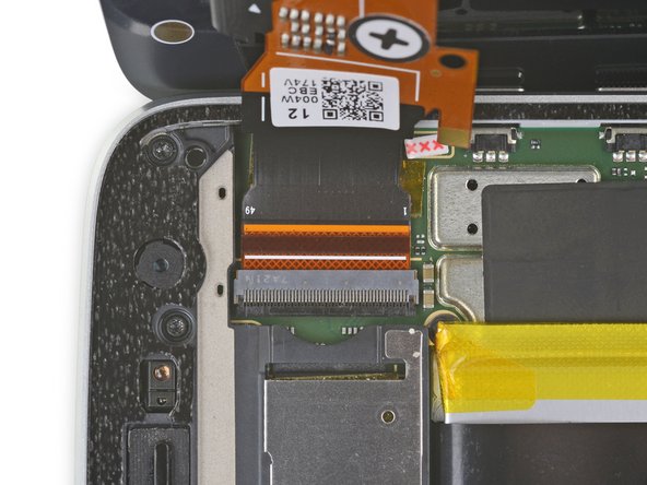

  15. Motorola Moto Z Play Battery Replacement: crwdns2935265:015crwdnd2935265:01crwdnd2935265:02crwdne2935265:0 Motorola Moto Z Play Battery Replacement: crwdns2935265:015crwdnd2935265:02crwdnd2935265:02crwdne2935265:0
    • While holding the display open, use the point of a spudger to pry up the locking tab on the fingerprint sensor cable's ZIF connector.
  16. Motorola Moto Z Play Battery Replacement: crwdns2935265:016crwdnd2935265:01crwdnd2935265:02crwdne2935265:0 Motorola Moto Z Play Battery Replacement: crwdns2935265:016crwdnd2935265:02crwdnd2935265:02crwdne2935265:0
    • At the opposite end of the phone, use your spudger to flip open the locking tab on the display cable connector.
  17. Motorola Moto Z Play Battery Replacement: crwdns2935265:017crwdnd2935265:01crwdnd2935265:02crwdne2935265:0 Motorola Moto Z Play Battery Replacement: crwdns2935265:017crwdnd2935265:02crwdnd2935265:02crwdne2935265:0
    • Gently pull the fingerprint sensor cable to slide it out of its socket, disconnecting it from the motherboard.
  18. Motorola Moto Z Play Battery Replacement: crwdns2935265:018crwdnd2935265:01crwdnd2935265:02crwdne2935265:0 Motorola Moto Z Play Battery Replacement: crwdns2935265:018crwdnd2935265:02crwdnd2935265:02crwdne2935265:0
    • Gently pull the display cable to slide it out of its socket on the motherboard.

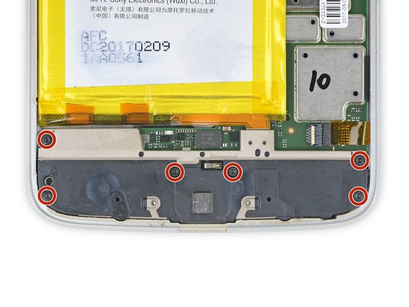

  20. Motorola Moto Z Play Battery Replacement, Battery: crwdns2935265:020crwdnd2935265:01crwdnd2935265:01crwdne2935265:0
    • Use a T3 Torx driver to remove the six 3.2 mm screws securing the lower cover.
  21. Motorola Moto Z Play Battery Replacement: crwdns2935265:021crwdnd2935265:01crwdnd2935265:02crwdne2935265:0 Motorola Moto Z Play Battery Replacement: crwdns2935265:021crwdnd2935265:02crwdnd2935265:02crwdne2935265:0
    • Pry up and remove the lower cover.
    • If you use a tool, don't pry against the battery or motherboard.

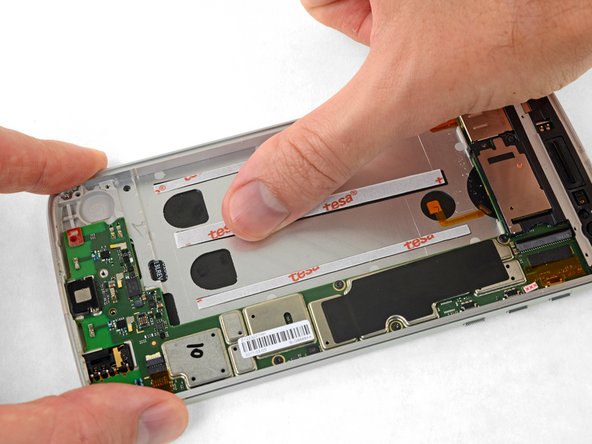

  27. Motorola Moto Z Play Battery Replacement: crwdns2935265:027crwdnd2935265:01crwdnd2935265:02crwdne2935265:0 Motorola Moto Z Play Battery Replacement: crwdns2935265:027crwdnd2935265:02crwdnd2935265:02crwdne2935265:0

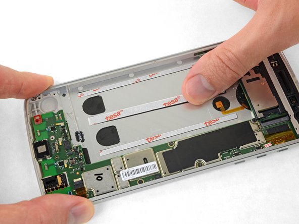

    • Before installing your new battery, peel up all the old adhesive and remove it from the phone.
    • For best results, clean the area underneath the battery with isopropyl alcohol and a lint-free cloth or coffee filter. This helps prep the surface so the new battery will adhere more strongly.
  28. Motorola Moto Z Play Battery Replacement: crwdns2935265:028crwdnd2935265:01crwdnd2935265:03crwdne2935265:0 Motorola Moto Z Play Battery Replacement: crwdns2935265:028crwdnd2935265:02crwdnd2935265:03crwdne2935265:0 Motorola Moto Z Play Battery Replacement: crwdns2935265:028crwdnd2935265:03crwdnd2935265:03crwdne2935265:0
    Tesa 61395 Tape
    $5.99
  29. Motorola Moto Z Play Battery Replacement: crwdns2935265:029crwdnd2935265:01crwdnd2935265:03crwdne2935265:0 Motorola Moto Z Play Battery Replacement: crwdns2935265:029crwdnd2935265:02crwdnd2935265:03crwdne2935265:0 Motorola Moto Z Play Battery Replacement: crwdns2935265:029crwdnd2935265:03crwdnd2935265:03crwdne2935265:0
    • Peel off the remaining film liners to expose the adhesive before pressing your new battery into place.
    • Carefully position the battery and press it firmly and evenly into the phone.
    • Connect the battery to the motherboard, and install the lower cover, including its six T3 Torx screws.

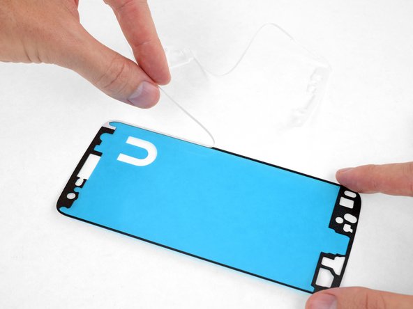

  31. Motorola Moto Z Play Battery Replacement: crwdns2935265:031crwdnd2935265:01crwdnd2935265:02crwdne2935265:0 Motorola Moto Z Play Battery Replacement: crwdns2935265:031crwdnd2935265:02crwdnd2935265:02crwdne2935265:0
    • Some pre-cut adhesive sheets for the display contain up to three layers: a plastic liner (usually blue), an adhesive layer in the middle (black), and a wax paper liner (white).
    • If yours came with a paper liner, peel it away and remove it.
  32. Motorola Moto Z Play Battery Replacement: crwdns2935265:032crwdnd2935265:01crwdnd2935265:03crwdne2935265:0 Motorola Moto Z Play Battery Replacement: crwdns2935265:032crwdnd2935265:02crwdnd2935265:03crwdne2935265:0 Motorola Moto Z Play Battery Replacement: crwdns2935265:032crwdnd2935265:03crwdnd2935265:03crwdne2935265:0
    • Peel off and discard any remaining paper liner, exposing the adhesive on one side.
    • Before you continue, the adhesive sheet should look like the third image.

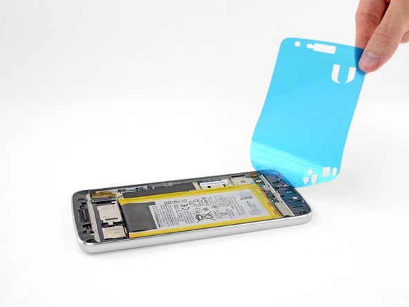

  34. Motorola Moto Z Play Battery Replacement: crwdns2935265:034crwdnd2935265:01crwdnd2935265:03crwdne2935265:0 Motorola Moto Z Play Battery Replacement: crwdns2935265:034crwdnd2935265:02crwdnd2935265:03crwdne2935265:0 Motorola Moto Z Play Battery Replacement: crwdns2935265:034crwdnd2935265:03crwdnd2935265:03crwdne2935265:0
    • Firmly press the adhesive into place.
    • Use the flat edge of your spudger to press along the edges and hard-to-reach areas.
    • Be very careful not to accidentally puncture the battery with your spudger.
  35. Motorola Moto Z Play Battery Replacement: crwdns2935265:035crwdnd2935265:01crwdnd2935265:02crwdne2935265:0 Motorola Moto Z Play Battery Replacement: crwdns2935265:035crwdnd2935265:02crwdnd2935265:02crwdne2935265:0
    • Peel off and discard the plastic liner, exposing the display adhesive.
  36. Motorola Moto Z Play Battery Replacement: crwdns2935265:036crwdnd2935265:01crwdnd2935265:02crwdne2935265:0 Motorola Moto Z Play Battery Replacement: crwdns2935265:036crwdnd2935265:02crwdnd2935265:02crwdne2935265:0
