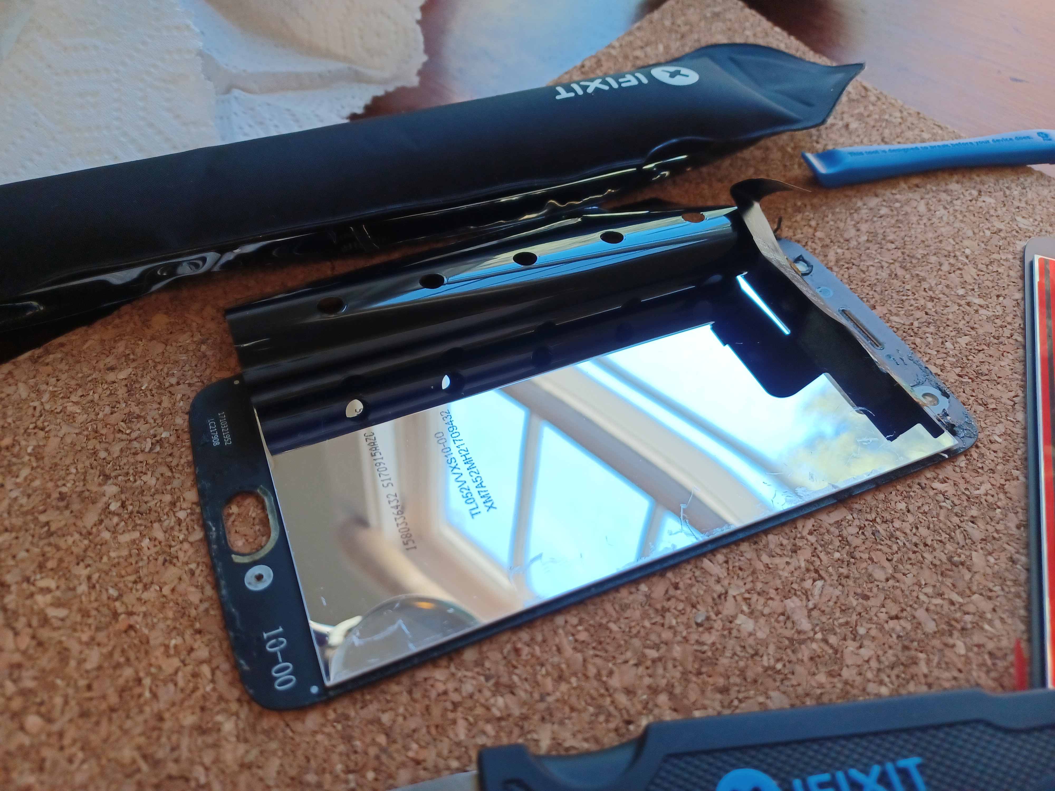

    I found that the subsequent steps will be smoother if you spend a little time at this point cleaning out the old adhesive pieces. The picture above shows pulling off some of the old glue strips, but the bullet points don’t mention it. Removing the mid-frame and other steps is easier if the old adhesive has been cleaned out.
    Gordon Bolt - crwdns2934203:0crwdne2934203:0
    Good point Gordon! I’ve adjusted the wording on the second bullet to point people in the right direction.
    Arthur Shi -

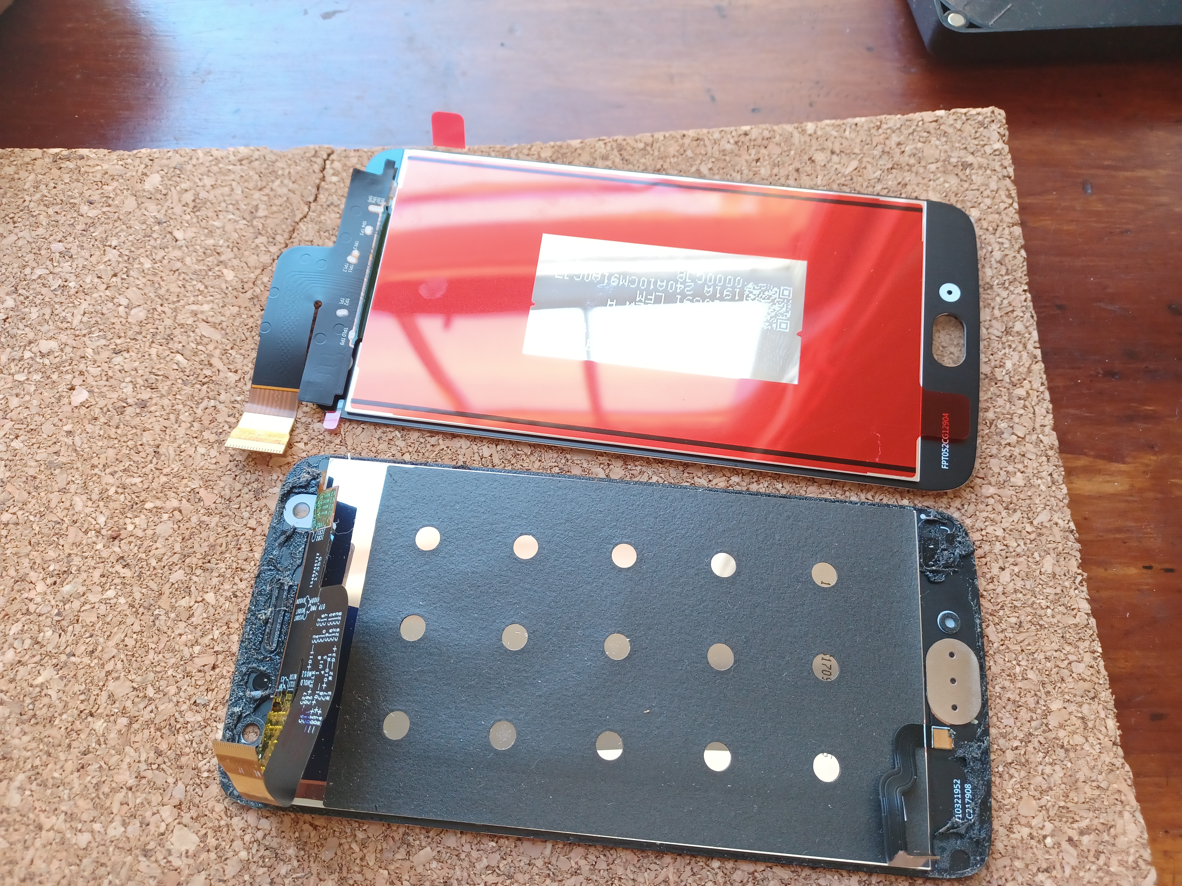

    The provided replacement screen does not have the black plastic film w/ 5 x 3 holes in it
    photo to illustrate: top is replacement screen. Bottom is old screen, w/ black film w/ holes
    Not sure how to proceed here.
    Etienne Grossmann - crwdns2934203:0crwdne2934203:0
