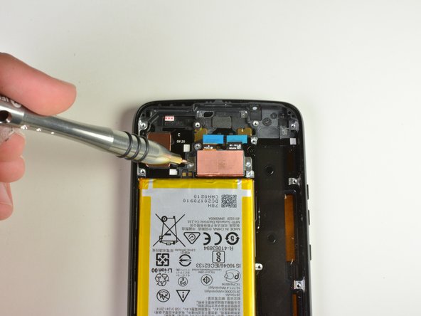

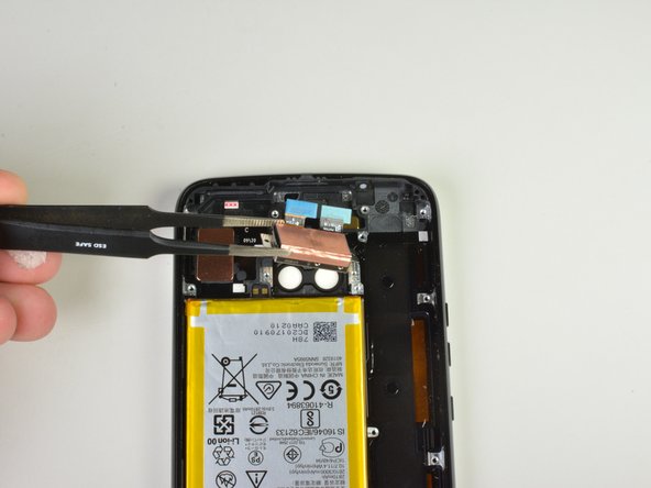

    After disconnecting the battery, there is 1x T3 (near the camera) and 2xT4 screws (near the headphone jack and usb port) that had to be removed, then the camera clips flipped up, then that board carefully removed (after ejecting the sim/memory cards) before being able to get to the two screws for the camera module.
    For reassembly, the camera cables had to be carefully held back while the board was repositioned.
    Steve Welander - crwdns2934203:0crwdne2934203:0
    Hi Steve,
    Thanks for the feedback! What you are describing sounds like the steps found in this guide. Can you see if anything is missing there? Thanks!
    Arthur Shi -
    Hi Arthur, I am doing this repair right now, and yes, this guide should have steps 21-25 from the linked guide inserted after step 20. Getting to the Rear Camera requires removing the motherboard, and indeed you can see in the pictures in what is currently Step 21 of this guide that the motherboard is removed (note the missing large silver rectangle in the upper-left, which is the SIM card tray, for instance, or any electronics in the upper-right)
    Joel Bradshaw - crwdns2934203:0crwdne2934203:0
    Although notably, the vibrating motor doesn’t have to be unplugged from the socket, just removed from the case along with the motherboard. I advise that, as the motor’s connection is very small and fragile.
  21. Motorola Moto X4 Rear Camera Replacement, Rear Camera: crwdns2935265:021crwdnd2935265:01crwdnd2935265:02crwdne2935265:0 Motorola Moto X4 Rear Camera Replacement, Rear Camera: crwdns2935265:021crwdnd2935265:02crwdnd2935265:02crwdne2935265:0
    • Using a T3 Torx screwdriver, remove both 1cm screws. To do this, insert the screwdriver into the head of the screw, then turn counter-clockwise.
  22. Motorola Moto X4 Rear Camera Replacement: crwdns2935265:022crwdnd2935265:01crwdnd2935265:02crwdne2935265:0 Motorola Moto X4 Rear Camera Replacement: crwdns2935265:022crwdnd2935265:02crwdnd2935265:02crwdne2935265:0
    • Use the tweezers to gently lift the rear camera up and out of your Moto X4.
