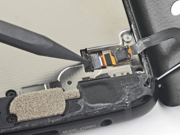

  9. Motorola Moto X4 Front-facing Camera Replacement, Detach the fingerprint sensor cable: crwdns2935265:09crwdnd2935265:01crwdnd2935265:02crwdne2935265:0 Motorola Moto X4 Front-facing Camera Replacement, Detach the fingerprint sensor cable: crwdns2935265:09crwdnd2935265:02crwdnd2935265:02crwdne2935265:0
    • Slide the point of a spudger underneath the fingerprint sensor cable and gently pry up to loosen the cable from the phone.
    • Do not pull on the cable. It is still attached to the phone by a delicate ZIF socket.

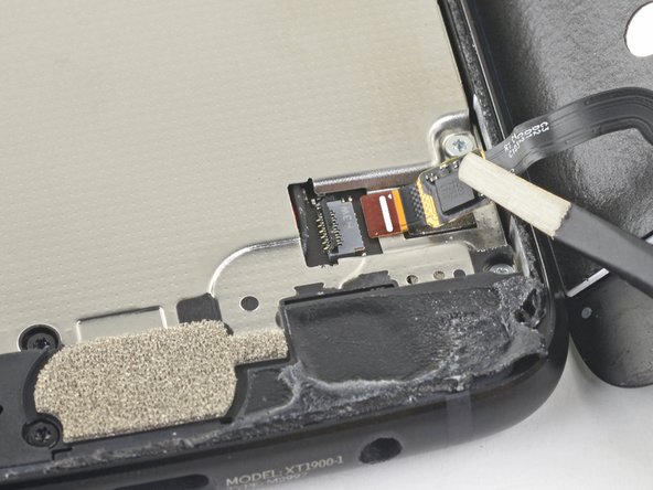

  10. Motorola Moto X4 Front-facing Camera Replacement, Disconnect the fingerprint sensor: crwdns2935265:010crwdnd2935265:01crwdnd2935265:03crwdne2935265:0 Motorola Moto X4 Front-facing Camera Replacement, Disconnect the fingerprint sensor: crwdns2935265:010crwdnd2935265:02crwdnd2935265:03crwdne2935265:0 Motorola Moto X4 Front-facing Camera Replacement, Disconnect the fingerprint sensor: crwdns2935265:010crwdnd2935265:03crwdnd2935265:03crwdne2935265:0
    • Use the point of a spudger to flip up the lock bar on the fingerprint sensor's ZIF socket, near the bottom right of the phone.
    • Use tweezers to carefully slide the fingerprint sensor cable out of the socket.

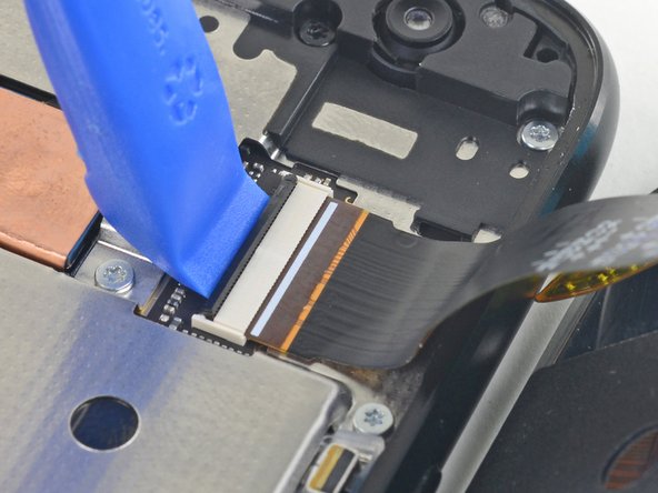

  11. Motorola Moto X4 Front-facing Camera Replacement, Disconnect the display cable: crwdns2935265:011crwdnd2935265:01crwdnd2935265:03crwdne2935265:0 Motorola Moto X4 Front-facing Camera Replacement, Disconnect the display cable: crwdns2935265:011crwdnd2935265:02crwdnd2935265:03crwdne2935265:0 Motorola Moto X4 Front-facing Camera Replacement, Disconnect the display cable: crwdns2935265:011crwdnd2935265:03crwdnd2935265:03crwdne2935265:0
    • Use an opening tool to flip up the wide lock bar on the display cable's ZIF socket, near the top right of the phone.
    • Use tweezers to carefully slide the display cable out of the ZIF socket.

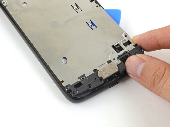

  14. Motorola Moto X4 Front-facing Camera Replacement, Loosen the midframe: crwdns2935265:014crwdnd2935265:01crwdnd2935265:03crwdne2935265:0 Motorola Moto X4 Front-facing Camera Replacement, Loosen the midframe: crwdns2935265:014crwdnd2935265:02crwdnd2935265:03crwdne2935265:0 Motorola Moto X4 Front-facing Camera Replacement, Loosen the midframe: crwdns2935265:014crwdnd2935265:03crwdnd2935265:03crwdne2935265:0
    • The next few steps show how to loosen the midframe clips.
    • Insert the flat end of a spudger under the right edge of the metal midframe and pry up to loosen the midframe.
    • Insert an opening pick in the edge to hold the midframe in place.

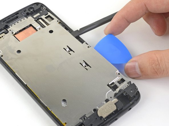

  15. Motorola Moto X4 Front-facing Camera Replacement: crwdns2935265:015crwdnd2935265:01crwdnd2935265:02crwdne2935265:0 Motorola Moto X4 Front-facing Camera Replacement: crwdns2935265:015crwdnd2935265:02crwdnd2935265:02crwdne2935265:0
    • Insert the flat end of a spudger under the lower right edge of the midframe and pry up to release the midframe clip.
  16. Motorola Moto X4 Front-facing Camera Replacement: crwdns2935265:016crwdnd2935265:01crwdnd2935265:03crwdne2935265:0 Motorola Moto X4 Front-facing Camera Replacement: crwdns2935265:016crwdnd2935265:02crwdnd2935265:03crwdne2935265:0 Motorola Moto X4 Front-facing Camera Replacement: crwdns2935265:016crwdnd2935265:03crwdnd2935265:03crwdne2935265:0
    • Grasp the lower edge of the midframe and pull the edge slightly to the right, to clear the metal midframe clip.

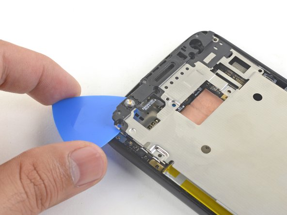

  17. Motorola Moto X4 Front-facing Camera Replacement: crwdns2935265:017crwdnd2935265:01crwdnd2935265:02crwdne2935265:0 Motorola Moto X4 Front-facing Camera Replacement: crwdns2935265:017crwdnd2935265:02crwdnd2935265:02crwdne2935265:0
    • Insert the point of an opening pick under the top left corner of the midframe and twist slightly to release the top clip.

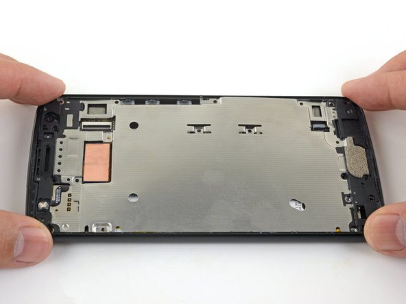

  18. Motorola Moto X4 Front-facing Camera Replacement, Remove the midframe: crwdns2935265:018crwdnd2935265:01crwdnd2935265:03crwdne2935265:0 Motorola Moto X4 Front-facing Camera Replacement, Remove the midframe: crwdns2935265:018crwdnd2935265:02crwdnd2935265:03crwdne2935265:0 Motorola Moto X4 Front-facing Camera Replacement, Remove the midframe: crwdns2935265:018crwdnd2935265:03crwdnd2935265:03crwdne2935265:0
    • Remove the midframe.
    • To reinstall the midframe:
    • Align the the midframe's top edge to the phone and press it into position.
    • Shift the bottom edge slightly to the left, to maneuver the left metal midframe clip underneath the phone edge.
    • Press the midframe's bottom edge into position.

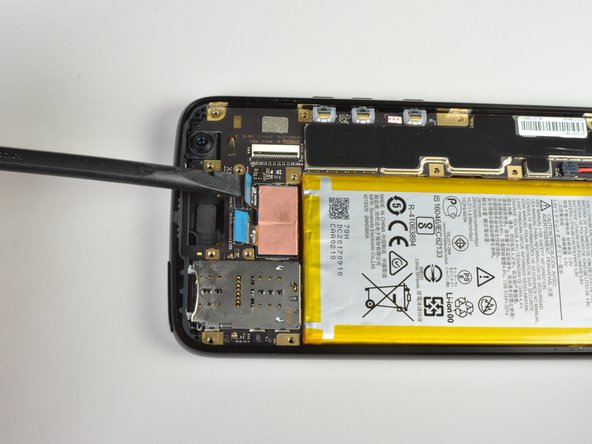

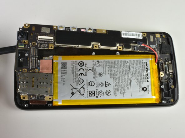

  21. Motorola Moto X4 Front-facing Camera Replacement, Motherboard: crwdns2935265:021crwdnd2935265:01crwdnd2935265:01crwdne2935265:0
    • Remove the T3 screw that is holding in the motherboard.
  22. Motorola Moto X4 Front-facing Camera Replacement: crwdns2935265:022crwdnd2935265:01crwdnd2935265:03crwdne2935265:0 Motorola Moto X4 Front-facing Camera Replacement: crwdns2935265:022crwdnd2935265:02crwdnd2935265:03crwdne2935265:0 Motorola Moto X4 Front-facing Camera Replacement: crwdns2935265:022crwdnd2935265:03crwdnd2935265:03crwdne2935265:0
    • Use flat edge of the spudger to pry up the two blue connectors near the top of the device.
  23. Motorola Moto X4 Front-facing Camera Replacement: crwdns2935265:023crwdnd2935265:01crwdnd2935265:02crwdne2935265:0 Motorola Moto X4 Front-facing Camera Replacement: crwdns2935265:023crwdnd2935265:02crwdnd2935265:02crwdne2935265:0
    • Use flat side of spudger to pry up connector near the bottom of the device.

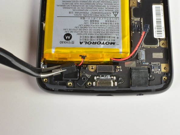

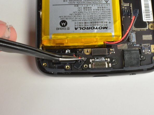

  24. Motorola Moto X4 Front-facing Camera Replacement: crwdns2935265:024crwdnd2935265:01crwdnd2935265:03crwdne2935265:0 Motorola Moto X4 Front-facing Camera Replacement: crwdns2935265:024crwdnd2935265:02crwdnd2935265:03crwdne2935265:0 Motorola Moto X4 Front-facing Camera Replacement: crwdns2935265:024crwdnd2935265:03crwdnd2935265:03crwdne2935265:0
    • Using a pair of tweezers disconnect the vibrating motors connector near the bottom of the device.
    • Caution: these wires are very delicate!
    • Also note that while it may not look the same, this connector also lifts up, similar to the camera and battery connectors, and does not slide out.
    • Alternatively, you can also leave the connector plugged in and simply remove the vibration motor from the frame and keep it together with the motherboard as you remove it, being careful to not dangle it from the small wires.

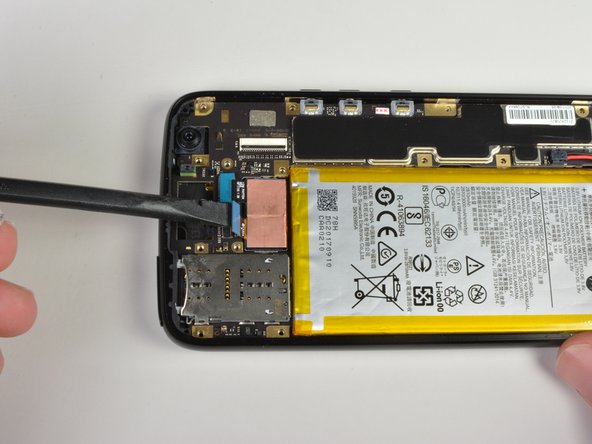

  25. Motorola Moto X4 Front-facing Camera Replacement: crwdns2935265:025crwdnd2935265:01crwdnd2935265:02crwdne2935265:0 Motorola Moto X4 Front-facing Camera Replacement: crwdns2935265:025crwdnd2935265:02crwdnd2935265:02crwdne2935265:0
    • Carefully pry up the motherboard using the spudger.
    • The previously disconnected wires may have to be held back in order to easily remove the motherboard.

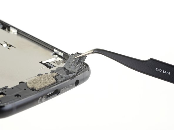

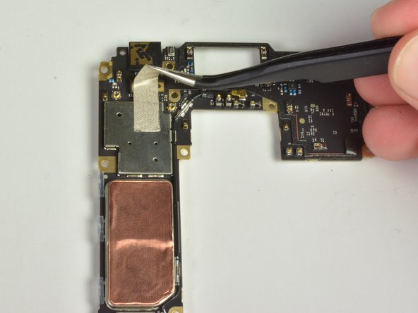

  26. Motorola Moto X4 Front-facing Camera Replacement, Front Facing Camera: crwdns2935265:026crwdnd2935265:01crwdnd2935265:02crwdne2935265:0 Motorola Moto X4 Front-facing Camera Replacement, Front Facing Camera: crwdns2935265:026crwdnd2935265:02crwdnd2935265:02crwdne2935265:0
    • Now carefully peel off the tape on the back of the camera with tweezers.

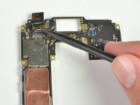

  27. Motorola Moto X4 Front-facing Camera Replacement: crwdns2935265:027crwdnd2935265:01crwdnd2935265:02crwdne2935265:0 Motorola Moto X4 Front-facing Camera Replacement: crwdns2935265:027crwdnd2935265:02crwdnd2935265:02crwdne2935265:0
    • Now use the flat edge of a spudger to carefully disconnect the camera from the motherboard.
