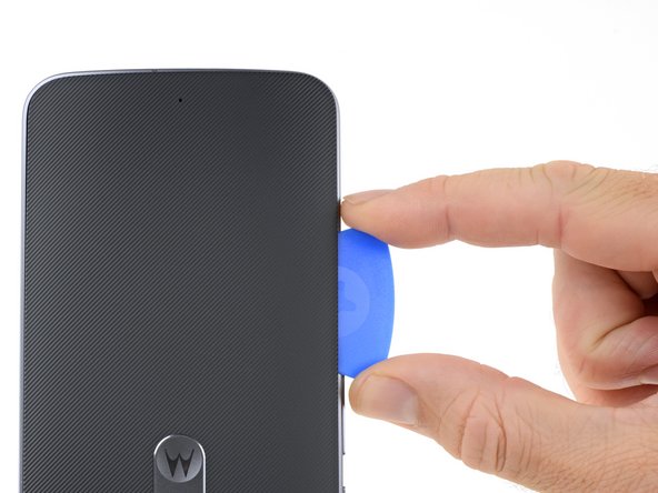

      • Prepare an iOpener and heat the back of the phone along its right edge for about five minutes. This will help soften the adhesive securing the back cover.
      • You may need to reheat and reapply the iOpener several times to get the phone warm enough. Follow the iOpener instructions to avoid overheating.
      • A hair dryer, heat gun, or hot plate may also be used, but be careful not to overheat the phone—the LCD display and internal battery are both susceptible to heat damage.

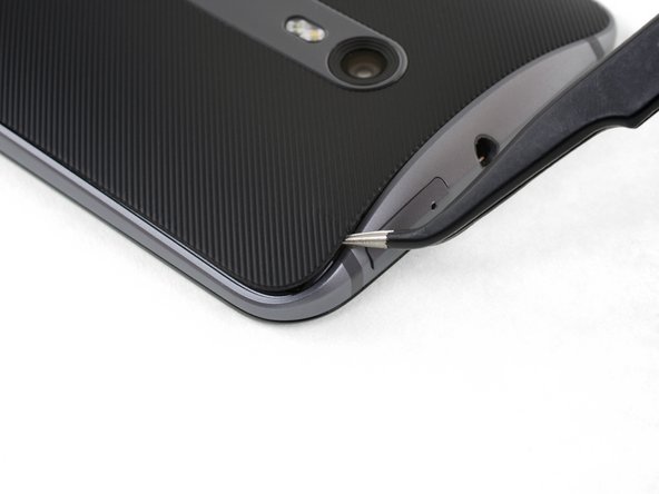

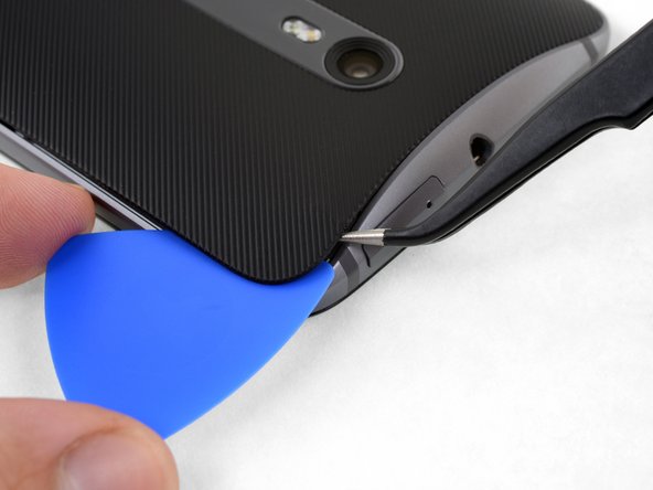

      • Hold a pair of pointed tweezers closed, and insert them into the small hole on the edge of the back cover near the SIM card slot.
      • Use the tweezers to lift the cover up slightly, and slide an opening pick into the gap between the cover and the frame.

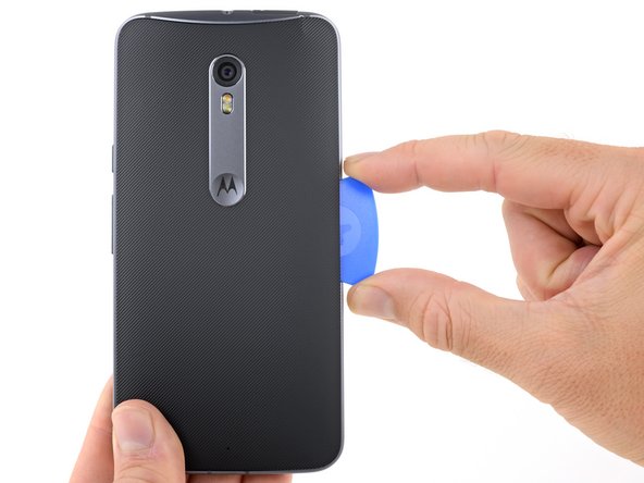

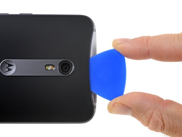

      • Slide the opening pick along the edge of the phone to slice through the back cover adhesive.
      • Try to insert the pick as far as you can underneath the cover, toward the center of the cover. There's thick adhesive on the middle of the cover that must be separated.
      • Leave the pick in place as you proceed to the next step. Leaving the pick inserted can help prevent the glue you just separated from re-adhering.

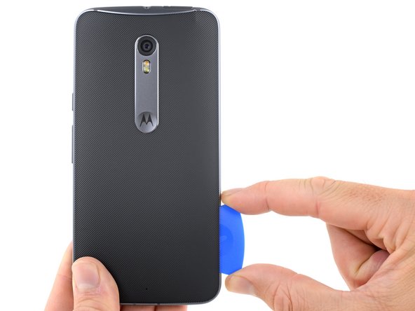

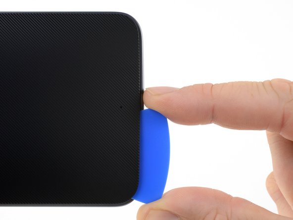

      • Slice through the adhesive along the bottom edge of the phone.
      • Re-heat the back cover as needed to prevent the glue from cooling and hardening.

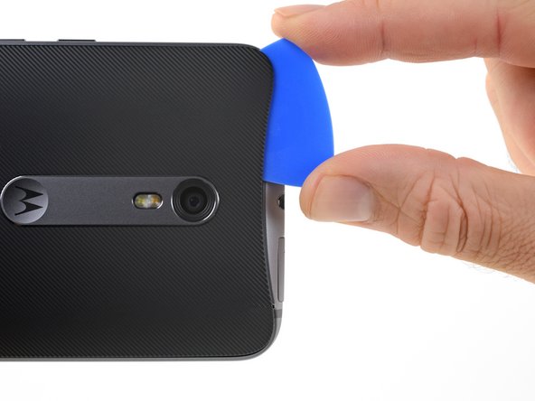

    7. Motorola Moto X Pure Edition Back Cover Replacement: crwdns2935265:07crwdnd2935265:01crwdnd2935265:02crwdne2935265:0 Motorola Moto X Pure Edition Back Cover Replacement: crwdns2935265:07crwdnd2935265:02crwdnd2935265:02crwdne2935265:0
      • Slice through the adhesive along the left side of the phone.
      • Stop cutting when you get to the edge of the volume buttons. Cutting past this point may damage the ribbon cables underneath the cover.

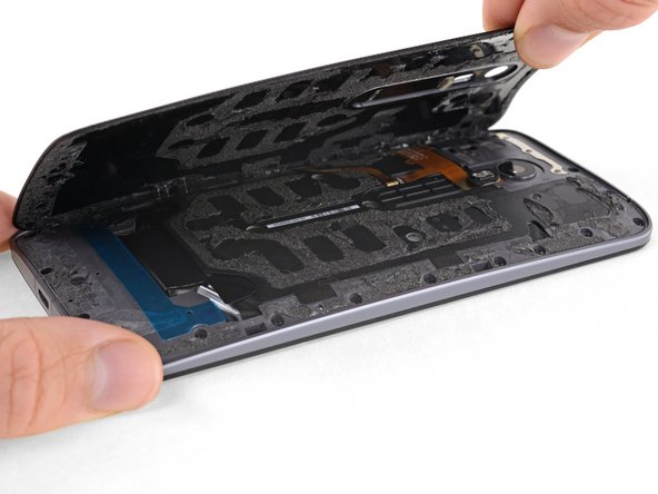

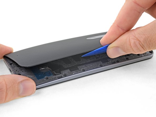

      • Carefully pry the cover away from the phone.
      • This may take a lot of force if the adhesive in the middle is still attached. As you lift the cover, you may need to use an opening pick to slice through any remaining adhesive.
      • To reinstall the back cover:
      • First use tweezers to peel away any remaining adhesive from both the back cover and the phone's chassis.
      • Then, clean the adhesion areas with high concentration isopropyl alcohol (at least 90%) and a lint-free cloth. Swipe in one direction only, not back and forth. This will help prep the surface for the new adhesive.
      • If it didn't already fall off, lift the metal camera plate away from the back cover. Carefully apply adhesive to the cover. Replacement adhesive comes in a pre-cut sheet to match the exact contours of the back cover. If that's not available, you can use a high-bond double-sided tape, such as Tesa 61395. With the new adhesive applied, reinstall the camera plate.
      • After installing the rear cover, apply strong, steady pressure to your phone for several minutes to help the adhesive form a good bond.
      • If desired, you may reinstall the back cover without replacing the adhesive. Remove any large chunks of adhesive that might prevent the back cover from sitting down flush. After installation, warm the back cover and apply pressure to secure it.
