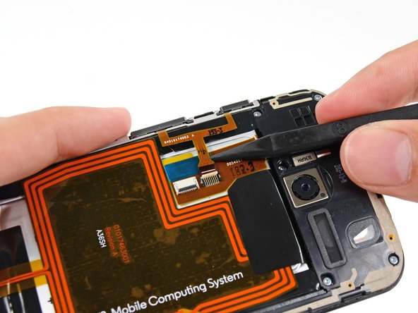

      • Insert the tip of a spudger under the battery cable near the connector to lift it straight up from its socket.
      • Use the flat end of a spudger to disconnect the NFC antenna cable connector.

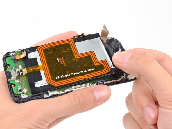

    5. Motorola Moto X Display Assembly Replacement: crwdns2935265:017crwdnd2935265:01crwdnd2935265:03crwdne2935265:0 Motorola Moto X Display Assembly Replacement: crwdns2935265:017crwdnd2935265:02crwdnd2935265:03crwdne2935265:0 Motorola Moto X Display Assembly Replacement: crwdns2935265:017crwdnd2935265:03crwdnd2935265:03crwdne2935265:0
      Tesa 61395 Tape
      $8.95
      • Use the adhesive pull-tab to lift the battery from its recess.
      • The battery is secured to the motherboard with mild adhesive. Peel slowly, and be careful not to bend or puncture the battery.
      • Remove the battery from the phone.
      • When reassembling your phone secure the battery with double-sided tape or pre-cut adhesive strips.

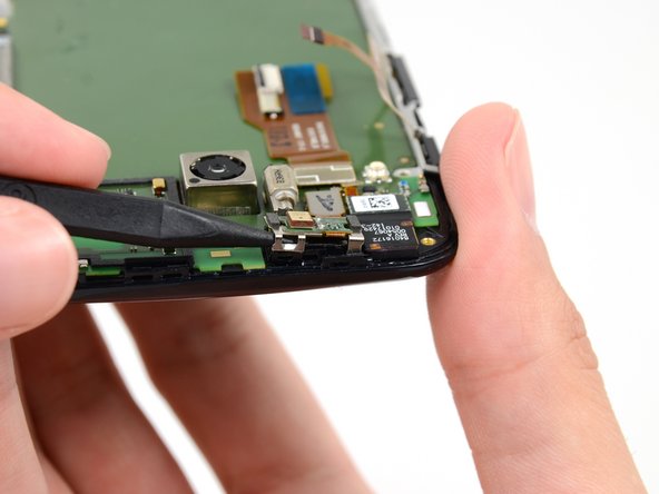

    3. Motorola Moto X Display Assembly Replacement: crwdns2935265:020crwdnd2935265:01crwdnd2935265:02crwdne2935265:0 Motorola Moto X Display Assembly Replacement: crwdns2935265:020crwdnd2935265:02crwdnd2935265:02crwdne2935265:0
      • Push the tip of a spudger under the microphone assembly clip to free it from the earpiece speaker.
      • If the assembly clip seems to be missing, check the speaker assembly that was removed from the previous step.

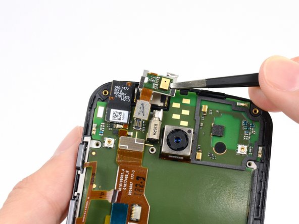

    4. Motorola Moto X Display Assembly Replacement: crwdns2935265:021crwdnd2935265:01crwdnd2935265:02crwdne2935265:0 Motorola Moto X Display Assembly Replacement: crwdns2935265:021crwdnd2935265:02crwdnd2935265:02crwdne2935265:0
      • Use the flat end of a spudger to free the microphone assembly cable connector.
      • Use tweezers to remove the microphone assembly.

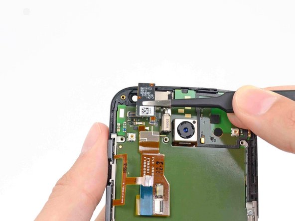

    5. Motorola Moto X Display Assembly Replacement: crwdns2935265:022crwdnd2935265:01crwdnd2935265:02crwdne2935265:0 Motorola Moto X Display Assembly Replacement: crwdns2935265:022crwdnd2935265:02crwdnd2935265:02crwdne2935265:0
      • Disconnect the front-facing camera cable connector.
      • Remove the front-facing camera from its recess with a pair of tweezers.

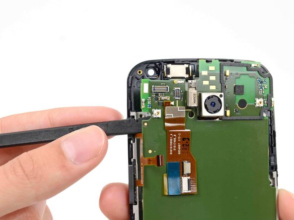

      • Insert the flat end of a spudger under the motherboard above the button assembly cable, and pry it out of the phone.
      • Be careful not to snag any cables.
      • The buttons may pop out of their recesses; take care not to lose them.

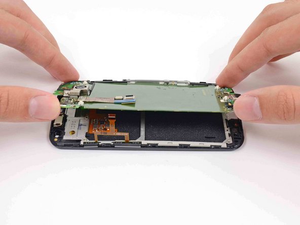

    9. Motorola Moto X Display Assembly Replacement: crwdns2935265:026crwdnd2935265:01crwdnd2935265:02crwdne2935265:0 Motorola Moto X Display Assembly Replacement: crwdns2935265:026crwdnd2935265:02crwdnd2935265:02crwdne2935265:0
      • Gently lift the motherboard out of the phone, rotating it from the SIM slot edge of the phone.
      • Do not attempt to separate the motherboard entirely; it is still connected to the display by the display cable.
    10. Motorola Moto X Display Assembly Replacement: crwdns2935265:027crwdnd2935265:01crwdnd2935265:03crwdne2935265:0 Motorola Moto X Display Assembly Replacement: crwdns2935265:027crwdnd2935265:02crwdnd2935265:03crwdne2935265:0 Motorola Moto X Display Assembly Replacement: crwdns2935265:027crwdnd2935265:03crwdnd2935265:03crwdne2935265:0
      • Lay the motherboard down to allow access to the display cable connector.
      • Use the flat end of a spudger to flip the retaining tab on the display cable ZIF connector.
      • Carefully pull the display cable out of its connector as you remove the motherboard from the display assembly.

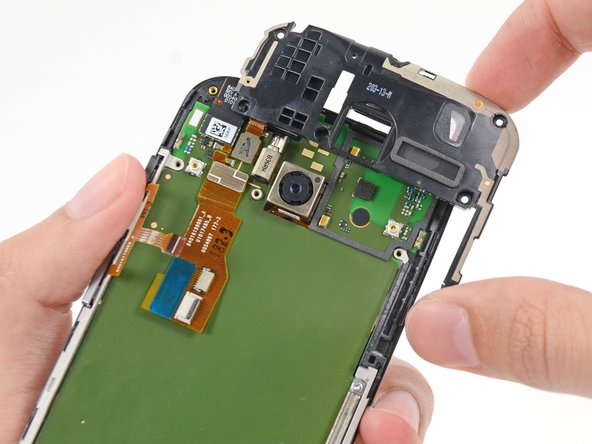

    1. Motorola Moto X Display Assembly Replacement, Display Assembly: crwdns2935265:028crwdnd2935265:01crwdnd2935265:03crwdne2935265:0 Motorola Moto X Display Assembly Replacement, Display Assembly: crwdns2935265:028crwdnd2935265:02crwdnd2935265:03crwdne2935265:0 Motorola Moto X Display Assembly Replacement, Display Assembly: crwdns2935265:028crwdnd2935265:03crwdnd2935265:03crwdne2935265:0

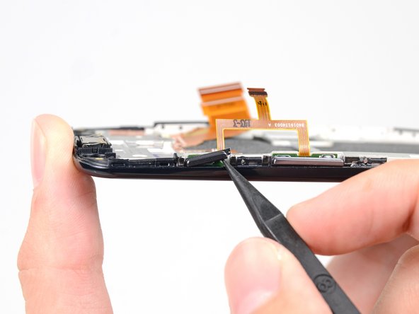

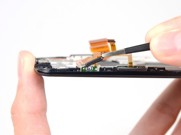

      • Use the tip of a spudger to nudge the sleep/power button out of its slot in the display assembly.
      • Remove the sleep/power button cover with a pair of tweezers.

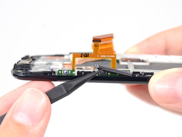

    2. Motorola Moto X Display Assembly Replacement: crwdns2935265:029crwdnd2935265:01crwdnd2935265:03crwdne2935265:0 Motorola Moto X Display Assembly Replacement: crwdns2935265:029crwdnd2935265:02crwdnd2935265:03crwdne2935265:0 Motorola Moto X Display Assembly Replacement: crwdns2935265:029crwdnd2935265:03crwdnd2935265:03crwdne2935265:0
      • Use the tip of a spudger to push the volume rocker button cover out of the display assembly, and remove.

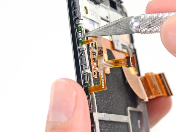

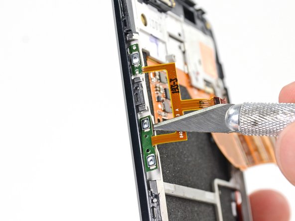

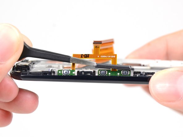

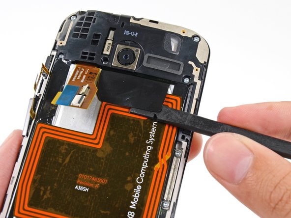

    3. Motorola Moto X Display Assembly Replacement: crwdns2935265:030crwdnd2935265:01crwdnd2935265:03crwdne2935265:0 Motorola Moto X Display Assembly Replacement: crwdns2935265:030crwdnd2935265:02crwdnd2935265:03crwdne2935265:0 Motorola Moto X Display Assembly Replacement: crwdns2935265:030crwdnd2935265:03crwdnd2935265:03crwdne2935265:0
      • Use the tip of a hobby knife or plastic opening tool to pry the button assembly off of the adhesive securing it to the display assembly.
      • Keep the sharp edge of the knife pointed away from the cable to avoid accidentally cutting it.
    4. Motorola Moto X Display Assembly Replacement: crwdns2935265:031crwdnd2935265:01crwdnd2935265:01crwdne2935265:0
      • Remove the button assembly cable from the display assembly.

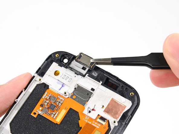

    5. Motorola Moto X Display Assembly Replacement: crwdns2935265:032crwdnd2935265:01crwdnd2935265:03crwdne2935265:0 Motorola Moto X Display Assembly Replacement: crwdns2935265:032crwdnd2935265:02crwdnd2935265:03crwdne2935265:0 Motorola Moto X Display Assembly Replacement: crwdns2935265:032crwdnd2935265:03crwdnd2935265:03crwdne2935265:0

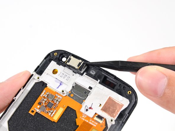

      • If your replacement part comes with an earpiece speaker, skip this step.
      • Pry the earpiece speaker out of the display assembly with the point of a spudger.
      • Remove the earpiece speaker with a pair of tweezers.

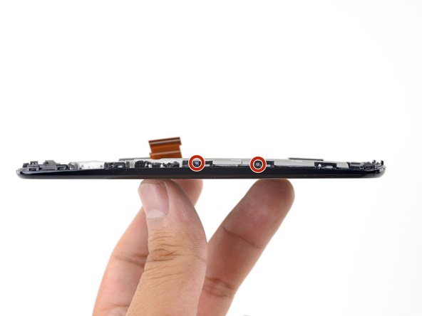

      • If your replacement part comes with a white mid-frame, skip the remaining steps.
      • The white mid-frame is held to the display assembly by tiny pins.
      • Look over the long edges of the display assembly and note where all the pins are.

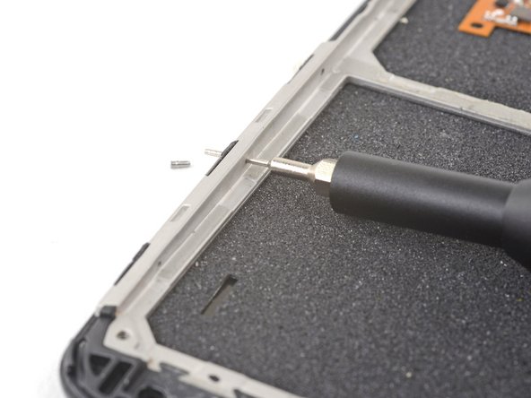

    7. Motorola Moto X Display Assembly Replacement: crwdns2935265:034crwdnd2935265:01crwdnd2935265:02crwdne2935265:0 Motorola Moto X Display Assembly Replacement: crwdns2935265:034crwdnd2935265:02crwdnd2935265:02crwdne2935265:0
      • Use a SIM eject tool, SIM eject bit, or a bent paper clip to gently push the pin outwards from within the case.
      • Be sure to do this in a clean and brightly lit work area. The pins are very small and are easily lost.
      • Repeat the process for the remaining pins.
      • To reinstall the pins, align them with the holes on the outside of the display assembly and them push inwards.
      • The pins have a tapered end and will install in only one direction.

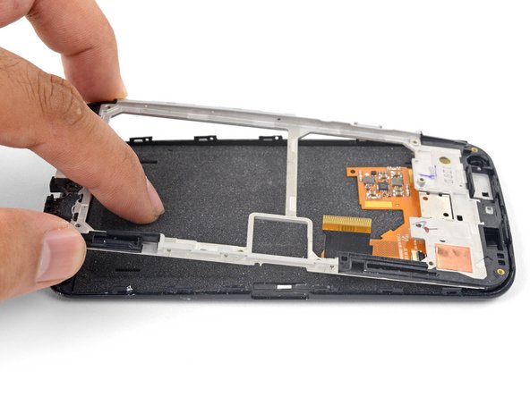

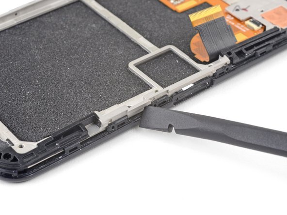

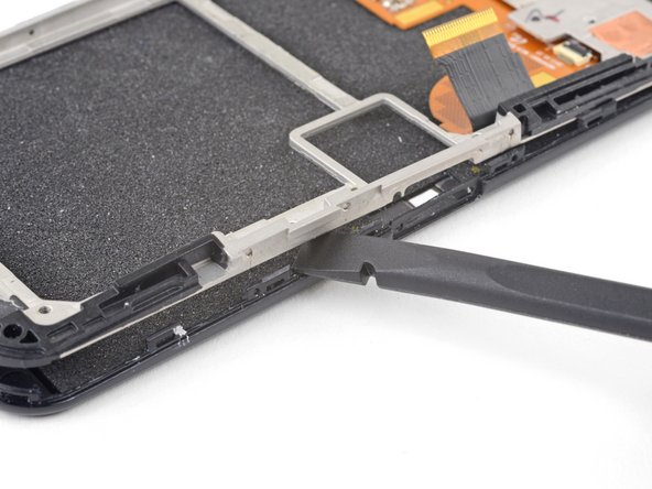

    8. Motorola Moto X Display Assembly Replacement: crwdns2935265:035crwdnd2935265:01crwdnd2935265:03crwdne2935265:0 Motorola Moto X Display Assembly Replacement: crwdns2935265:035crwdnd2935265:02crwdnd2935265:03crwdne2935265:0 Motorola Moto X Display Assembly Replacement: crwdns2935265:035crwdnd2935265:03crwdnd2935265:03crwdne2935265:0
      • Use the flat end of a spudger to pry up the white mid-frame from the display assembly.
      • If any part of the mid-frame seems resistant to movement, check for any overlooked pins still holding the frame in place.
    9. Motorola Moto X Display Assembly Replacement: crwdns2935265:036crwdnd2935265:01crwdnd2935265:03crwdne2935265:0 Motorola Moto X Display Assembly Replacement: crwdns2935265:036crwdnd2935265:02crwdnd2935265:03crwdne2935265:0 Motorola Moto X Display Assembly Replacement: crwdns2935265:036crwdnd2935265:03crwdnd2935265:03crwdne2935265:0
      Tesa 61395 Tape
      $8.95

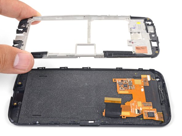

      • Hold the edges of the white mid-frame and push against the display assembly to swing the mid-frame free.
      • Remove the white mid-frame.
      • When reassembling your phone replace old adhesive with double-sided tape or pre-cut adhesive strips.
