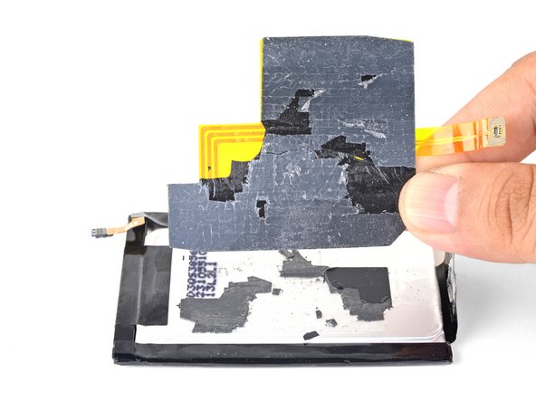

  18. Motorola Moto X Battery Replacement, NFC Antenna: crwdns2935265:018crwdnd2935265:01crwdnd2935265:01crwdne2935265:0
    • Proceed only if you want to transfer the NFC antenna from the old battery to the new battery.
    • If you choose not to, or if you damage the coil, your phone will work without it, but lose its NFC capabilities.
    • Apply a heated iOpener to the NFC antenna for 90 seconds.
  19. Motorola Moto X Battery Replacement: crwdns2935265:019crwdnd2935265:01crwdnd2935265:03crwdne2935265:0 Motorola Moto X Battery Replacement: crwdns2935265:019crwdnd2935265:02crwdnd2935265:03crwdne2935265:0 Motorola Moto X Battery Replacement: crwdns2935265:019crwdnd2935265:03crwdnd2935265:03crwdne2935265:0
    • Insert an opening pick under one of the corners of the NFC antenna and slowly slide it along the edge to cut through the black adhesive.
    • While it is not imperative to keep the black adhesive layer intact, try to cut underneath it so that it comes off in one piece.
  20. Motorola Moto X Battery Replacement: crwdns2935265:020crwdnd2935265:01crwdnd2935265:03crwdne2935265:0 Motorola Moto X Battery Replacement: crwdns2935265:020crwdnd2935265:02crwdnd2935265:03crwdne2935265:0 Motorola Moto X Battery Replacement: crwdns2935265:020crwdnd2935265:03crwdnd2935265:03crwdne2935265:0
    • Continue using the opening pick to cut around the NFC antenna, loosening the remaining black adhesive.
    • The NFC antenna should still function normally as long as the plastic layer is not ripped.
  21. Motorola Moto X Battery Replacement: crwdns2935265:021crwdnd2935265:01crwdnd2935265:02crwdne2935265:0 Motorola Moto X Battery Replacement: crwdns2935265:021crwdnd2935265:02crwdnd2935265:02crwdne2935265:0
    Tesa 61395 Tape
    $5.99
    • Remove the NFC antenna from the old battery.
    • Use pre-cut double sided tape or Tesa tape to reattach the NFC coil to the replacement battery.
    • Before installing the NFC antenna, install the replacement battery and plug in the NFC antenna, to make sure that the antenna is properly aligned.

This doesn't address the antenna stuck on (but separate) from the battery. It's easy enough to see in the pictures, but it doesn't come off easily in one piece. I think mine still works, but definitely needs addressing.
Kim Schaffer - crwdns2934203:0crwdne2934203:0
Yes - getting the antenna off is a bear. I - well, my cell-phone guy - didn't bother because I don't use NFC for anything, so I hope that was okay!
