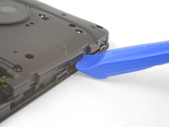

    • Insert your fingernail or the flat end of a spudger into the notch on the bottom edge of the phone near the charging port.
    • Pry with your fingernail or twist the spudger to release the back cover from the phone.

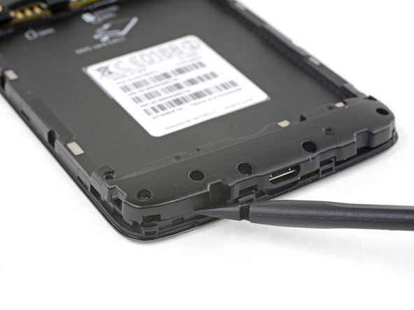

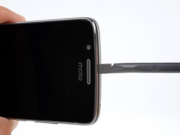

  2. Motorola Moto G5 LCD Screen and Digitizer Assembly Replacement: crwdns2935265:02crwdnd2935265:01crwdnd2935265:03crwdne2935265:0 Motorola Moto G5 LCD Screen and Digitizer Assembly Replacement: crwdns2935265:02crwdnd2935265:02crwdnd2935265:03crwdne2935265:0 Motorola Moto G5 LCD Screen and Digitizer Assembly Replacement: crwdns2935265:02crwdnd2935265:03crwdnd2935265:03crwdne2935265:0
    • Insert the flat end of a spudger into the seam and slide it along the bottom edge to release the clips holding the back cover to the phone.
  3. Motorola Moto G5 LCD Screen and Digitizer Assembly Replacement: crwdns2935265:03crwdnd2935265:01crwdnd2935265:03crwdne2935265:0 Motorola Moto G5 LCD Screen and Digitizer Assembly Replacement: crwdns2935265:03crwdnd2935265:02crwdnd2935265:03crwdne2935265:0 Motorola Moto G5 LCD Screen and Digitizer Assembly Replacement: crwdns2935265:03crwdnd2935265:03crwdnd2935265:03crwdne2935265:0
    • Continue sliding the flat end of the spudger along the seam for the remaining sides of the phone.

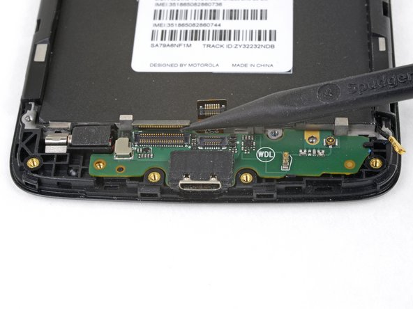

  9. Motorola Moto G5 LCD Screen and Digitizer Assembly Replacement: crwdns2935265:09crwdnd2935265:01crwdnd2935265:02crwdne2935265:0 Motorola Moto G5 LCD Screen and Digitizer Assembly Replacement: crwdns2935265:09crwdnd2935265:02crwdnd2935265:02crwdne2935265:0

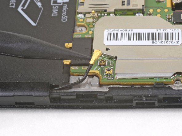

    • Use the point of a spudger to pry up and disconnect the antenna cable from the daughterboard.
  10. Motorola Moto G5 LCD Screen and Digitizer Assembly Replacement: crwdns2935265:010crwdnd2935265:01crwdnd2935265:03crwdne2935265:0 Motorola Moto G5 LCD Screen and Digitizer Assembly Replacement: crwdns2935265:010crwdnd2935265:02crwdnd2935265:03crwdne2935265:0 Motorola Moto G5 LCD Screen and Digitizer Assembly Replacement: crwdns2935265:010crwdnd2935265:03crwdnd2935265:03crwdne2935265:0
    • Use the point of a spudger to pry up and disconnect the two flex cable connectors from the daughterboard.
  11. Motorola Moto G5 LCD Screen and Digitizer Assembly Replacement: crwdns2935265:011crwdnd2935265:01crwdnd2935265:02crwdne2935265:0 Motorola Moto G5 LCD Screen and Digitizer Assembly Replacement: crwdns2935265:011crwdnd2935265:02crwdnd2935265:02crwdne2935265:0

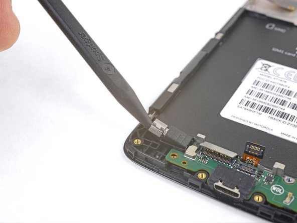

    • Use the point of a spudger to pry up and loosen the vibration motor from its recess.
    • The vibration motor can remain attached to the daughterboard.

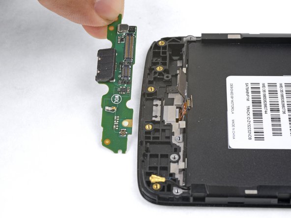

  12. Motorola Moto G5 LCD Screen and Digitizer Assembly Replacement: crwdns2935265:012crwdnd2935265:01crwdnd2935265:01crwdne2935265:0
    • Remove the 3.4 mm Phillips screw securing the daughterboard to the frame.
  13. Motorola Moto G5 LCD Screen and Digitizer Assembly Replacement: crwdns2935265:013crwdnd2935265:01crwdnd2935265:03crwdne2935265:0 Motorola Moto G5 LCD Screen and Digitizer Assembly Replacement: crwdns2935265:013crwdnd2935265:02crwdnd2935265:03crwdne2935265:0 Motorola Moto G5 LCD Screen and Digitizer Assembly Replacement: crwdns2935265:013crwdnd2935265:03crwdnd2935265:03crwdne2935265:0
    • Insert the flat end of a spudger below the daughterboard, near the charging port.
    • Pry the daughterboard up slightly with the spudger to loosen it from its recess.
    • Lift and remove the daughterboard, taking care not to snare any cables.

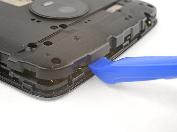

    • Insert an opening tool into the seam on the right side of the phone near the top.
    • Gently pry upwards until the hidden clip on the motherboard cover releases.

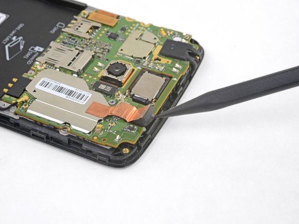

    • Use the point of a spudger to pry up and disconnect the display connector from the motherboard.

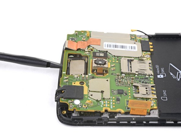

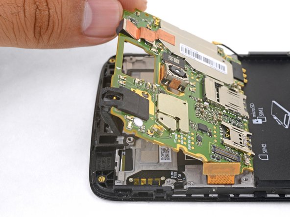

  22. Motorola Moto G5 LCD Screen and Digitizer Assembly Replacement: crwdns2935265:022crwdnd2935265:01crwdnd2935265:03crwdne2935265:0 Motorola Moto G5 LCD Screen and Digitizer Assembly Replacement: crwdns2935265:022crwdnd2935265:02crwdnd2935265:03crwdne2935265:0 Motorola Moto G5 LCD Screen and Digitizer Assembly Replacement: crwdns2935265:022crwdnd2935265:03crwdnd2935265:03crwdne2935265:0
    • Insert the flat end of a spudger underneath the motherboard, near the top edge of the phone.
    • Twist the spudger slightly to loosen the motherboard from the frame.
    • Swing the top edge of the motherboard upwards, making sure it does not snag any cables.
    • Do not remove the motherboard yet. It is still connected by a flex cable.

  24. Motorola Moto G5 LCD Screen and Digitizer Assembly Replacement: crwdns2935265:024crwdnd2935265:01crwdnd2935265:01crwdne2935265:0
    • Lift up and remove the motherboard.

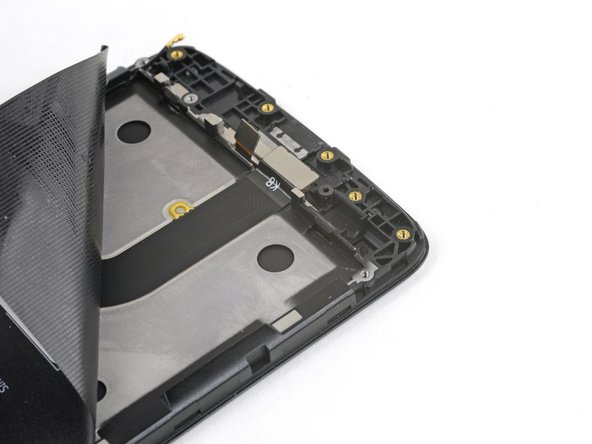

  25. Motorola Moto G5 LCD Screen and Digitizer Assembly Replacement: crwdns2935265:025crwdnd2935265:01crwdnd2935265:03crwdne2935265:0 Motorola Moto G5 LCD Screen and Digitizer Assembly Replacement: crwdns2935265:025crwdnd2935265:02crwdnd2935265:03crwdne2935265:0 Motorola Moto G5 LCD Screen and Digitizer Assembly Replacement: crwdns2935265:025crwdnd2935265:03crwdnd2935265:03crwdne2935265:0

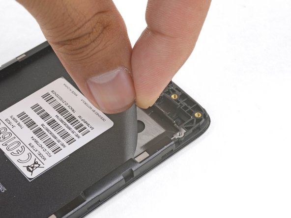

    • Use the point of a spudger to pry up a corner of the black battery mat.
    • Use your fingers to peel the battery mat from the frame.

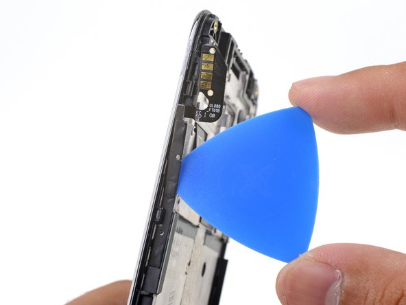

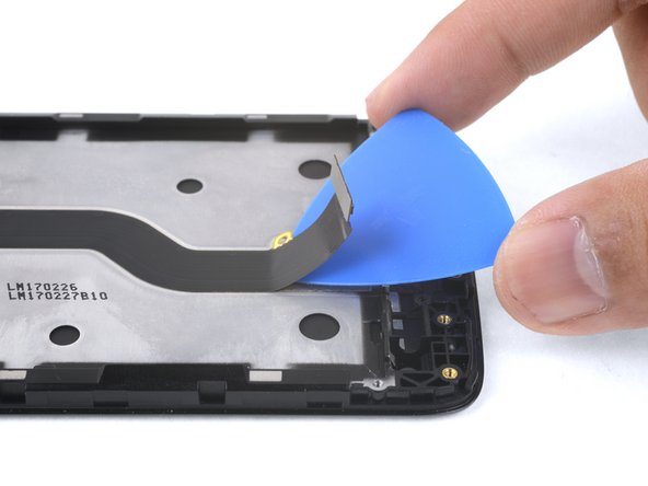

    • Insert an opening pick under the daughterboard flex cable.
    • Slide the pick along the underside of the cable, releasing it from the frame.
    • Remove the daughterboard flex cable.

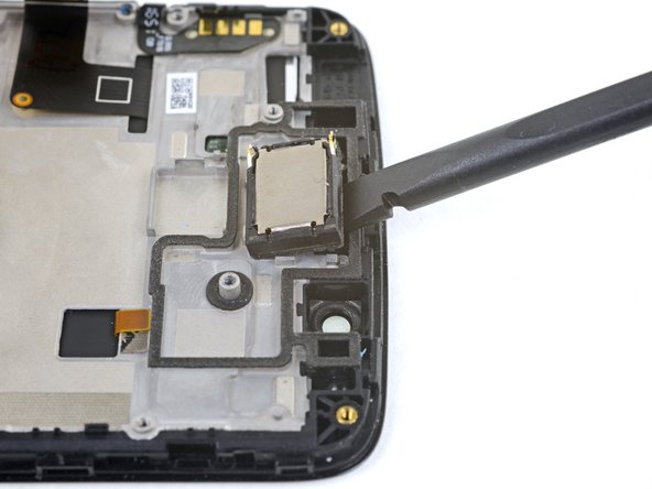

  28. Motorola Moto G5 LCD Screen and Digitizer Assembly Replacement: crwdns2935265:028crwdnd2935265:01crwdnd2935265:03crwdne2935265:0 Motorola Moto G5 LCD Screen and Digitizer Assembly Replacement: crwdns2935265:028crwdnd2935265:02crwdnd2935265:03crwdne2935265:0 Motorola Moto G5 LCD Screen and Digitizer Assembly Replacement: crwdns2935265:028crwdnd2935265:03crwdnd2935265:03crwdne2935265:0
    • Use the flat end of a spudger to pry up and loosen the earpiece module from its recess.
    • Remove the earpiece module.
    • During re-installation, be sure to check the orientation of the earpiece module and reinstall it the same way.

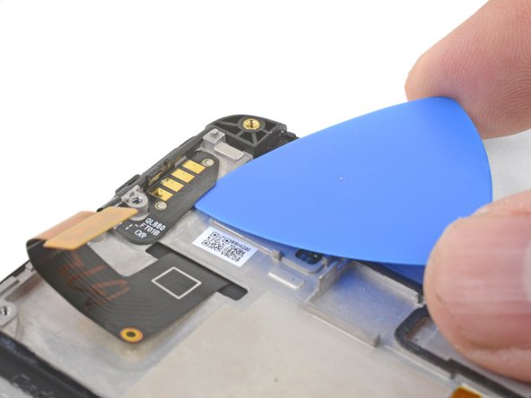

    • Insert an opening pick underneath the button contact flex cable.
    • Slide the opening pick to loosen the button contact flex cable from the frame.

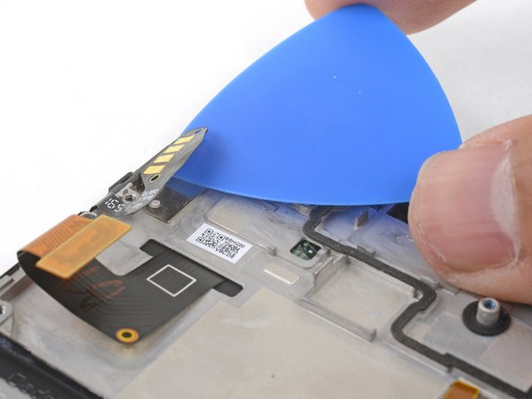

  30. Motorola Moto G5 LCD Screen and Digitizer Assembly Replacement: crwdns2935265:030crwdnd2935265:01crwdnd2935265:03crwdne2935265:0 Motorola Moto G5 LCD Screen and Digitizer Assembly Replacement: crwdns2935265:030crwdnd2935265:02crwdnd2935265:03crwdne2935265:0 Motorola Moto G5 LCD Screen and Digitizer Assembly Replacement: crwdns2935265:030crwdnd2935265:03crwdnd2935265:03crwdne2935265:0
    • Insert an opening pick between the button assembly and the frame.
    • Gently slide the pick to release the button assembly from the frame.
    • Remove the button assembly.
