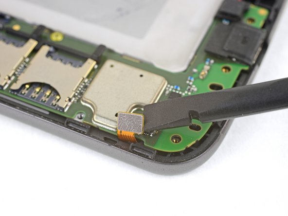

    • Use the point of a spudger to pry up the rubber cover over the camera flash connector.
    • Remove the rubber cover.

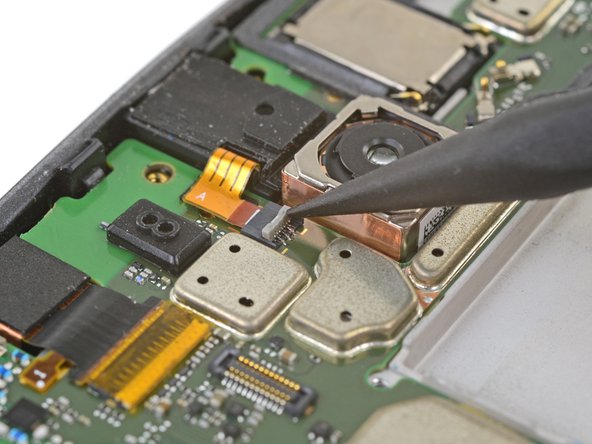

  6. Motorola Moto G4 Plus LCD Screen and Digitizer Assembly Replacement: crwdns2935265:06crwdnd2935265:01crwdnd2935265:02crwdne2935265:0 Motorola Moto G4 Plus LCD Screen and Digitizer Assembly Replacement: crwdns2935265:06crwdnd2935265:02crwdnd2935265:02crwdne2935265:0
    • Use the point of a spudger to pry up and disconnect the camera flash connector.

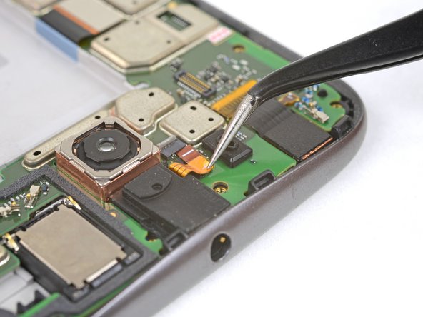

  17. Motorola Moto G4 Plus LCD Screen and Digitizer Assembly Replacement: crwdns2935265:017crwdnd2935265:01crwdnd2935265:03crwdne2935265:0 Motorola Moto G4 Plus LCD Screen and Digitizer Assembly Replacement: crwdns2935265:017crwdnd2935265:02crwdnd2935265:03crwdne2935265:0 Motorola Moto G4 Plus LCD Screen and Digitizer Assembly Replacement: crwdns2935265:017crwdnd2935265:03crwdnd2935265:03crwdne2935265:0
    • Use tweezers to remove the yellow tape protecting the headphone jack's connector.
    • Use the point of a spudger to carefully flip up the headphone jack's grey ZIF connector lock.
  18. Motorola Moto G4 Plus LCD Screen and Digitizer Assembly Replacement: crwdns2935265:018crwdnd2935265:01crwdnd2935265:02crwdne2935265:0 Motorola Moto G4 Plus LCD Screen and Digitizer Assembly Replacement: crwdns2935265:018crwdnd2935265:02crwdnd2935265:02crwdne2935265:0
    • Use tweezers or the point of a spudger to carefully walk the ribbon out of the ZIF connector.
    • For reinstallation, align and reinsert the cable into the ZIF connector so that the white line on the cable barely shows. Flip the ZIF connector lock back down.

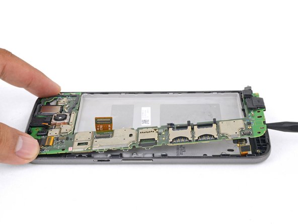

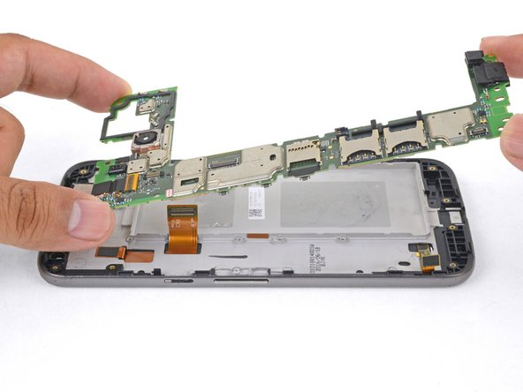

  20. Motorola Moto G4 Plus LCD Screen and Digitizer Assembly Replacement: crwdns2935265:020crwdnd2935265:01crwdnd2935265:03crwdne2935265:0 Motorola Moto G4 Plus LCD Screen and Digitizer Assembly Replacement: crwdns2935265:020crwdnd2935265:02crwdnd2935265:03crwdne2935265:0 Motorola Moto G4 Plus LCD Screen and Digitizer Assembly Replacement: crwdns2935265:020crwdnd2935265:03crwdnd2935265:03crwdne2935265:0
    • Insert the point of a spudger into a groove at the bottom of the motherboard.
    • Gently pry up to loosen the motherboard from the frame and from the edge clips.
    • Use a spudger to move any flex cables out of the way, as well as making sure that any modules attached to the motherboard (such as the front-facing camera) are loose from the frame.
    • If you feel any resistance, stop. Make sure there are no components still holding the frame to the motherboard.
    • Lift the motherboard up from the frame and remove it.

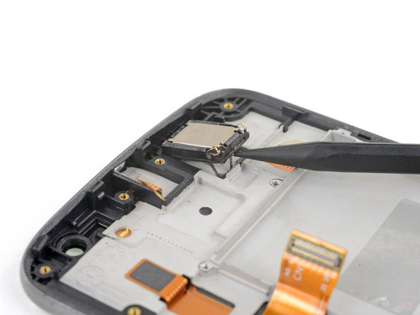

  22. Motorola Moto G4 Plus LCD Screen and Digitizer Assembly Replacement: crwdns2935265:022crwdnd2935265:01crwdnd2935265:02crwdne2935265:0 Motorola Moto G4 Plus LCD Screen and Digitizer Assembly Replacement: crwdns2935265:022crwdnd2935265:02crwdnd2935265:02crwdne2935265:0
    • To remove the earpiece speaker to transfer it onto the new frame, insert the point of a spudger at the bottom of the speaker.
    • Pry upwards to separate the earpiece speaker from the frame.
    • To install the earpiece speaker onto the new frame, check and replace the adhesive if necessary. Align the speaker such that the two spring contacts are oriented as shown in the picture.

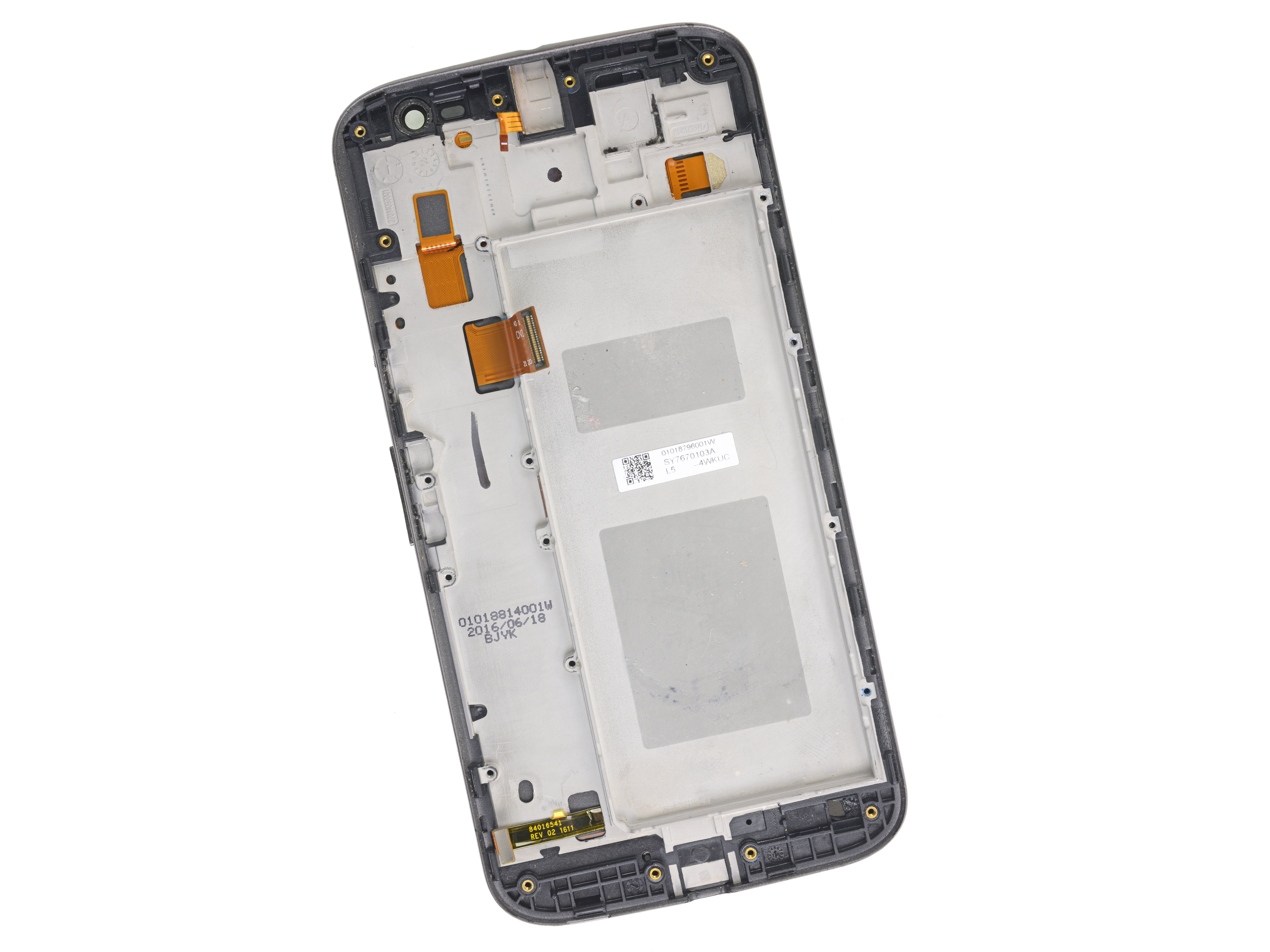

  23. Motorola Moto G4 Plus LCD Screen and Digitizer Assembly Replacement: crwdns2935265:023crwdnd2935265:01crwdnd2935265:01crwdne2935265:0
    • Only the LCD screen and digitizer assembly (with frame) remains.
    • Compare your new replacement part to the original part. You may need to transfer remaining components or remove adhesive backings from the new part before installing.
