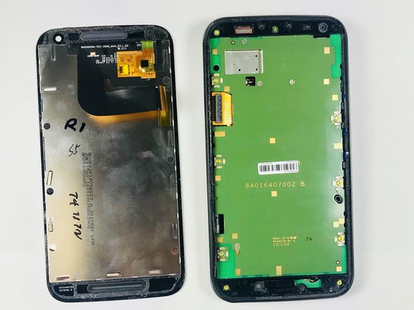

  4. Motorola Moto G3 Rear Camera  Replacement: crwdns2935265:04crwdnd2935265:01crwdnd2935265:03crwdne2935265:0 Motorola Moto G3 Rear Camera  Replacement: crwdns2935265:04crwdnd2935265:02crwdnd2935265:03crwdne2935265:0 Motorola Moto G3 Rear Camera  Replacement: crwdns2935265:04crwdnd2935265:03crwdnd2935265:03crwdne2935265:0

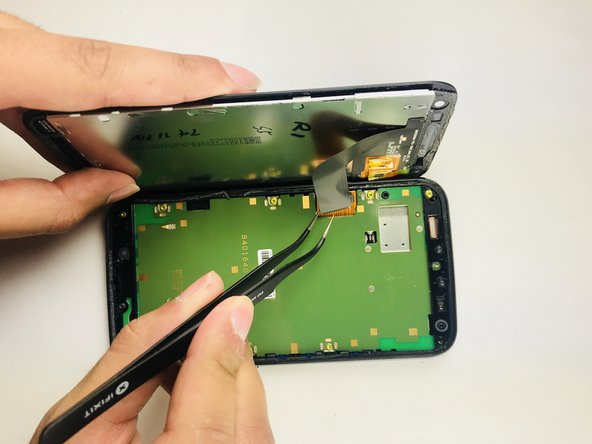

    • A strip will be attached to the motherboard as shown.
    • Using tweezers, carefully detach the strip from the motherboard.
  5. Motorola Moto G3 Rear Camera  Replacement, Rear Camera: crwdns2935265:05crwdnd2935265:01crwdnd2935265:03crwdne2935265:0 Motorola Moto G3 Rear Camera  Replacement, Rear Camera: crwdns2935265:05crwdnd2935265:02crwdnd2935265:03crwdne2935265:0 Motorola Moto G3 Rear Camera  Replacement, Rear Camera: crwdns2935265:05crwdnd2935265:03crwdnd2935265:03crwdne2935265:0

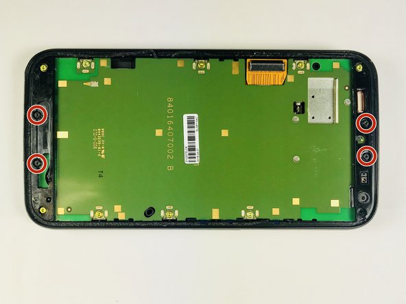

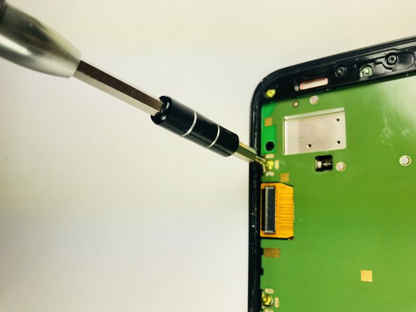

    • With a T4 screwdriver, remove the10 "yellow" 2mm screws and 4 "black" 2mm screws.
  6. Motorola Moto G3 Rear Camera  Replacement: crwdns2935265:06crwdnd2935265:01crwdnd2935265:03crwdne2935265:0 Motorola Moto G3 Rear Camera  Replacement: crwdns2935265:06crwdnd2935265:02crwdnd2935265:03crwdne2935265:0 Motorola Moto G3 Rear Camera  Replacement: crwdns2935265:06crwdnd2935265:03crwdnd2935265:03crwdne2935265:0
    • Use the metal spudger and lift the back cover on the bottom side of the phone (this is attached to the motherboard).

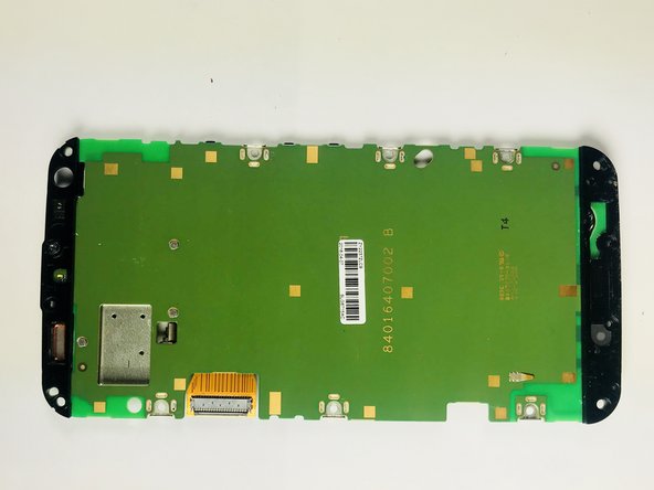

  7. Motorola Moto G3 Rear Camera  Replacement: crwdns2935265:07crwdnd2935265:01crwdnd2935265:01crwdne2935265:0

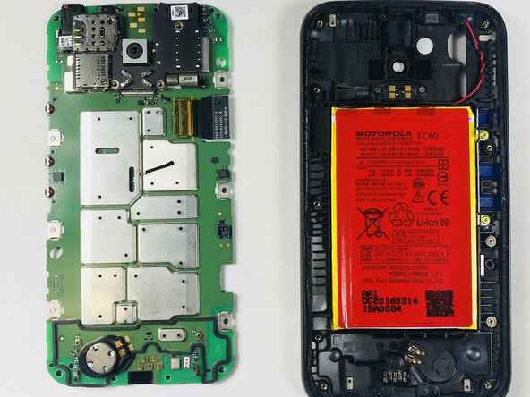

    • Flip the motherboard over.
  8. Motorola Moto G3 Rear Camera  Replacement: crwdns2935265:08crwdnd2935265:01crwdnd2935265:01crwdne2935265:0
    • Using a T4 Torx screwdriver, remove the three 2mm screws.
  9. Motorola Moto G3 Rear Camera  Replacement: crwdns2935265:09crwdnd2935265:01crwdnd2935265:02crwdne2935265:0 Motorola Moto G3 Rear Camera  Replacement: crwdns2935265:09crwdnd2935265:02crwdnd2935265:02crwdne2935265:0

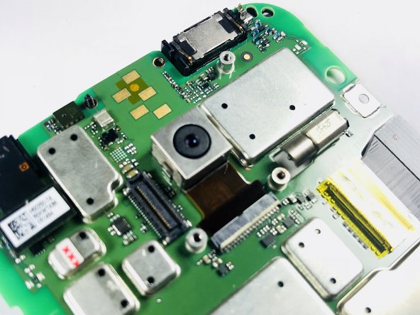

    • Using the tweezers remove the black rear camera cover.
  10. Motorola Moto G3 Rear Camera  Replacement: crwdns2935265:010crwdnd2935265:01crwdnd2935265:02crwdne2935265:0 Motorola Moto G3 Rear Camera  Replacement: crwdns2935265:010crwdnd2935265:02crwdnd2935265:02crwdne2935265:0

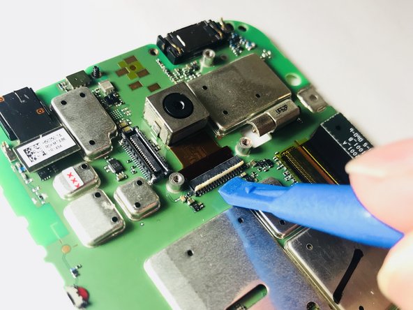

    • Using the small opening tool, carefully flip the camera flex connector in a upright position. You should hear a click allowing you to know the camera flex connector has been released.
  11. Motorola Moto G3 Rear Camera  Replacement: crwdns2935265:011crwdnd2935265:01crwdnd2935265:01crwdne2935265:0
    • Take the tweezers and remove the camera from the motherboard.
