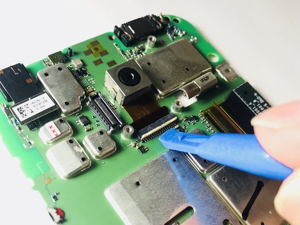

  10. Motorola Moto G 3rd Generation Rear-Facing Camera Replacement, Rear-Facing Camera: crwdns2935265:010crwdnd2935265:01crwdnd2935265:01crwdne2935265:0
    • Pry off the main camera from its base using a plastic opening tool.
  11. Motorola Moto G 3rd Generation Rear-Facing Camera Replacement: crwdns2935265:011crwdnd2935265:01crwdnd2935265:02crwdne2935265:0 Motorola Moto G 3rd Generation Rear-Facing Camera Replacement: crwdns2935265:011crwdnd2935265:02crwdnd2935265:02crwdne2935265:0
    • Use a plastic opening tool to flip up the lock on the camera cable ZIF connector.
  12. Motorola Moto G 3rd Generation Rear-Facing Camera Replacement: crwdns2935265:012crwdnd2935265:01crwdnd2935265:01crwdne2935265:0
    • Carefully pull the camera from its socket on the motherboard.
