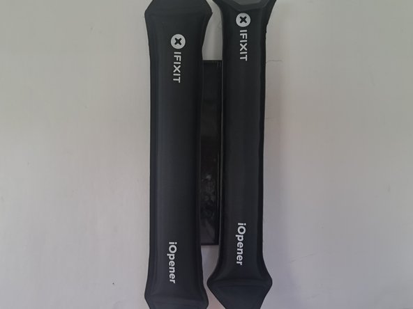

    • Lay the phone face down.
    • Heat an iOpener and apply it to the rear case.
    • Alternatively, use a hair dryer to heat the rear case until it's almost too hot to touch.

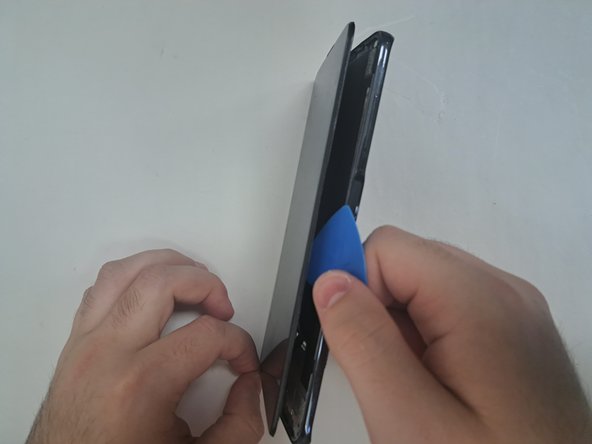

  3. Motorola Moto G Stylus (2021) Screen Replacement: crwdns2935265:03crwdnd2935265:01crwdnd2935265:02crwdne2935265:0 Motorola Moto G Stylus (2021) Screen Replacement: crwdns2935265:03crwdnd2935265:02crwdnd2935265:02crwdne2935265:0
    • Insert an opening tool into the seam between the rear case and chassis.
    • Once you create a gap, insert an opening pick a couple of millimeters into the gap.
    • Slide the opening pick around the entire perimeter to sever the adhesive that secures the rear case.
    • If you feel excessive resistance, reheat the problem area(s).
    • Remove the rear case.

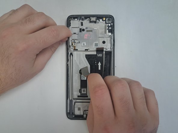

    • Use an opening tool to lift and disconnect the two antenna cables.
  18. Motorola Moto G Stylus (2021) Screen Replacement: crwdns2935265:018crwdnd2935265:01crwdnd2935265:02crwdne2935265:0 Motorola Moto G Stylus (2021) Screen Replacement: crwdns2935265:018crwdnd2935265:02crwdnd2935265:02crwdne2935265:0
    • Use an opening tool to lift and disconnect the press connector.
  19. Motorola Moto G Stylus (2021) Screen Replacement: crwdns2935265:019crwdnd2935265:01crwdnd2935265:02crwdne2935265:0 Motorola Moto G Stylus (2021) Screen Replacement: crwdns2935265:019crwdnd2935265:02crwdnd2935265:02crwdne2935265:0
    • Use a T4 Torx screwdriver to remove the 3 mm screw that secures the charging port.
  20. Motorola Moto G Stylus (2021) Screen Replacement: crwdns2935265:020crwdnd2935265:01crwdnd2935265:02crwdne2935265:0 Motorola Moto G Stylus (2021) Screen Replacement: crwdns2935265:020crwdnd2935265:02crwdnd2935265:02crwdne2935265:0
    • Carefully grab the charging port and slightly tilt it upwards.
    • This will allow it to be pulled outwards without bumping into the battery.
    • The cable might get in the way. If it does, carefully fold it upwards and out of the way. To prevent damaging it, do not force the cable to move in any direction. It should be able to be bent upwards with minimal force.

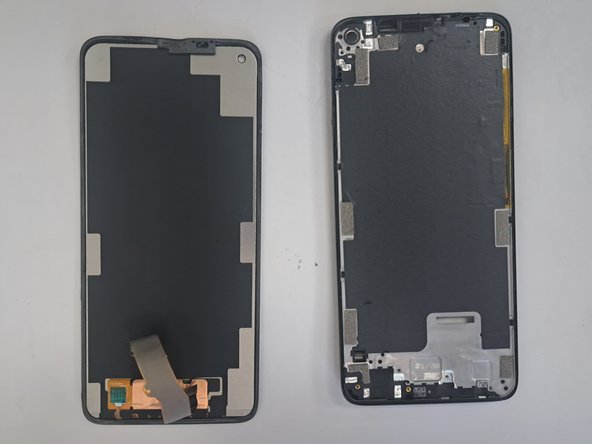

  21. Motorola Moto G Stylus (2021) Screen Replacement, Screen: crwdns2935265:021crwdnd2935265:01crwdnd2935265:02crwdne2935265:0 Motorola Moto G Stylus (2021) Screen Replacement, Screen: crwdns2935265:021crwdnd2935265:02crwdnd2935265:02crwdne2935265:0
    • Carefully peel up the cable attached to the screen from the mid case.
  22. Motorola Moto G Stylus (2021) Screen Replacement: crwdns2935265:022crwdnd2935265:01crwdnd2935265:02crwdne2935265:0 Motorola Moto G Stylus (2021) Screen Replacement: crwdns2935265:022crwdnd2935265:02crwdnd2935265:02crwdne2935265:0
    • Orient the phone so the screen faces up.
    • Use an iOpener or hairdryer to heat the screen until it's almost too hot to touch.
  23. Motorola Moto G Stylus (2021) Screen Replacement: crwdns2935265:023crwdnd2935265:01crwdnd2935265:02crwdne2935265:0 Motorola Moto G Stylus (2021) Screen Replacement: crwdns2935265:023crwdnd2935265:02crwdnd2935265:02crwdne2935265:0
    • Use a pick to sever the connection between the screen and mid case.
    • Do not run the pick along the top or bottom edges of the phone. There are delicate cables that are easy to sever.
  24. Motorola Moto G Stylus (2021) Screen Replacement: crwdns2935265:024crwdnd2935265:01crwdnd2935265:02crwdne2935265:0 Motorola Moto G Stylus (2021) Screen Replacement: crwdns2935265:024crwdnd2935265:02crwdnd2935265:02crwdne2935265:0
    • As the glue gets severed, carefully separate the screen from mid case.
    • Carefully pull the cable out of the mid case.
