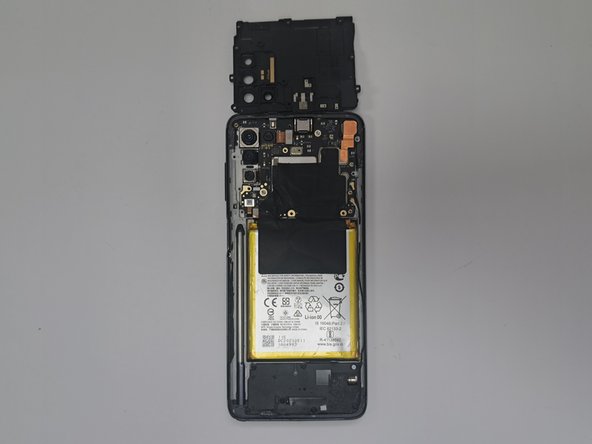

    • Lay the phone face down.
    • Heat an iOpener and apply it to the rear case.
    • Alternatively, use a hair dryer to heat the rear case until it's almost too hot to touch.
  3. Motorola Moto G Stylus (2021) Camera Replacement: crwdns2935265:03crwdnd2935265:01crwdnd2935265:02crwdne2935265:0 Motorola Moto G Stylus (2021) Camera Replacement: crwdns2935265:03crwdnd2935265:02crwdnd2935265:02crwdne2935265:0
    • Insert an opening tool into the seam between the rear case and chassis.
    • Once you create a gap, insert an opening pick a couple of millimeters into the gap.
    • Slide the opening pick around the entire perimeter to sever the adhesive that secures the rear case.
    • If you feel excessive resistance, reheat the problem area(s).
    • Remove the rear case.

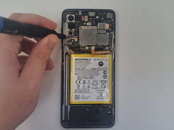

  4. Motorola Moto G Stylus (2021) Camera Replacement, Main Board: crwdns2935265:04crwdnd2935265:01crwdnd2935265:02crwdne2935265:0 Motorola Moto G Stylus (2021) Camera Replacement, Main Board: crwdns2935265:04crwdnd2935265:02crwdnd2935265:02crwdne2935265:0
    • Use an opening tool to lift and remove the midframe.
  5. Motorola Moto G Stylus (2021) Camera Replacement: crwdns2935265:05crwdnd2935265:01crwdnd2935265:01crwdne2935265:0
    • You may need to use your heating device again to remove glue from covering the screws.
    • Use a T4 Torx screwdriver to remove all eleven 3.2 mm screws securing the midframe.
  6. Motorola Moto G Stylus (2021) Camera Replacement: crwdns2935265:06crwdnd2935265:01crwdnd2935265:02crwdne2935265:0 Motorola Moto G Stylus (2021) Camera Replacement: crwdns2935265:06crwdnd2935265:02crwdnd2935265:02crwdne2935265:0
  7. Motorola Moto G Stylus (2021) Camera Replacement: crwdns2935265:07crwdnd2935265:01crwdnd2935265:01crwdne2935265:0
    • Remove the black tape covering the connectors.
    • Use an opening tool to lift and disconnect the four press connectors.
    • Use an opening tool to lift and disconnect the two antenna cables connectors.

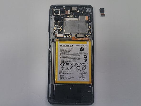

  8. Motorola Moto G Stylus (2021) Camera Replacement: crwdns2935265:08crwdnd2935265:01crwdnd2935265:02crwdne2935265:0 Motorola Moto G Stylus (2021) Camera Replacement: crwdns2935265:08crwdnd2935265:02crwdnd2935265:02crwdne2935265:0
    • Use an opening tool to lift and disconnector the front camera press connector.
    • Remove the front camera.

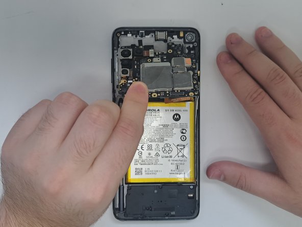

  9. Motorola Moto G Stylus (2021) Camera Replacement: crwdns2935265:09crwdnd2935265:01crwdnd2935265:02crwdne2935265:0 Motorola Moto G Stylus (2021) Camera Replacement: crwdns2935265:09crwdnd2935265:02crwdnd2935265:02crwdne2935265:0
    • Use a T4 Torx screwdriver to remove the two 3 mm screws securing the main board.

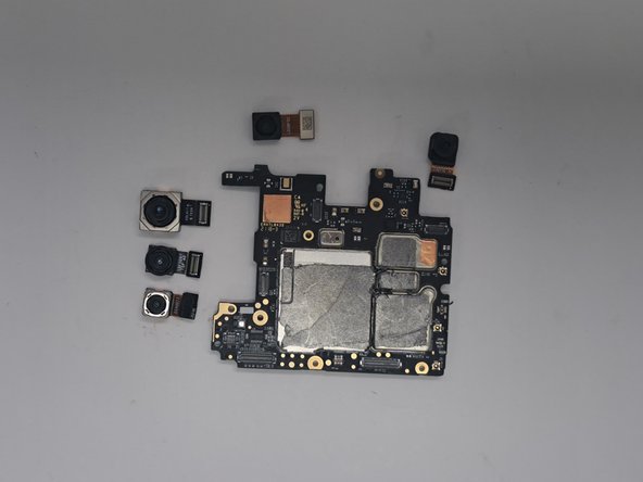

  11. Motorola Moto G Stylus (2021) Camera Replacement, Camera: crwdns2935265:011crwdnd2935265:01crwdnd2935265:02crwdne2935265:0 Motorola Moto G Stylus (2021) Camera Replacement, Camera: crwdns2935265:011crwdnd2935265:02crwdnd2935265:02crwdne2935265:0
    • From this point, you do not need to remove all of the cameras. Skip to the step that addresses your camera and follow that step as the last step. From there you can replace that specific camera and follow the instructions in reverse to put your phone back together
  12. Motorola Moto G Stylus (2021) Camera Replacement: crwdns2935265:012crwdnd2935265:01crwdnd2935265:01crwdne2935265:0
    • Disconnect camera 1 from the main board using an opening tool.
  13. Motorola Moto G Stylus (2021) Camera Replacement: crwdns2935265:013crwdnd2935265:01crwdnd2935265:01crwdne2935265:0
    • Disconnect camera 4 from the main board using an opening tool.

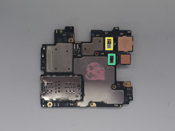

  14. Motorola Moto G Stylus (2021) Camera Replacement: crwdns2935265:014crwdnd2935265:01crwdnd2935265:01crwdne2935265:0
    • Orient the main board so the back is facing up.
    • Disconnect camera 2 from the main board using an opening tool.
  15. Motorola Moto G Stylus (2021) Camera Replacement: crwdns2935265:015crwdnd2935265:01crwdnd2935265:01crwdne2935265:0
    • Disconnect camera 3 from the main board using an opening tool.
  16. Motorola Moto G Stylus (2021) Camera Replacement: crwdns2935265:016crwdnd2935265:01crwdnd2935265:02crwdne2935265:0 Motorola Moto G Stylus (2021) Camera Replacement: crwdns2935265:016crwdnd2935265:02crwdnd2935265:02crwdne2935265:0
    • Insert replacement cameras by following the instructions to remove it in inverse
